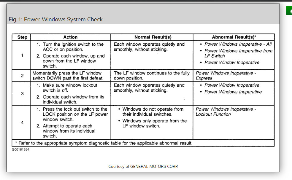

just bought this car. Tried all windows form the drivers seat and they all worked perfectly. When I picked up my wife she couldn't get the passenger window down. Got home and tried them all. None of the windows will work from their respective door switches, but they all work from the drivers door. Is there a fuse to the door lock switch on the drivers door? Thank you.
Aug 5, 2019 at 2:41 PM
SCGRANTURISMO
  • 4,897 POSTS

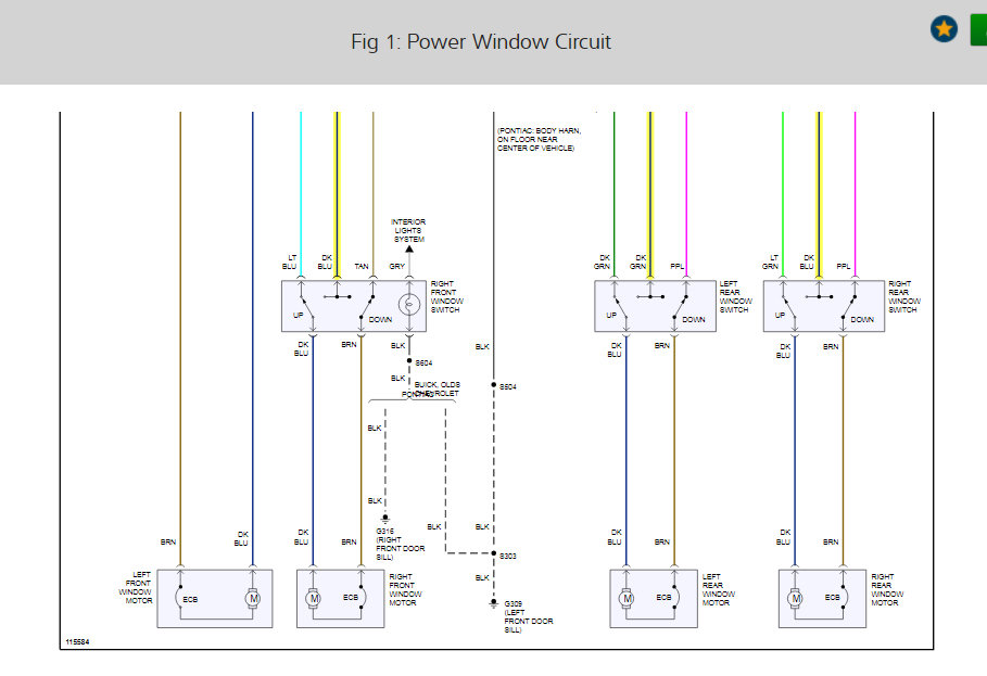

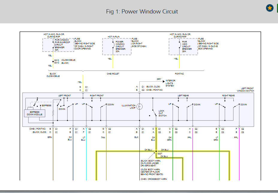

The Power Window Lockout Switch in probably engaged. Locate this switch on the Master Window Switch on the left front power window switch and disengage it. I have included the Power Window Circuit Wiring Diagram and Power Window Operation Chart for your reference in the diagrams down below for your reference. Please get back to us with how everything turns out.
