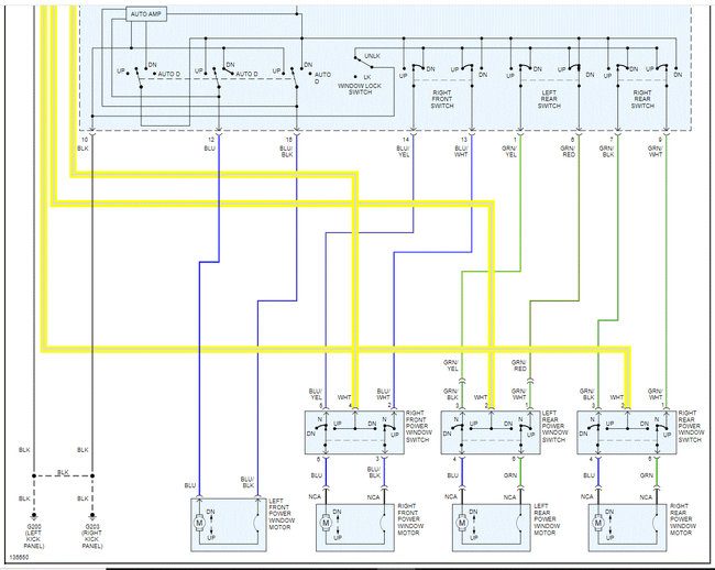

I have no power to any windows from any window. Have checked relay, fuses. What I need to know is the color of the wire that supplies power to the main switch of drivers door. (Harness between body and door)
Sep 5, 2021 at 4:36 AM
  • 110,248 POSTS

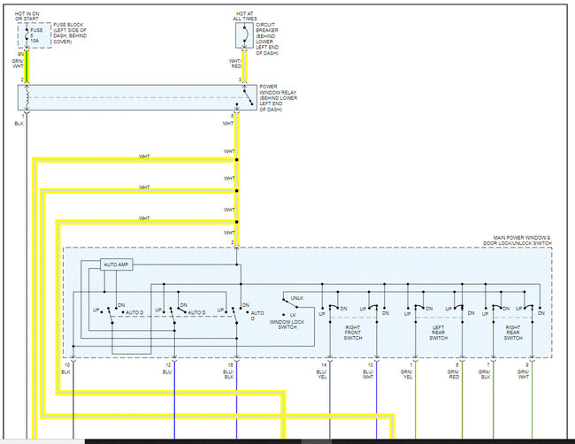

I attached the entire wiring schematic below for you to review. At the window switch, there should be a white wire. Check that for power. It comes from the window relay. Also, note that power is from a circuit breaker.
The actual wiring schematic is one page long. I had to cut it in half to make it readable for you. I did overlap the two so you can follow from one to the next.

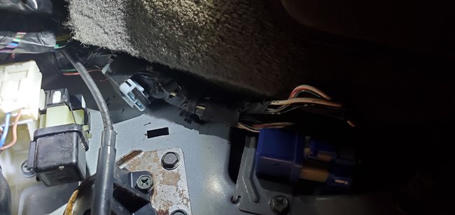

Need to know which one of these is the circuit breaker to the power widows. I see two of them here; a black, and a blue. That's the hood latch in between the two. Do you know which is for power windows?
Sep 27, 2021 at 5:11 AM
SHAYNSHAWN
Also my photo is turned, so the black one is top, blue is bottom.

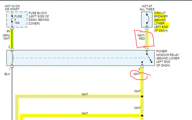

I just looked at the schematic again. Power from the circuit breaker is provided via a white wire with a red tracer to the power window relay. From there, it is a white wire.
See attached.
