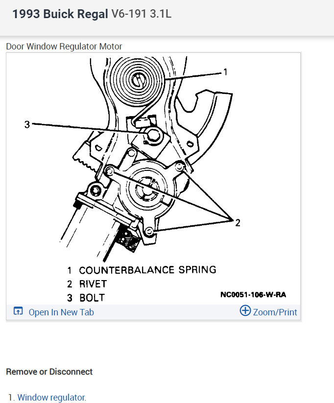

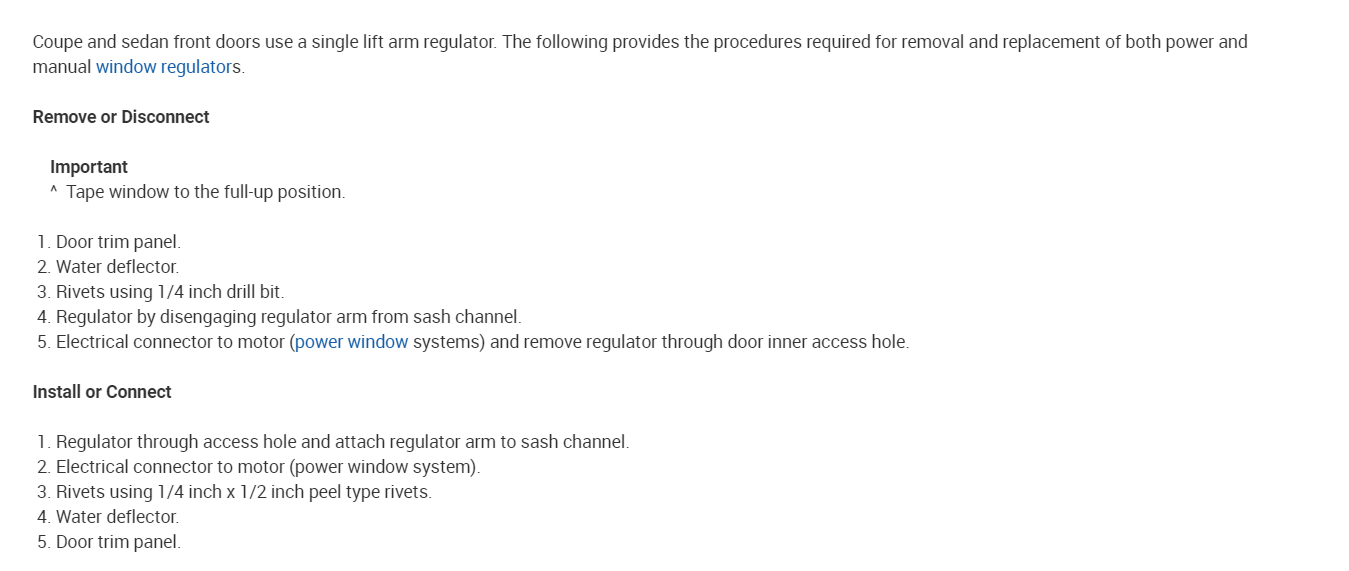

Sure here is how to change the window regular out.
Remove or Disconnect
1. Window regulator.
CAUTION: Step 2 must be performed once regulator is removed from door. The regulator lift arm is under tension from the counterbalance spring and can cause personal injury if the motor is removed without locking the sector gear in position.
2. Drill hole through regulator sector gear and backplate.
Important
^ Do not drill hole closer than 13 mm (1/2 inch) to edge of sector gear or backplate.
3. Install bolt and nut to lock sector gear in position.
4. Drill out ends of three rivets using 1/4 inch drill bit.
5. Motor and remaining portions of rivets.
Install or Connect
1. New motor to backplate.
2. Rivet to motor at bottom location using ball peen hammer.
3. Clamp motor to backplate using locking pliers.
4. Remove bolt and nut securing sector gear.
5. Supply power to regulator to gain access for remaining two motor rivets.
6. Two rivets.
7. Remove locking pliers.
8. Window regulator.

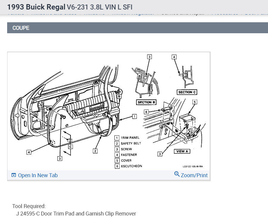

Check out the images below.

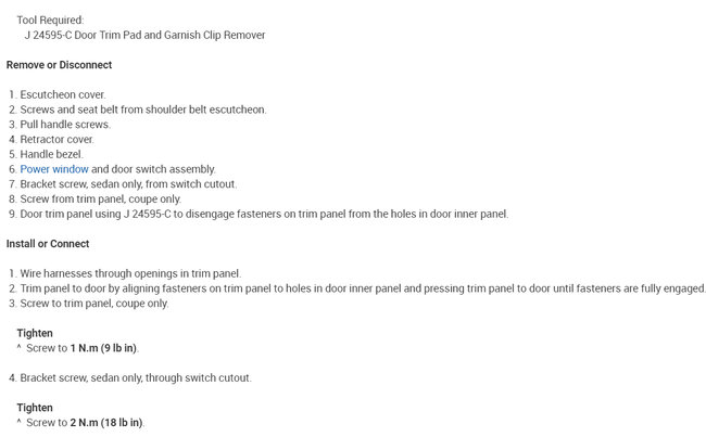

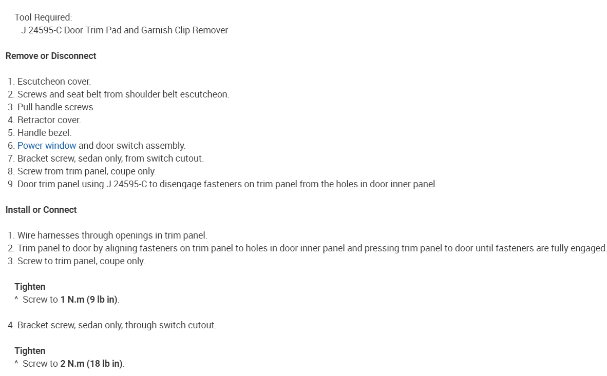

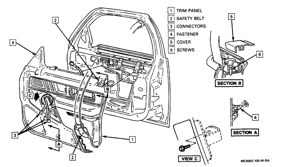

Sure, here is what we have to do the job. Check out the images (below). Let us know what happens and please upload pictures or videos of the problem so we can see what's going on.

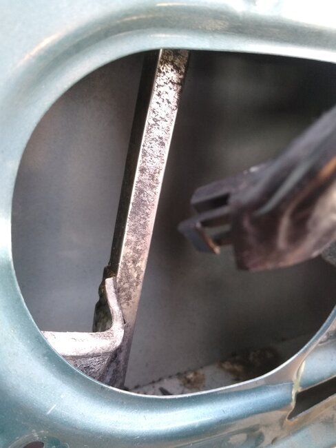

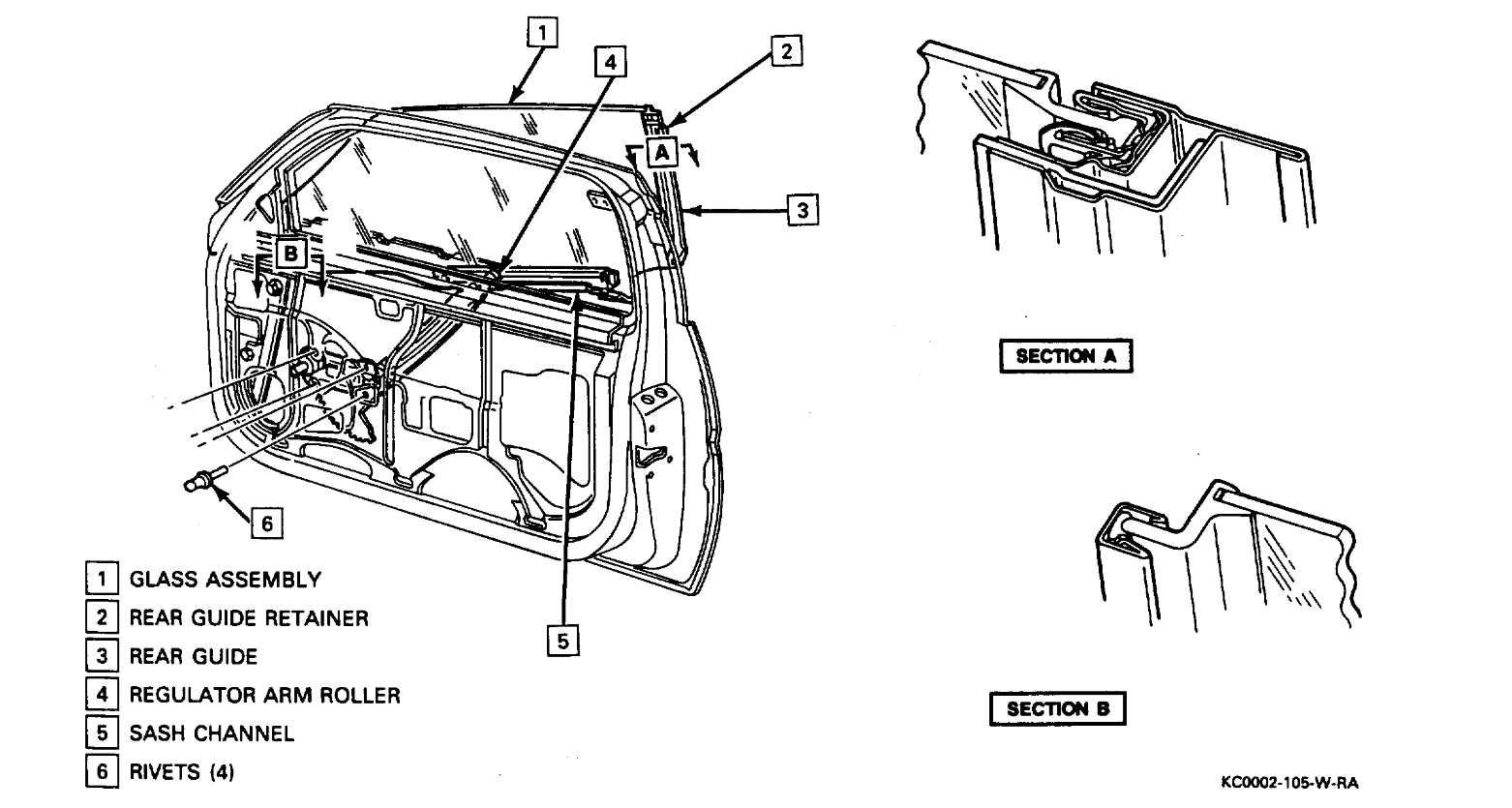

Can you tell me the part that goes here the clamps to the window? This is what's broken. The motors working fine the window is going up and down just sideways. Thanks
May 21, 2023 at 7:50 AM
  • 55,273 POSTS
It looks like the window rail mount has broken off. It should be down in the door so you can get a replacement at the auto part store.

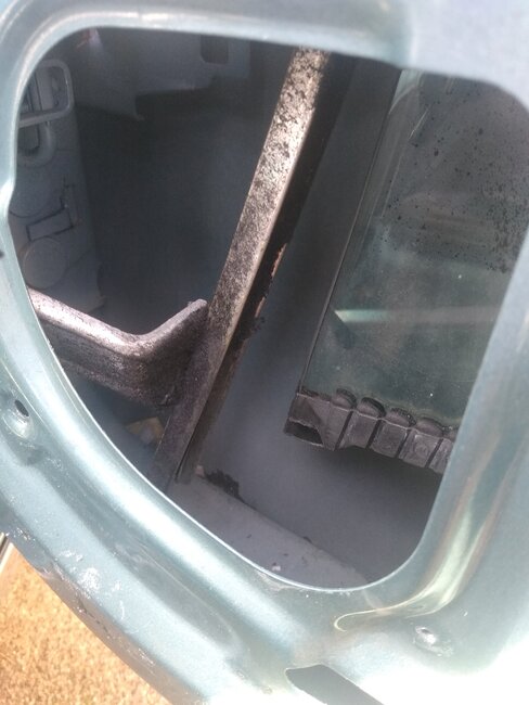

Seems like a really weird setup. There's a channel on the left-hand side of the door where the window rides up and down on but don't see one on the right. Only the regulator that runs on the track that makes the window go up and down.

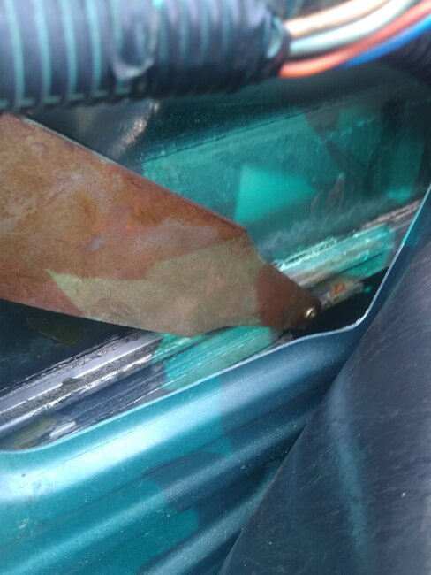

Even pushing window into left side track, it still seems like there's too much play where the regulator hooks to the window. That's why I thought there may have been a wheel or plastic attachment that may have been missing there.

Does the windows have felt in the guides? Also, there is a bottom mounting bolts that can secure the guide I would make sure that was not missing.

Not much felt left in the guide. Only two bolts hold on the lower window channel. The plastic piece looks like it's glued to the window on the bottom left. There is a small piece of it missing. The channel is adjusted over to the right as far as it can be.
May 25, 2023 at 4:27 AM
BW74
  • 50 POSTS
Do you know what the technical term is for that black plastic piece that needs replaced on the window?

  • 110,240 POSTS

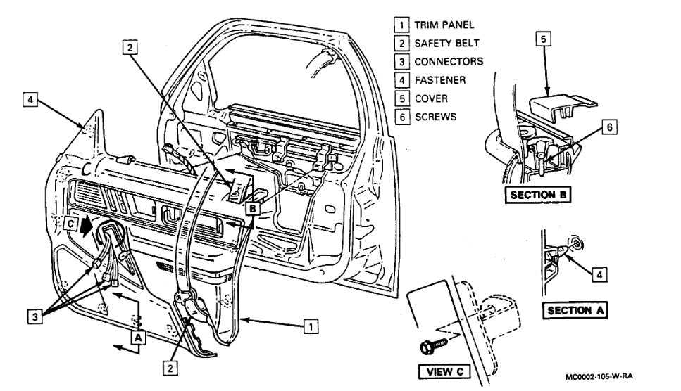

That has to be frustrating. Have you tried glass repair shops? Also, I attached a pic below. Do you see the part you are needing?
See pic below.
May 31, 2023 at 1:32 PM
BW74
  • 50 POSTS
That window channel bar and that black plastic piece on the bottom left of the window is what I need.
May 31, 2023 at 10:59 PM
  • 110,240 POSTS
I see it. I feel the only place you will find one is a salvage yard. Here is a link that checks nationwide for salvage parts. You may want to try this.
