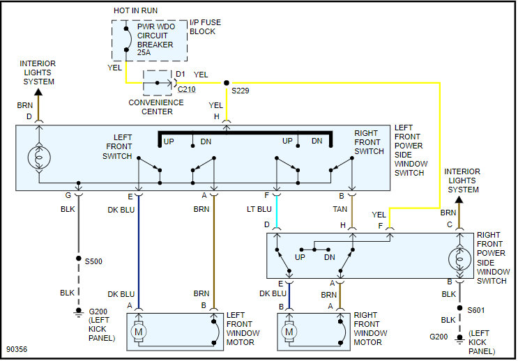

Power window fuse panel diagram needed
1997 GMC VANDURA
97,000 MILES
KEITHWADE30135
Power window relay, gets hot. Windows will not roll down. Is there a separate fuse besides the 30 amp relay?

Here is the power window wiring diagram you requested.The relay getting hot leads me to believe you have a possible wiring short to ground.Here is a wiring test tutorial for you to view:
I've attached the picture below.Hope this helps and thanks for using 2CarPros.
