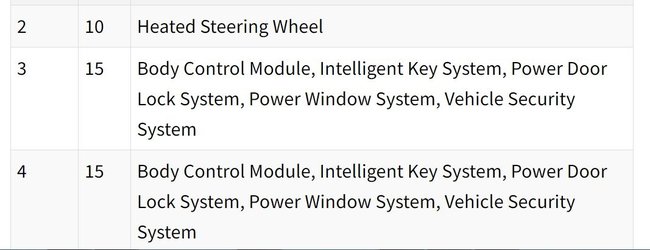

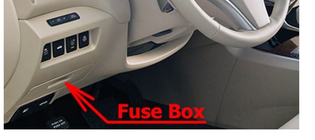

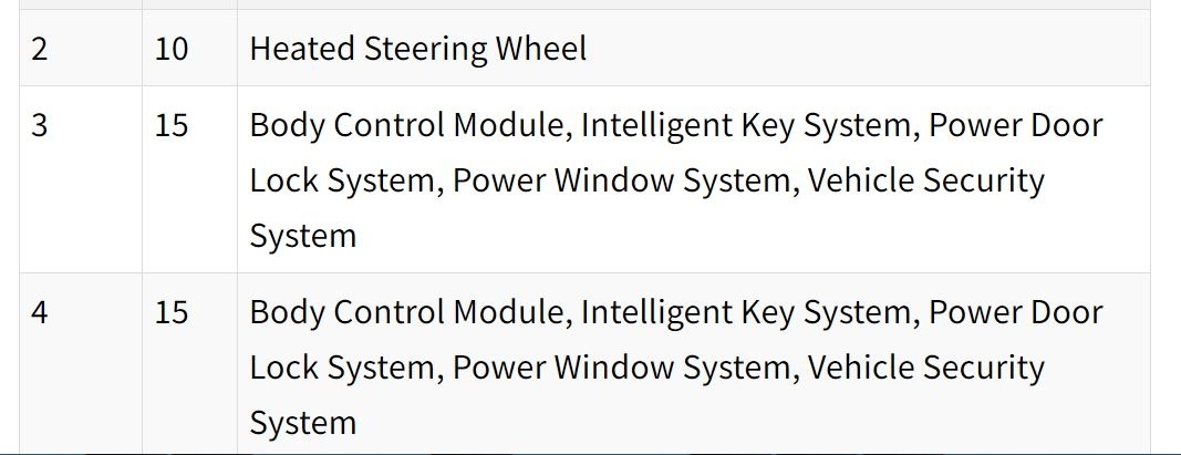

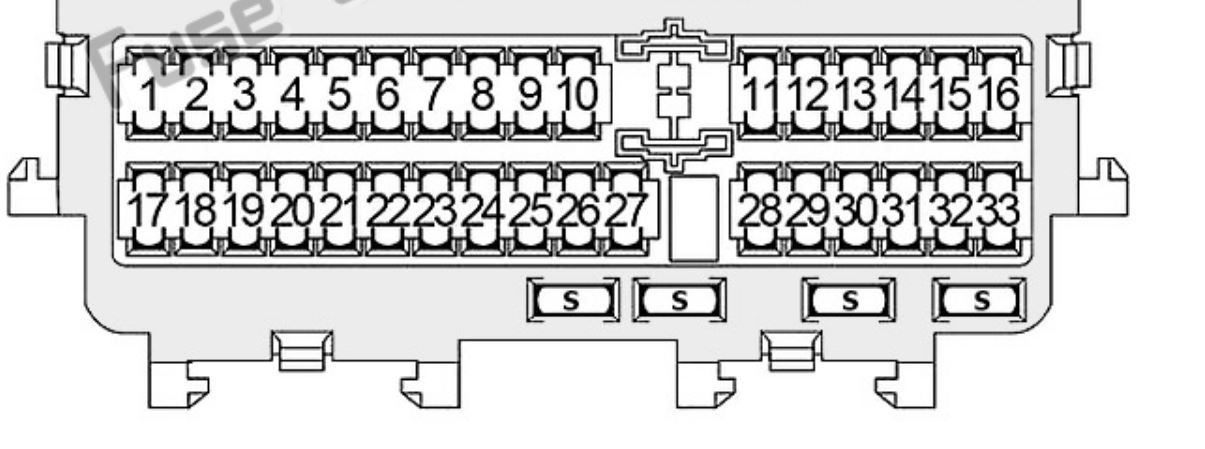

Where is the fuse for power window?
My widow motor sometimes works and stops.
Help please?
Dec 20, 2020 at 3:27 AM
KENW1
  • 213 POSTS
It's fuse 3 in the interior fuse box located left of the steering wheel. I'll post photos and diagrams below for you. If it's working intermittently it may be a bad motor or switch.
