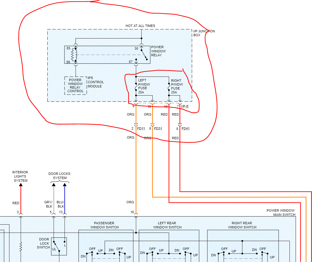

Today all 4 windows and all switches are not working all of a sudden.
Jul 17, 2020 at 12:45 PM
  • 110,240 POSTS

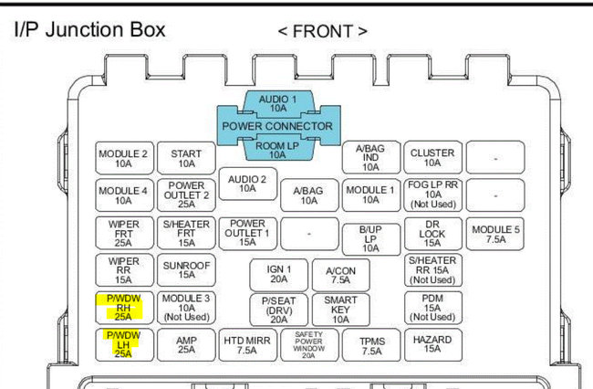

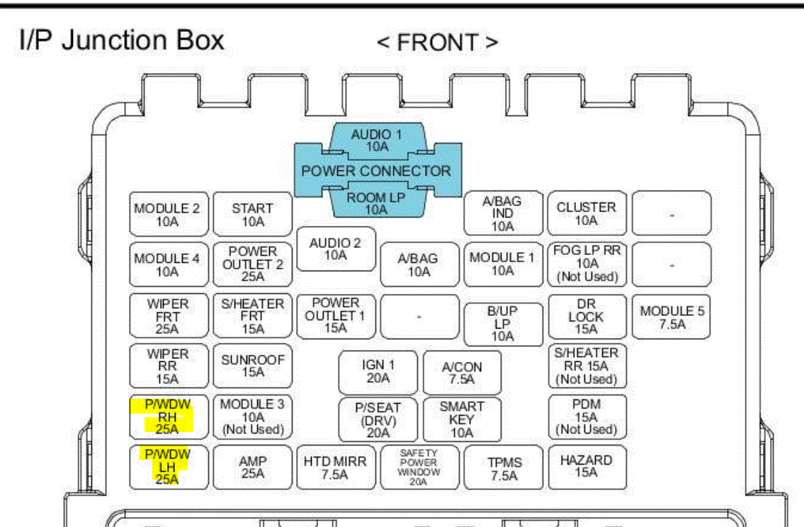

If power was lost to all windows, it sounds like the power window relay has failed. It could be a fuse as well. Take a look at the attached picture I attached. That is the instrument cluster fuse box. I need you to check the two fuses I circled. Also, remove the relay and switch it with another one that has the same part number to see if it makes a difference.
If you look at pic 2, I included a pic of the instrument panel fuse box and highlighted the components needing checked.
