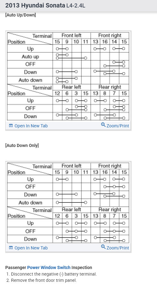

All my windows work except the driver's window. The button seems to be broken. Do I just need to change the button?
Mar 18, 2022 at 7:26 PM
SQM
  • 6,383 POSTS

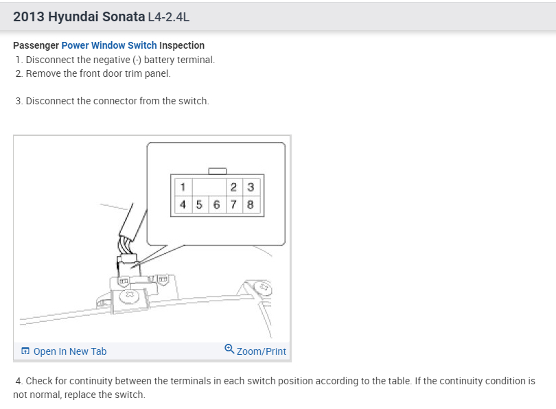

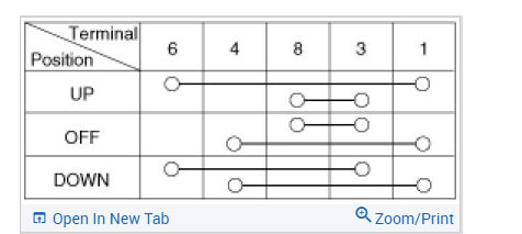

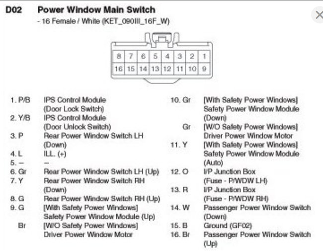

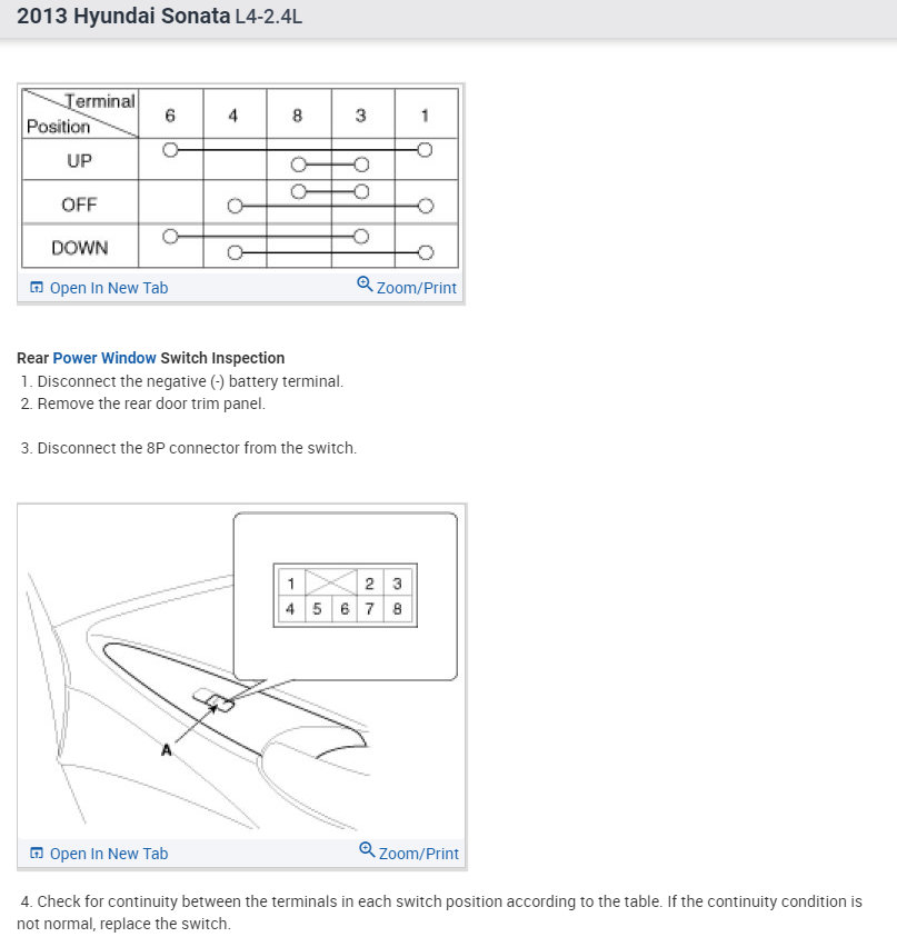

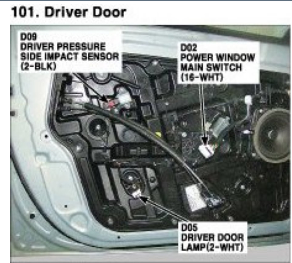

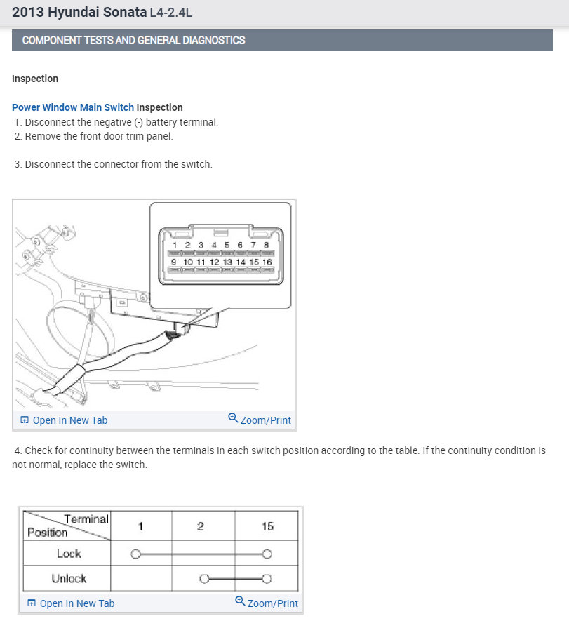

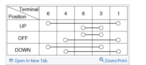

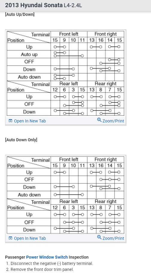

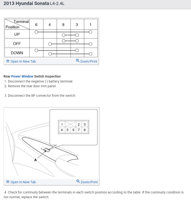

It is possible for the switch to be bad or have a loose connection.
First you want to make sure that it is the button and not a wiring issue.
You will need to check to see if there is power to the switch.
Here is a helpful guide on how to test the window switch:
https://www.2carpros.com/articles/electric-window-repair
I have attached diagrams showing how to test the switch for your reference.
