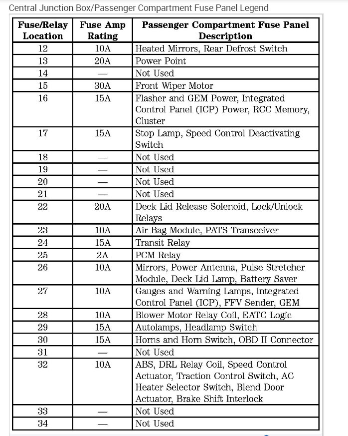

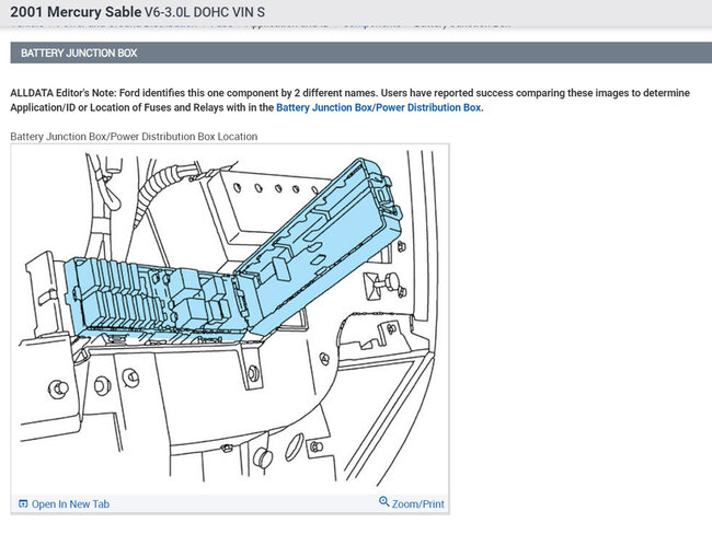

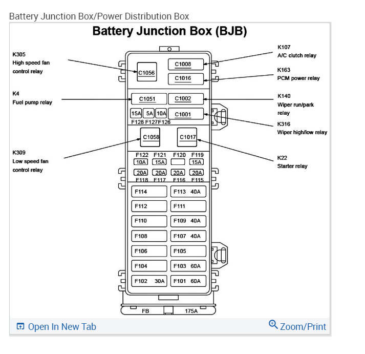

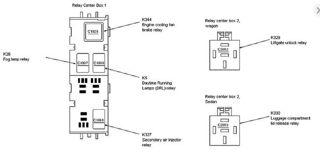

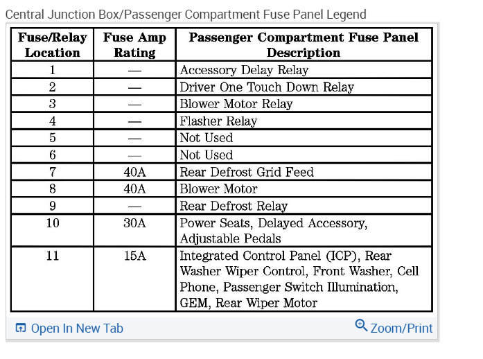

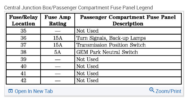

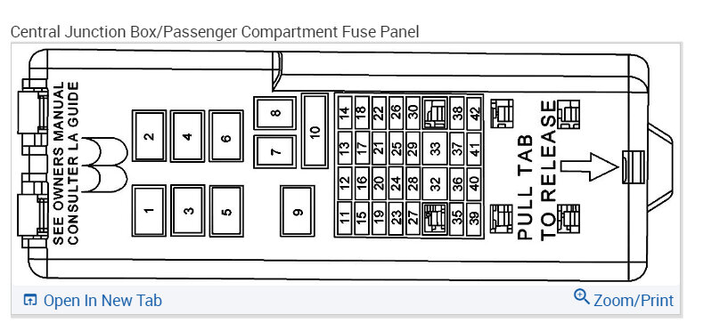

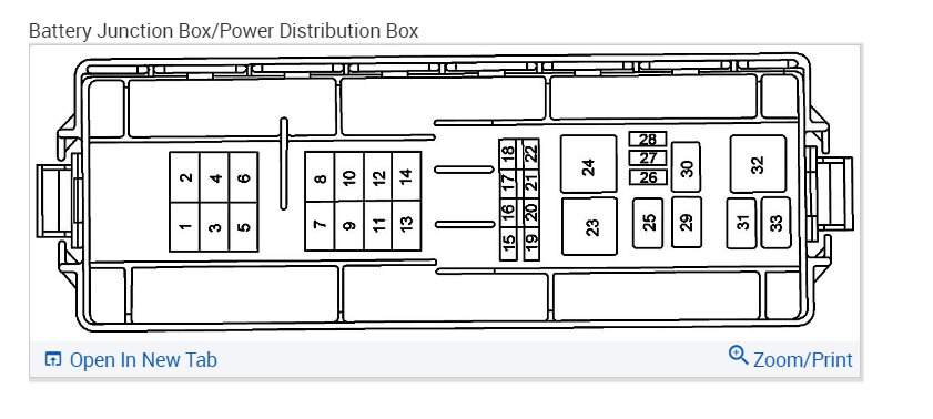

Someone started taking out fuses and relays. Now windows or inside lights or sunroof do not work. Where are the fuses and relay?
Jul 22, 2023 at 4:12 AM
Experienced Mechanic
55,604 POSTS
the fuses and relays are located in two primary fuse boxes: one inside the passenger compartment and another in the engine compartment.
Jul 22, 2023 at 9:42 AM
JRRIDDLER
MEMBER
1 POST

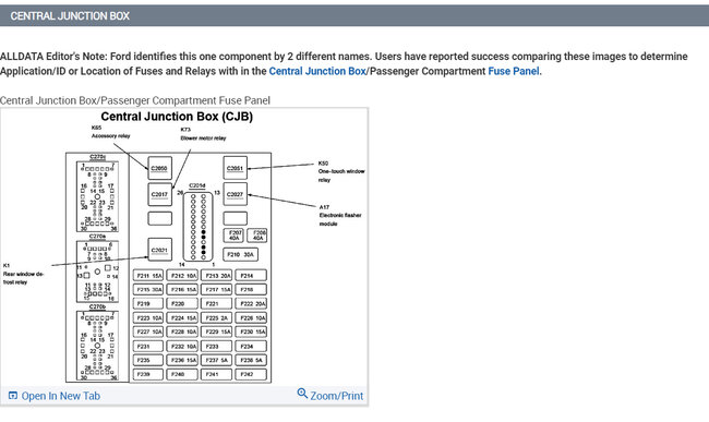

I've replaced all fuses , is what relay is it, and what box is it in.
Jul 23, 2023 at 6:20 AM
55,604 POSTS
Gotcha, here is the fuse box and relay locations so you can reinstall the fuses and relays.
