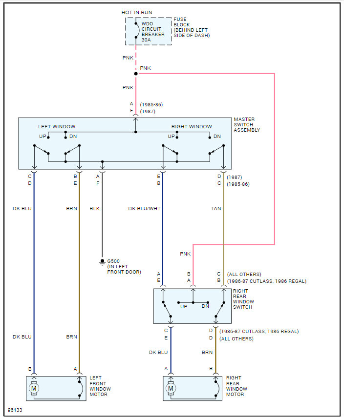

I just need to know the wiring schematic for the power window switch driver and passenger side, please. thank you

Sure, here are the wiring diagrams for the windows as you have requested, also I have included a guide to help you test the connections.
Check out the images (below). Let us know if you need anything else.
