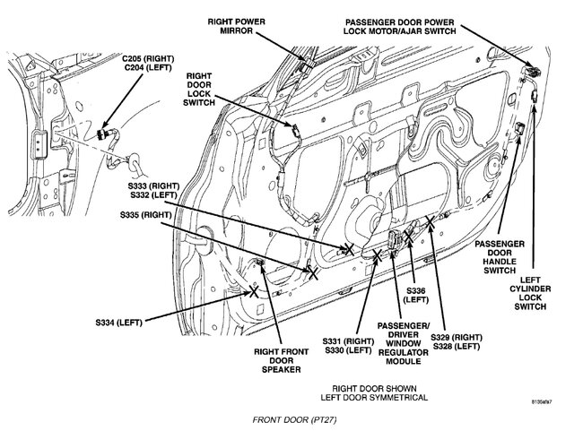

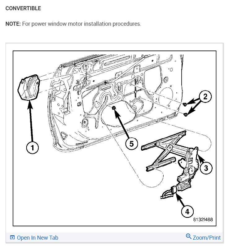

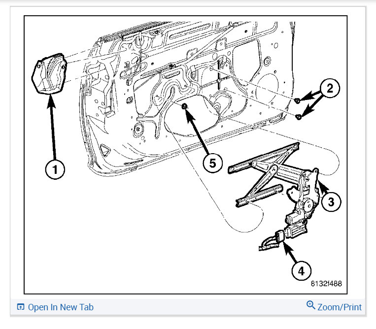

So, most of the time the window motor on the driver's side front will go out causing too many amps to be pulled through the switch. You might be able to feel the window motor and if it is warm or hot it is bad. Check out the images (below). Let us know what happens and please upload pictures or videos of the problem so we can see what's going on.
