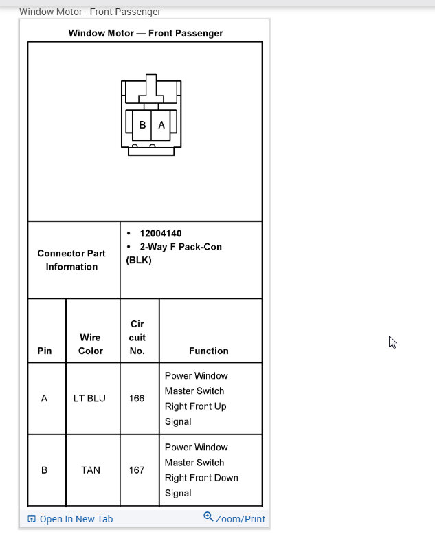

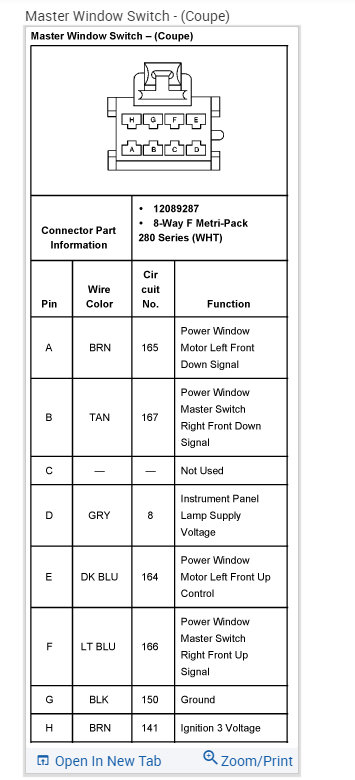

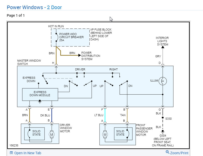

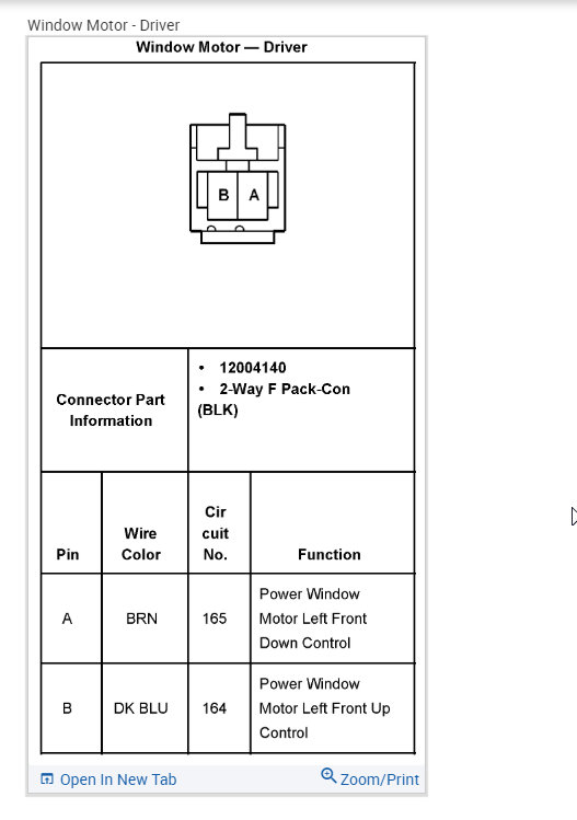

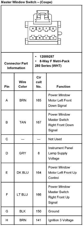

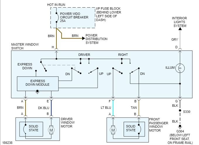

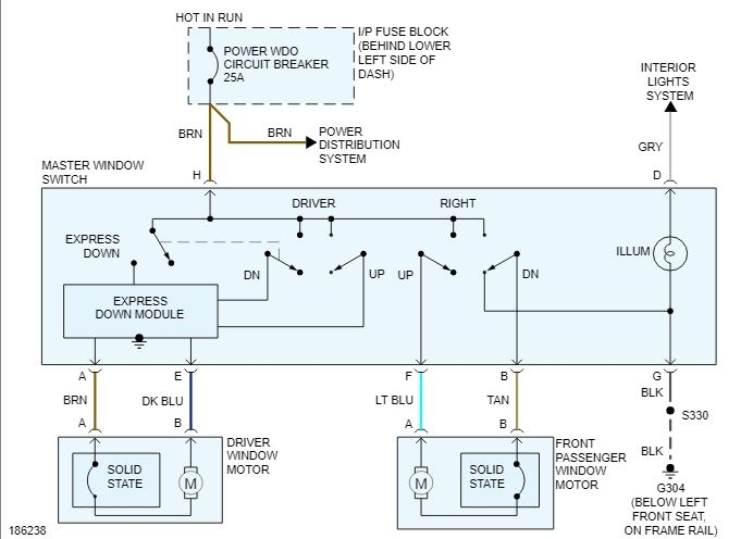

2 door center console mounted window switch. I need to know which wires go to which pins.

This is the schematic of the windows and the layout of the connector on the switch.

I attached all the info on this vehicle. Let me know if you need more info. Thanks for using 2CarPros.
