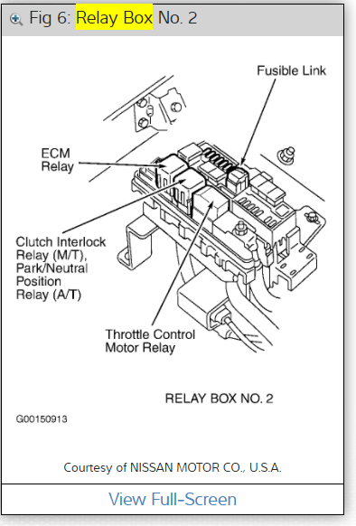

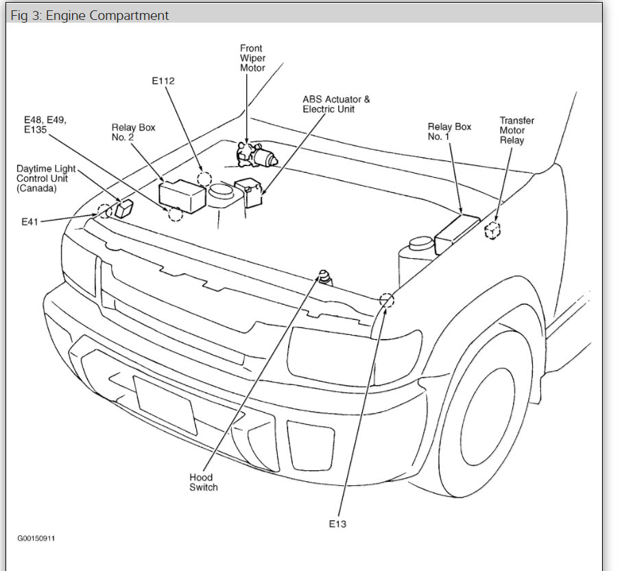

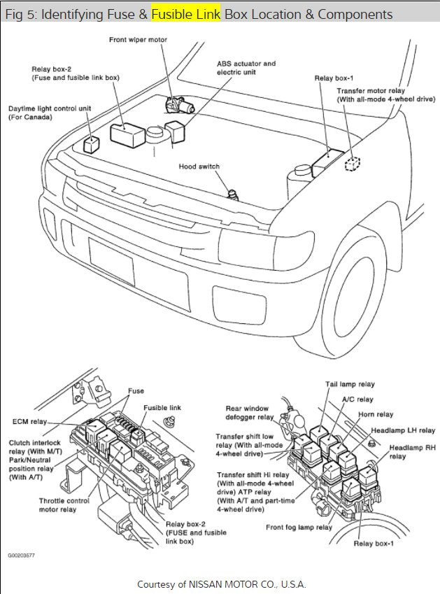

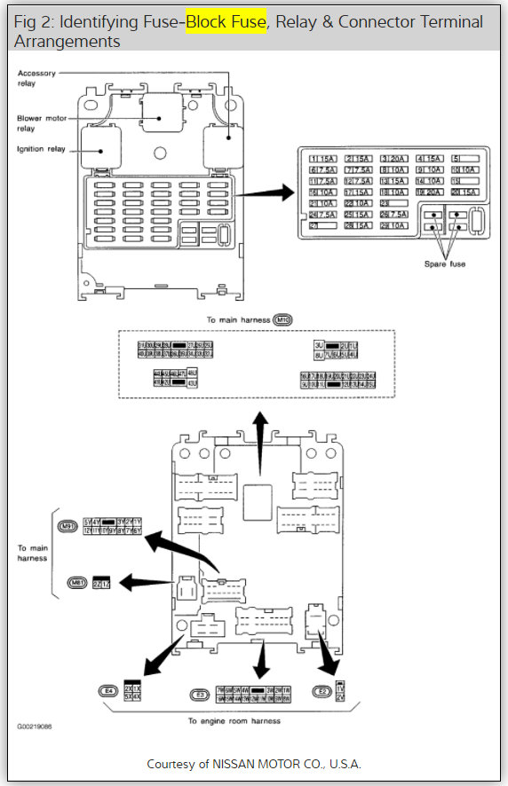

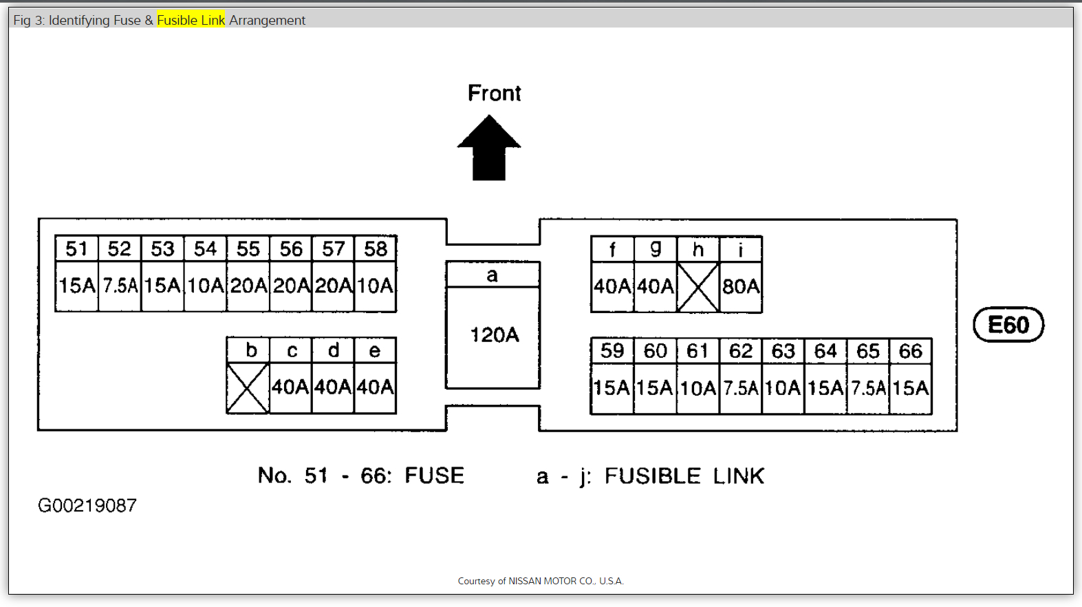

All the other windows and locks work. there is a 40 amp fuse under the hood on the right side for the windows, it's good . I cannot find no other fuses. Is there any fusible links?
Jan 26, 2020 at 10:20 AM
SCGRANTURISMO
  • 4,897 POSTS

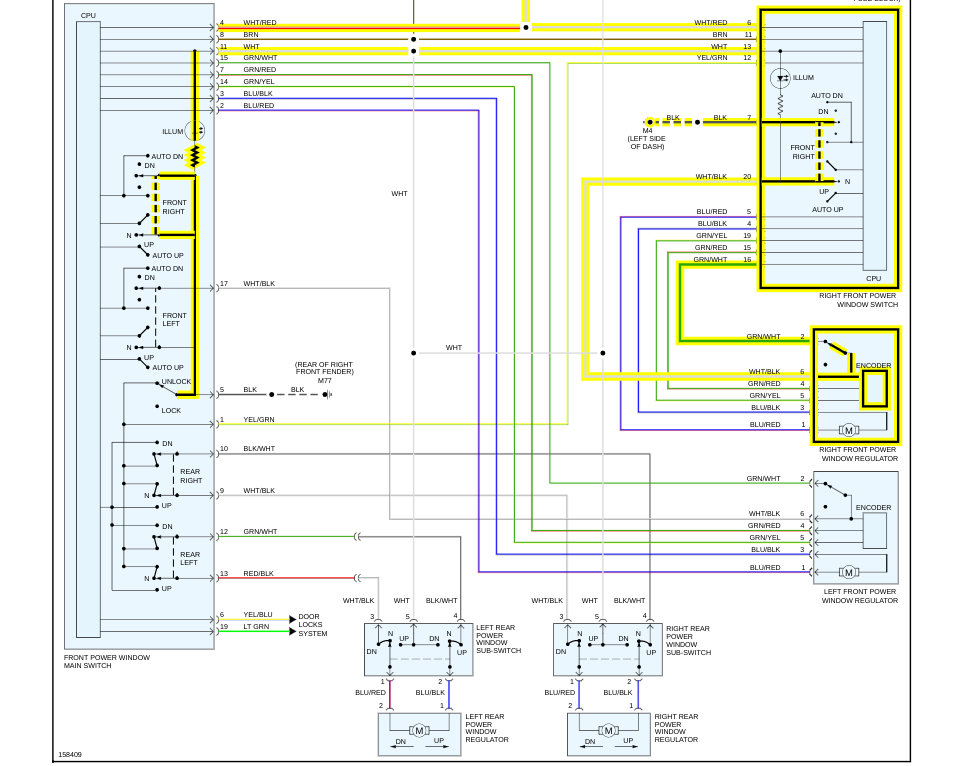

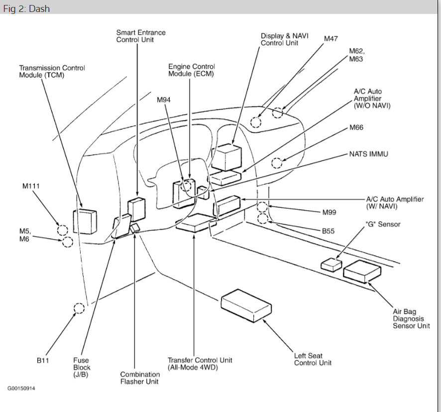

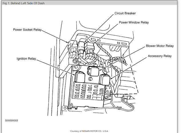

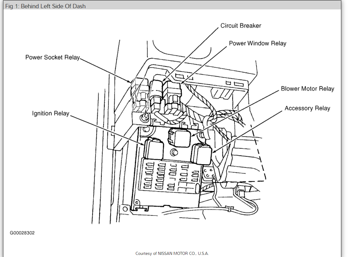

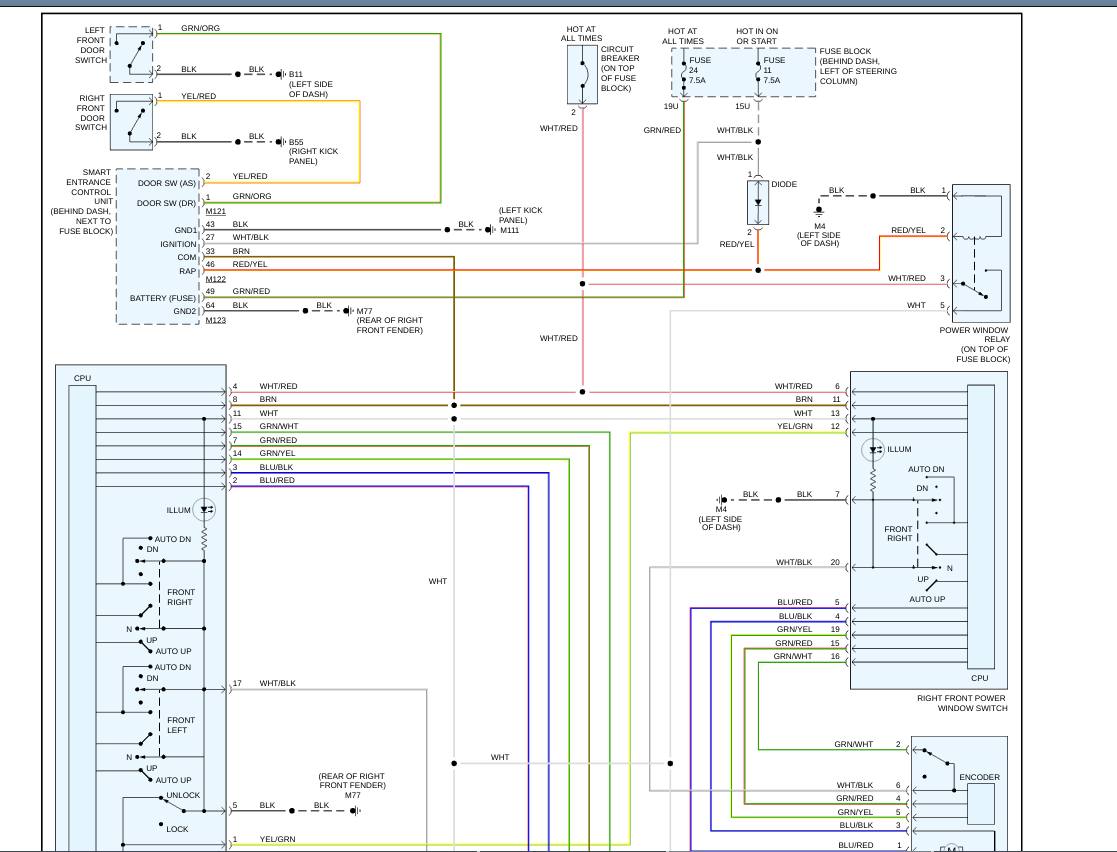

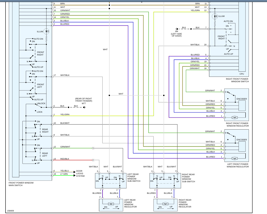

This could be just a bad switch. In the diagrams down below I have included the wiring diagrams for the power windows in your vehicle, a description of how the circuit operates and a guide to show you how to check the fuses
Jan 26, 2020 at 6:03 PM
TOUGHDIVER
  • 226 POSTS

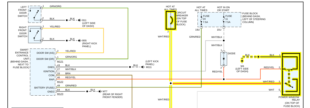

The power window switches and motor regulators are not isolated from each other that 40 amp power window breaker and relay powers all 4 windows. It could be a faulty window switch or power motor regulator. I'm attaching wiring diagrams for the power window circuit. I highlighted the circuit from the breaker to the relay to the switch and motor. Check for 12 volts in and out of the switch to determined witch part is faulty. I'm also attaching repair guides on electrical systems for your reference. Let us if you need additional information and what fixed it.
