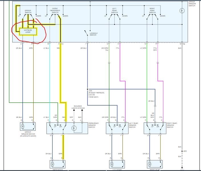

Passenger side power window will go down but not up using either the driver's master switch or the passenger switch. Window will go up and down if I connect the motor directly to the battery. Replaced the passenger door switch with new one. Still won't go up with the new switch.
If motor and switch are both good, what else could cause the window to go down but not up?

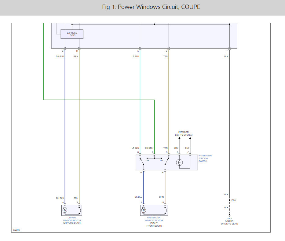

Good afternoon,
I attached a wiring diagram for you.
Do you have a test light or voltmeter to do some checks?

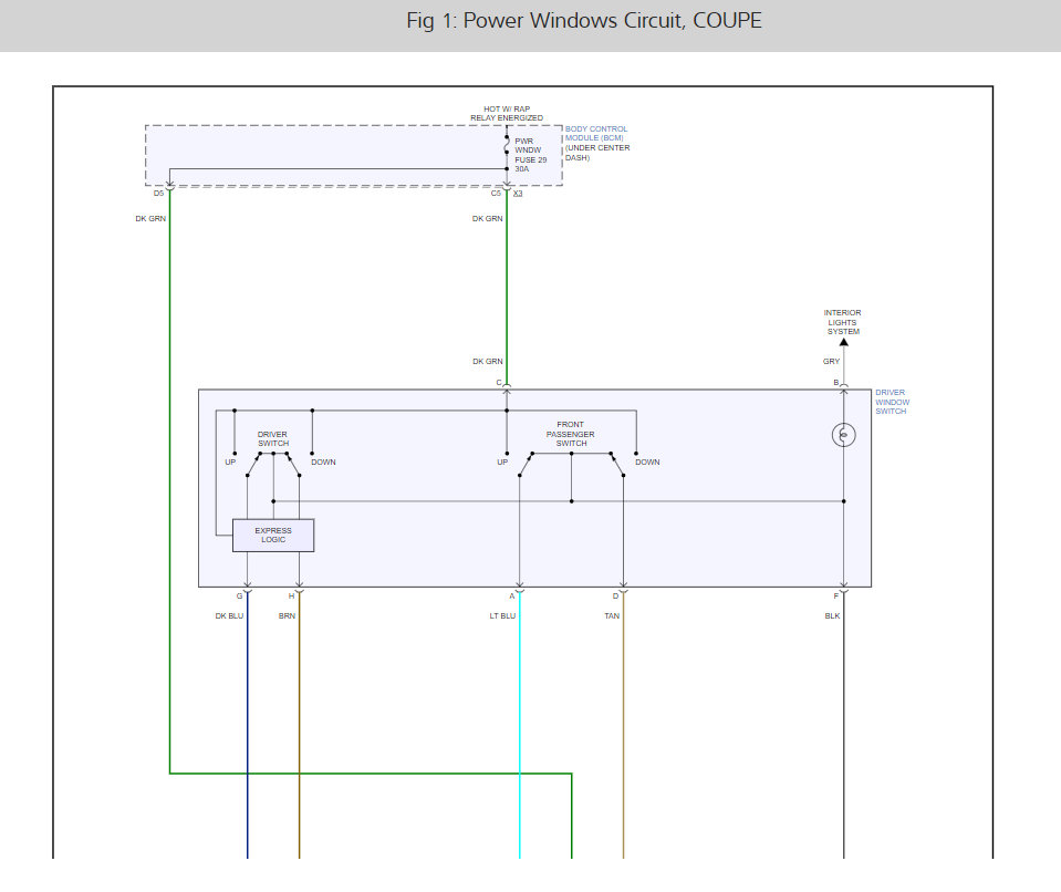

Okay, when you command up does the tan wire have power?
If it does, it is not being grounded by the master switch. That would indicate a bad master switch.

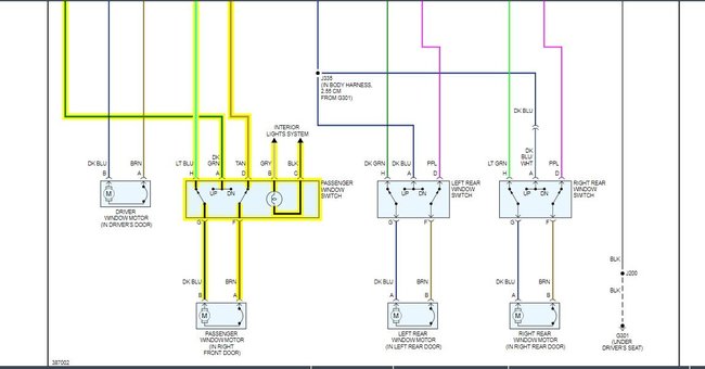

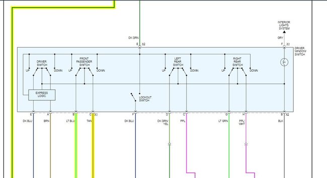

Okay, when you command up, the dark blue wire is hot and the brown is a ground. That brown goes through the switch and turns into the gray wire which goes to the master switch and inside the switch is the solid state set up that spins the motor in the correct rotation based on the command.
I attached that diagram.
Aug 26, 2020 at 7:41 AM
DJMARSOLEK
  • 21 POSTS
So I activated the driver's door switch up (and down) and there is no power at the tan wire that goes into the passenger door switch. I tried the same thing with the light blue wire on the passenger door switch connector. There light blue wire gets power with the driver's door switch pulled up, but not when the switch is pushed down. Is the driver,s door switch the problem? Thanks
Aug 26, 2020 at 8:50 AM
Yes, based on those tests, yes, I agree.

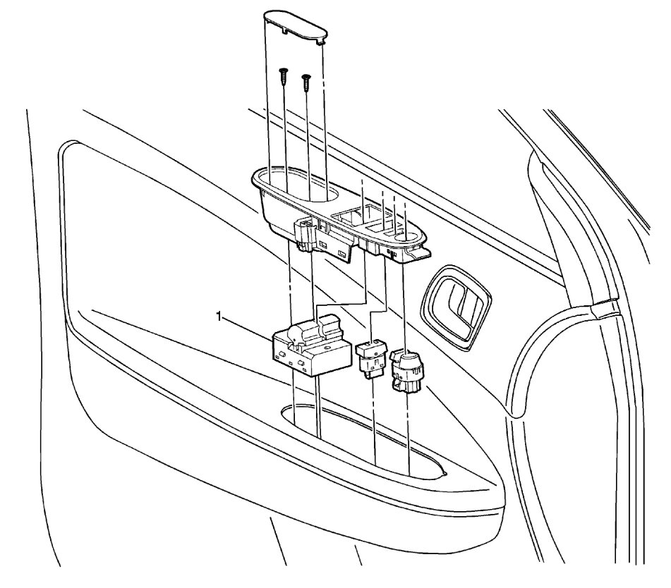

Ok so this was a super helpful thread! As a female a lot I can’t do on my own but I am having the exact same issue! I can’t test it myself I don’t have a meter or anything but every video I have watched points to master switch. Drivers side works fine but passenger only goes down with either switch ( master or using passenger switch) However it won’t go back up. So now it’s stuck 1/3 of the way down. Anyway, that was my burning question before I ordered a new switch. So even if both sides work going down and not up that the problem still lies in the master switch
Nov 6, 2024 at 12:13 PM
  • 55,549 POSTS
Yes, that is completely possible because the main power for the system comes from the main switch. Here is how to change the main window switch out. Check out the images (below). Let us know if you need anything else.
