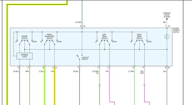

Good afternoon,
I attached a wiring diagram for you.
Do you have a test light or voltmeter to do some checks?

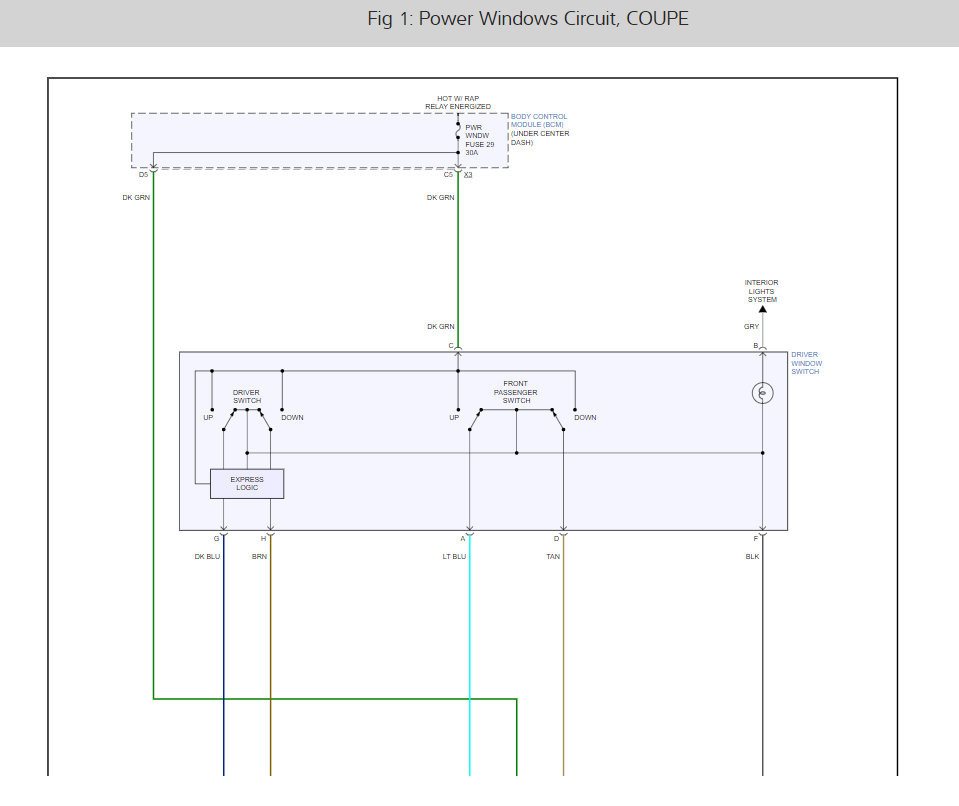

When commanding the window up, check the dark blue wire at the switch for power with a test light.
Aug 23, 2020 at 7:42 AM
DJMARSOLEK
  • 21 POSTS
With the driver's door master switch in the up position for the passenger's window, the light blue wire lights up. Not the dark blue wire. None of the wire's light up (except the power wire) when I have the drivers door master switch down for the passenger window. This makes no sense because I can use either the master switch or the passenger switch to get the window down, but neither switch will work to get the window up.
Aug 23, 2020 at 8:12 AM
Does the dark green wire at the passenger switch have power with the key on?
Aug 23, 2020 at 8:19 AM
DJMARSOLEK
  • 21 POSTS
Yes.
Aug 23, 2020 at 8:22 AM
When you command up with the passenger switch, the dark green should power the dark blue.

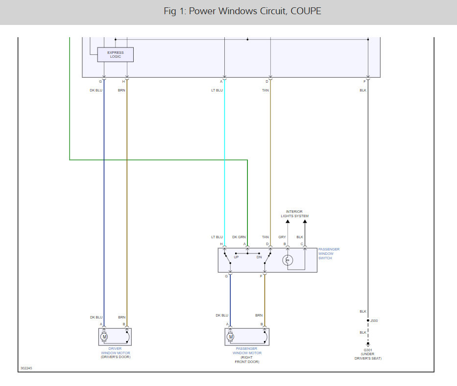

We can test this simply, remove the wiring connector from the motor dark blue and brown wires, then attach a test light between the two. Work the switch both directions does the test light light up in both directions? If so the motor is bad even though it runs on the direct battery I have seen them stop when installed.
Aug 25, 2020 at 9:17 AM
DJMARSOLEK
  • 21 POSTS
Hi Ken, thanks for reaching out. I did as you directed. The test light only goes on when I push the passenger door window switch down. It stays off when I pull that switch up. It also stays off I move the drivers door master switch up or down. This baffles me because that switch still lowers the window.
Aug 26, 2020 at 5:51 AM

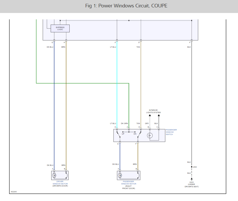

Okay, when you command up does the tan wire have power?
If it does, it is not being grounded by the master switch. That would indicate a bad master switch.
Aug 26, 2020 at 6:05 AM

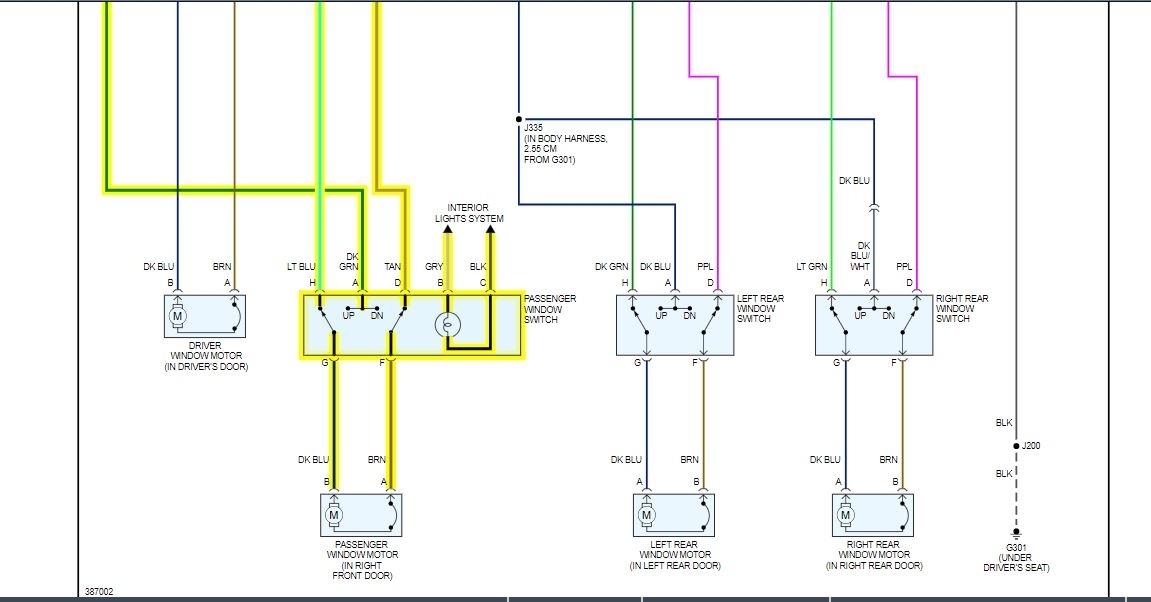

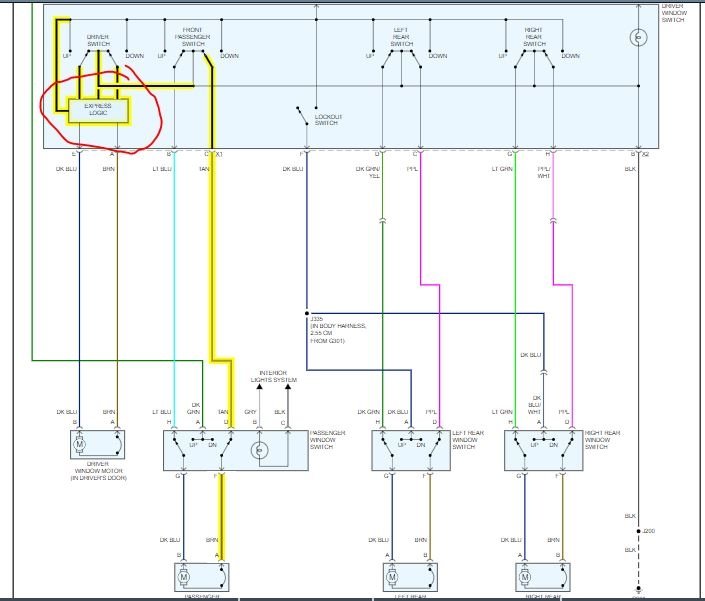

Okay, when you command up, the dark blue wire is hot and the brown is a ground. That brown goes through the switch and turns into the gray wire which goes to the master switch and inside the switch is the solid state set up that spins the motor in the correct rotation based on the command.
I attached that diagram.
Aug 26, 2020 at 7:41 AM
DJMARSOLEK
  • 21 POSTS
So I activated the driver's door switch up (and down) and there is no power at the tan wire that goes into the passenger door switch. I tried the same thing with the light blue wire on the passenger door switch connector. There light blue wire gets power with the driver's door switch pulled up, but not when the switch is pushed down. Is the driver,s door switch the problem? Thanks
Aug 26, 2020 at 8:50 AM
Yes, based on those tests, yes, I agree.

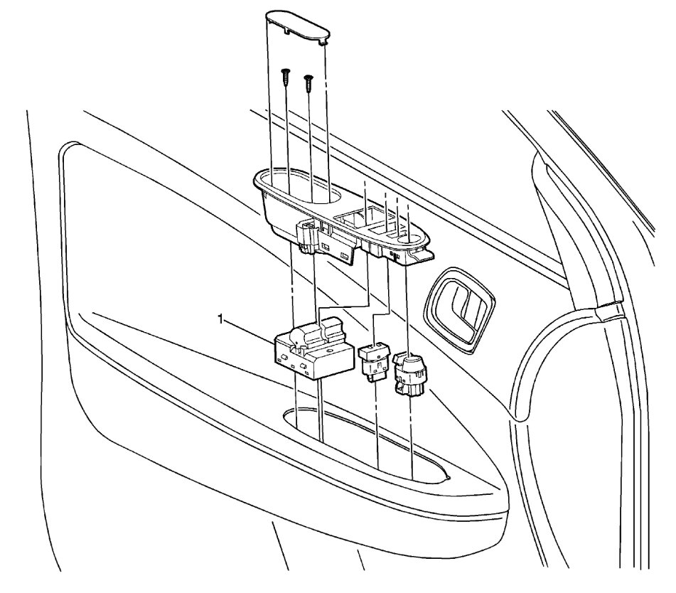

Ok so this was a super helpful thread! As a female a lot I can’t do on my own but I am having the exact same issue! I can’t test it myself I don’t have a meter or anything but every video I have watched points to master switch. Drivers side works fine but passenger only goes down with either switch ( master or using passenger switch) However it won’t go back up. So now it’s stuck 1/3 of the way down. Anyway, that was my burning question before I ordered a new switch. So even if both sides work going down and not up that the problem still lies in the master switch
Nov 6, 2024 at 12:13 PM
  • 55,224 POSTS
Yes, that is completely possible because the main power for the system comes from the main switch. Here is how to change the main window switch out. Check out the images (below). Let us know if you need anything else.
