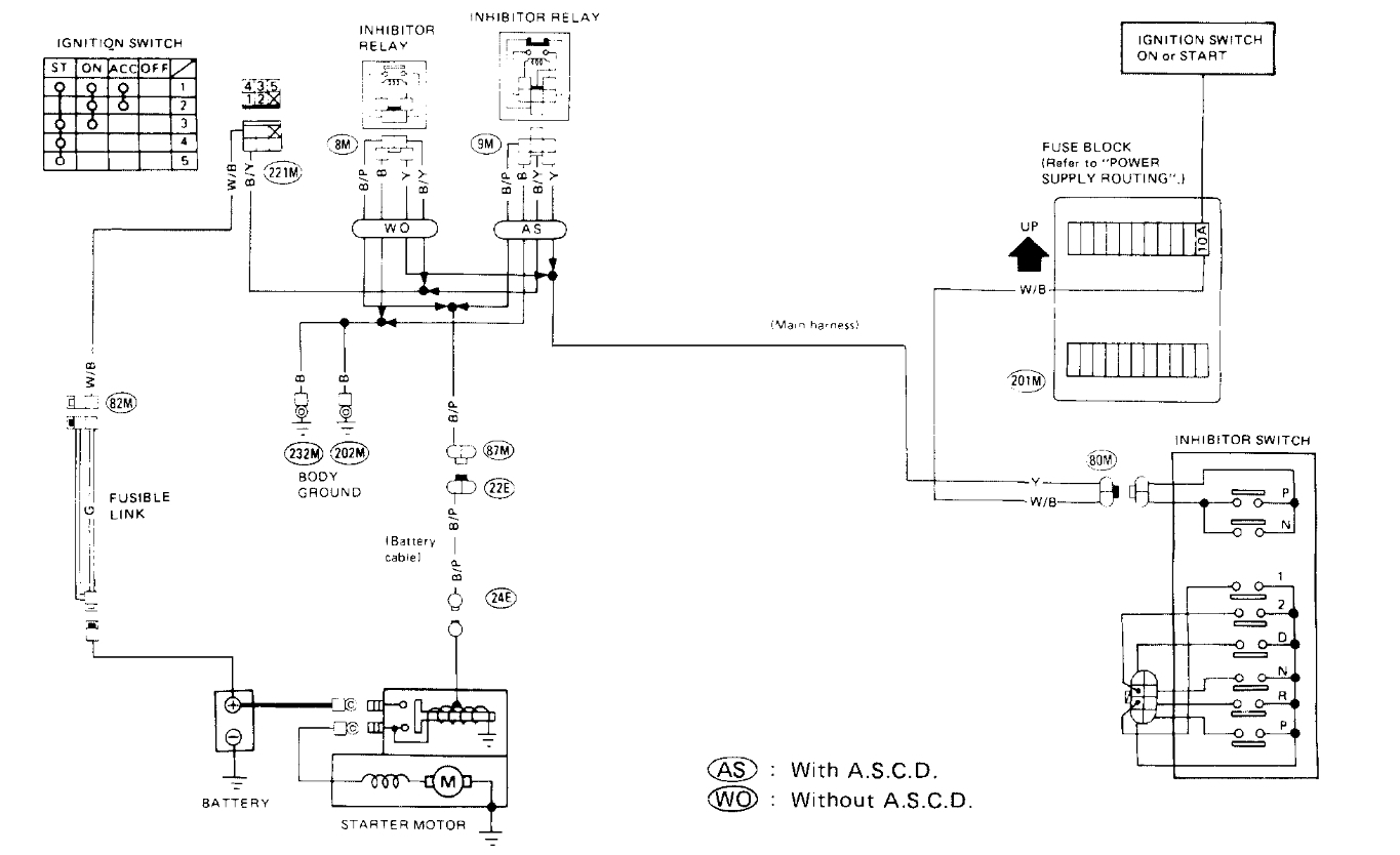

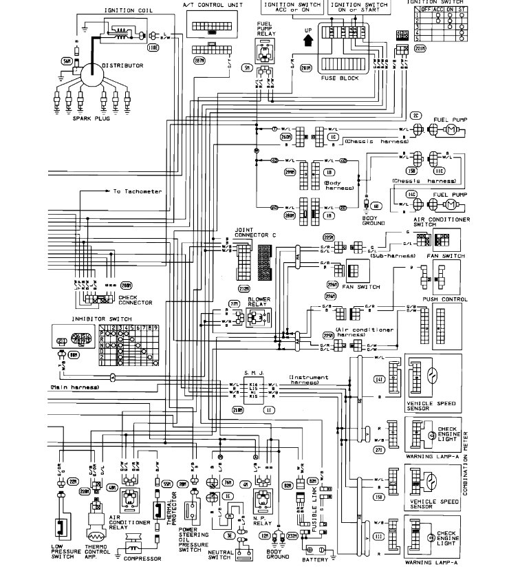

When I turn it the "on" position to turn the car on all power gets shut off to the headlights and wipers shut off
205,000 MILES • 3.0L • 6 CYL • 4WD • AUTOMATIC
TANNERJOEL
So, when I try to start it with the ignition, I turn it to the accessories, and you know I have no gas lights but my wipers and headlights work. Then when I turn it 'on" position to turn the car on all the power goes out; the headlights and wipers shut off until I let go of it and turn it back to accessories. I've checked all fuses and relays fusible links are good. batteries charged. I'm stumped on what it could be. Any help would be very much appreciated. I bought the car for $80.00, so other than that, the tranmission doesn't work.
Jul 9, 2022 at 1:48 PM
  • 55,500 POSTS
It sounds like the ignition switch is worn out. To be sure here is a guide to help you test through the switch using a test light:
Jul 10, 2022 at 8:50 AM
