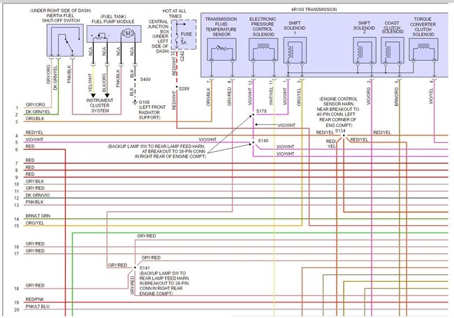

OK update took fuel tank out tested pump and it shot fluid out what is the module with the 3 small wires could that cause it not to send fluid ? I can't find that part

That's the whole problem no pumping until I took it out but would the pump still pump if the piece that twists onto the top of the fuel pump
Aug 24, 2016 at 10:58 AM
RENEE L
  • 1,260 POSTS
Yes it would it is externally grounded.

It is a black wire, here is a diagram to help you.
