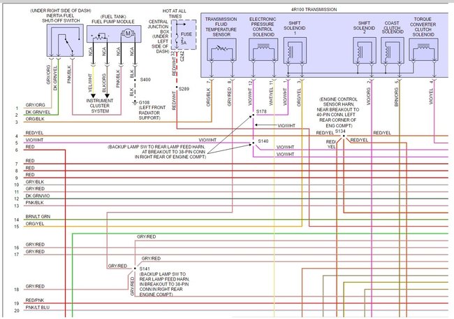

When I turn the key to start it the relays click and the engine turns over. I have checked the power to the fuel pump and the holes are when I checked it about 10. I have checked the relays I replaced by 10 relays and just do not know where to go from here I had it running about a month ago and then the battery went bad so I put a new battery in and now I have no fuel pump everything else works but the fuel pump not kicking in.

Have you verified power arriving at the fuel pump?
Have you verified ground at the fuel pump?

Yes, I have power to the pump what stumps me is all the relays clicking never herd that before.

Okay; last question; am I able to make my own power supply to see if the pump is still active if pump will work?
Wednesday, August 24th, 2016 AT 6:57 AM
WRENCHTECH
  • 20,761 POSTS
These tests are possible, but I do not know if you are the guy to attempt this. Applying power to the wrong wire can result in a lot of damage.
https://www.2carpros.com/images/external/219579047.gif
Wednesday, August 24th, 2016 AT 7:03 AM
OWENHENNINGS
  • 8 POSTS
OK update took fuel tank out tested pump and it shot fluid out what is the module with the 3 small wires could that cause it not to send fluid? I can't find that part

I have no idea what you are looking for. That test you did doesn't prove much of anything. It needed to be done while still in the car with a fuel pressure gauge hooked up.

That's the whole problem no pumping until I took it out but would the pump still pump if the piece that twists onto the top of the fuel pump

Yes it would it is externally grounded.

Not external ground all in the wire harness

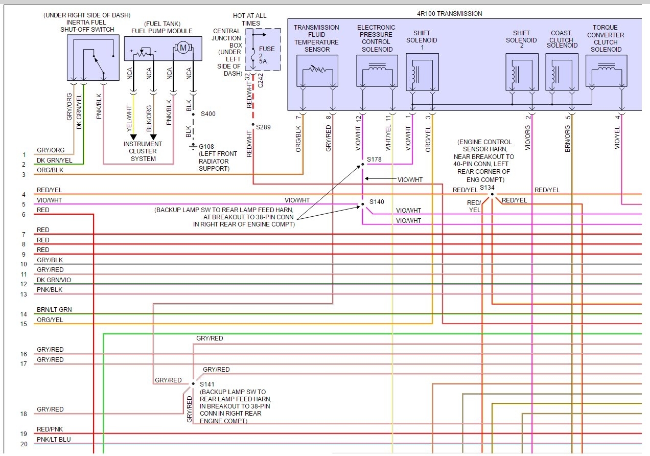

It is a black wire, here is a diagram to help you.
