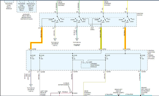

It won't start turns over. fuse box under the dash with the key turned on I have some fuses that have no power.
Mar 8, 2021 at 8:53 PM

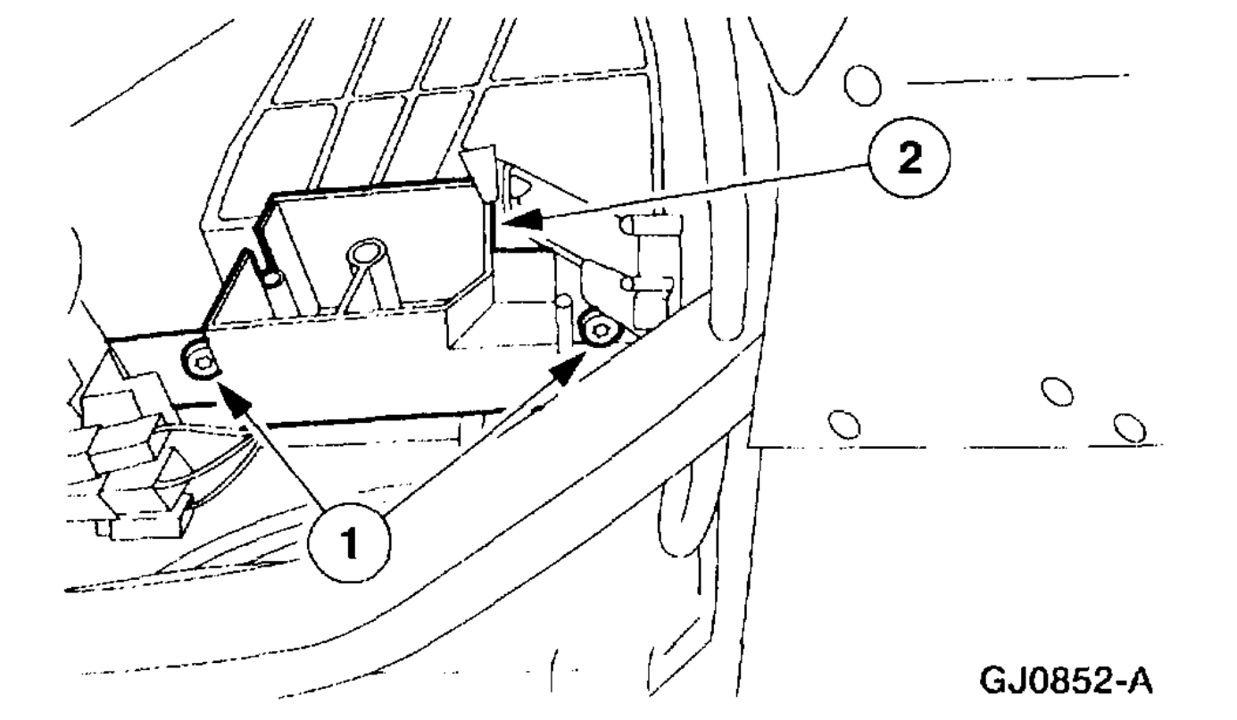

The ignition switch is what feeds the fuse box. I attached the diagram for you.It looks like you need a ignition switch.
Ignition Switch

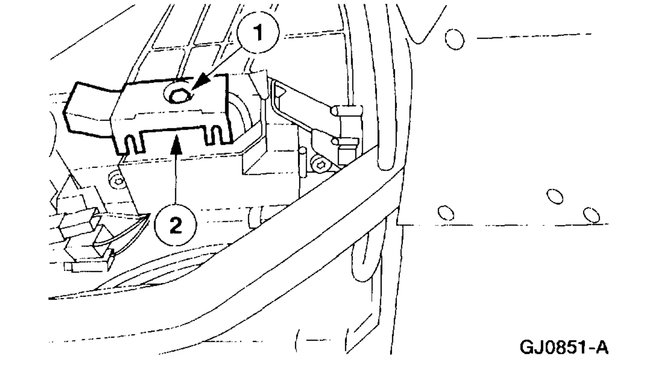

Removal
1. Disconnect the battery ground cable.
2. Remove the instrument panel steering column cover.
3. Disconnect the ignition switch electrical connector.
1. Loosen the bolt.
2. Disconnect the electrical connector.
4. Remove the ignition switch.
1. Remove the screws.
2. Remove the ignition switch.
