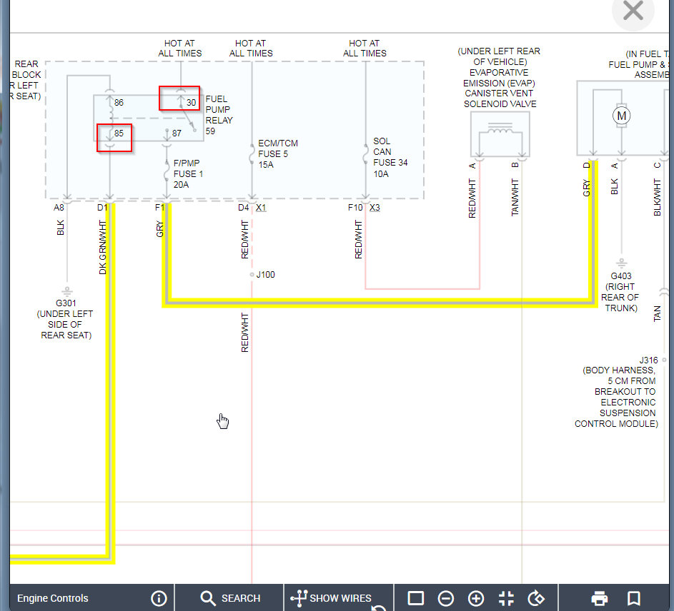

If you have no power at the pump then we need to go to the fuel pump relay and check where we have power and how much power. If you remove the relay, you should have 12 volts all the time on pin 30. Then when you turn the key on you should have 12 volts on pin 85. Let's check this first and go from there because depending on this we will go in different directions.

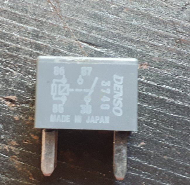

Thank you for your quick reply! I'm in the process of getting a multi-meter because I don't have one yet. But I figured I would check it out with my test light first. With the key off I have power going to the 85 pin. There is no other power going to any other pin whether the key is on or off. Also I notice a difference in the configuration of the relay in the diagram compare to what I have. The 30-pin is not diagonal from the 85 as it says in your diagram. It is adjacent to it, as you can see in the picture posted.

So using your test light with the clip on ground and you touch terminal 30 and you have no power? If that is the case we need to find why. I suspect it is a wire issue or the rear fuse block as an open in it. That should have power all the time so clearly that is an issue. 85 should only have power when you turn the ignition on as that is the control feed from the PCM.

It turns out someone Frankensteined a different relay and inline fuse.
Working to restore it to the original condition...
