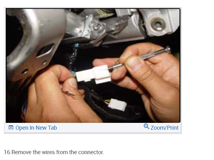

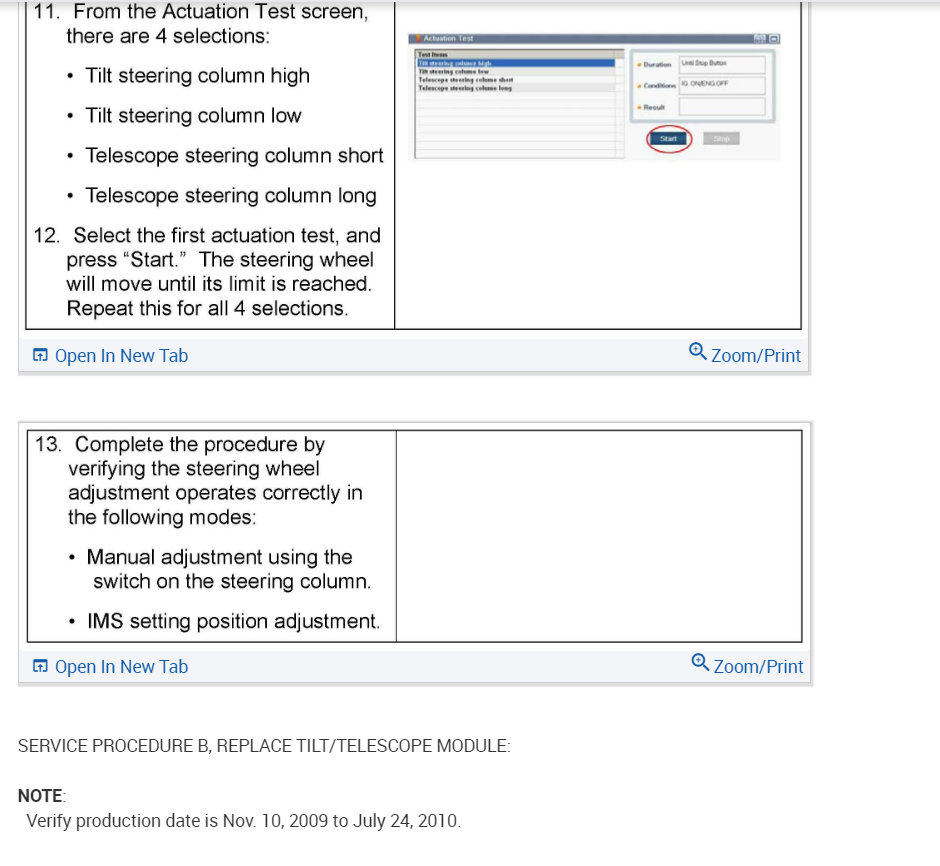

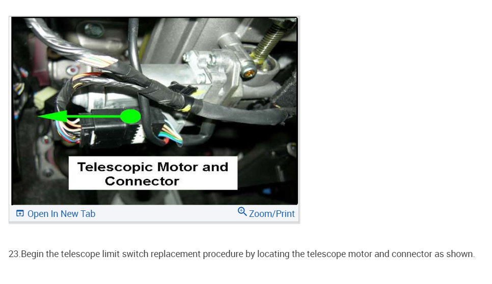

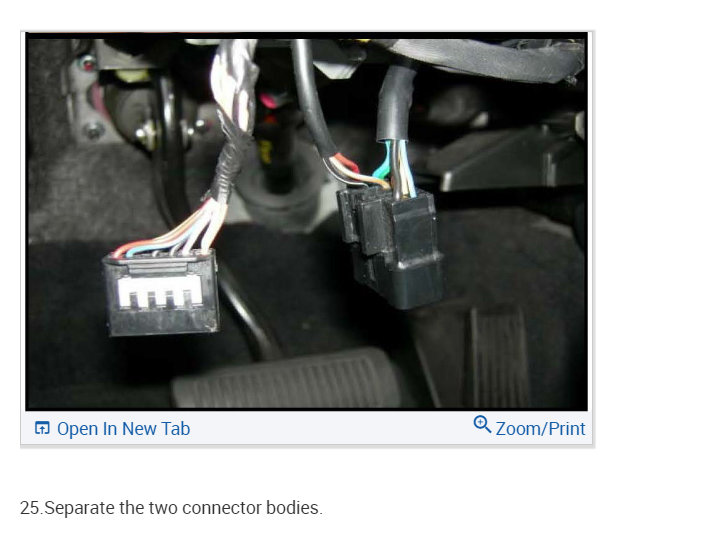

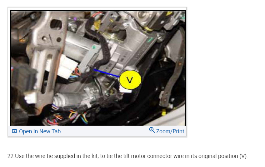

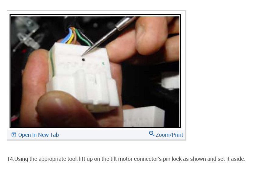

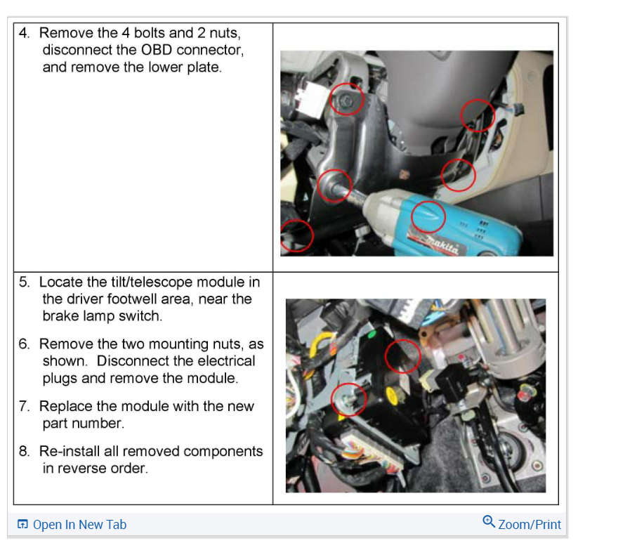

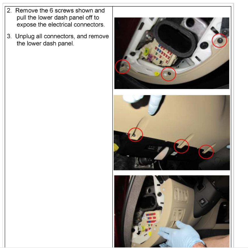

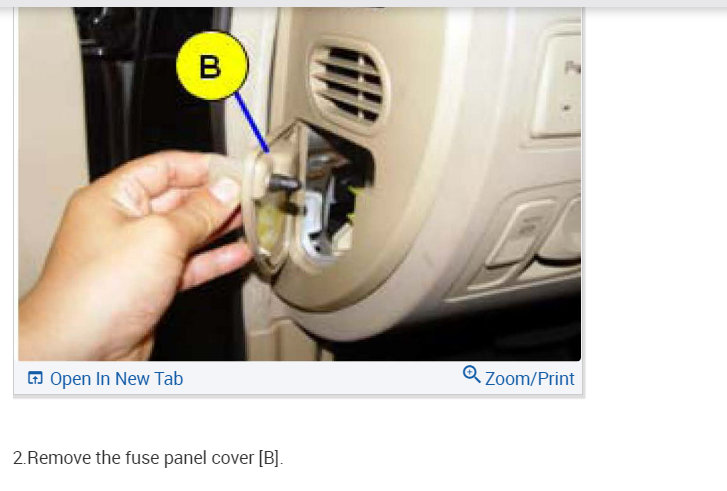

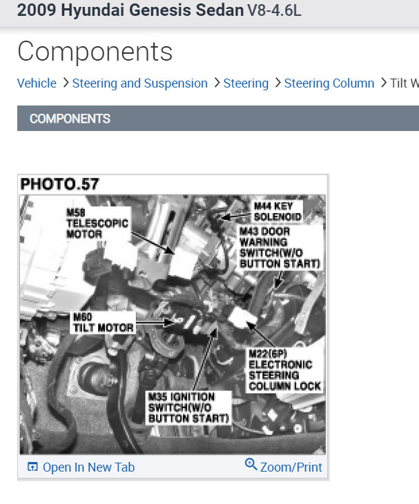

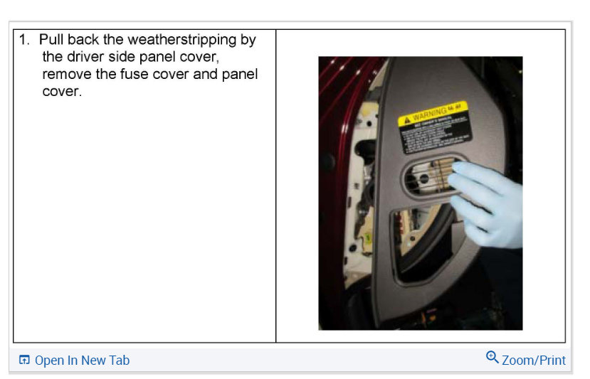

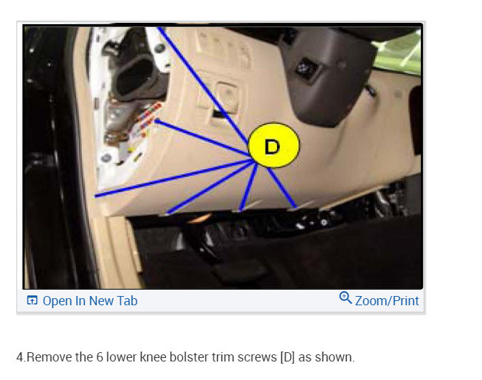

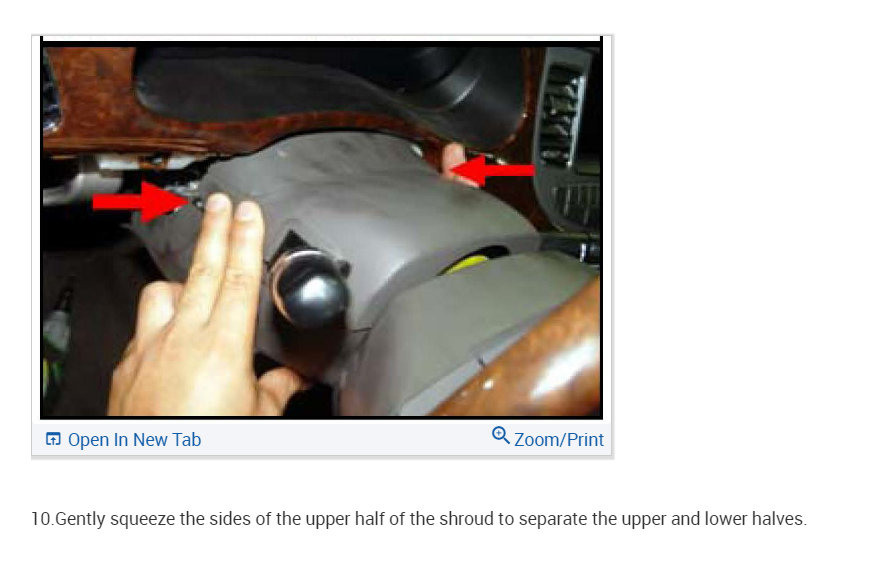

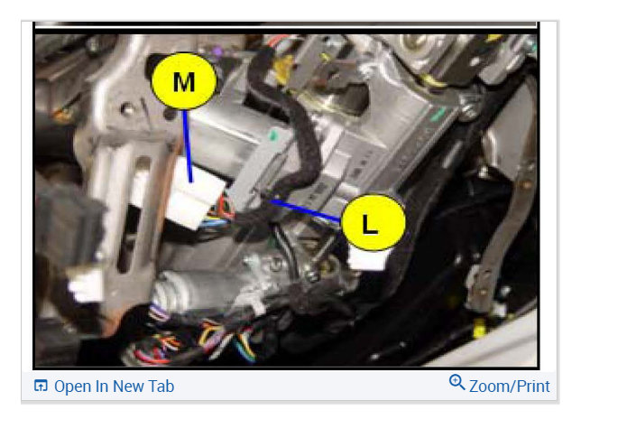

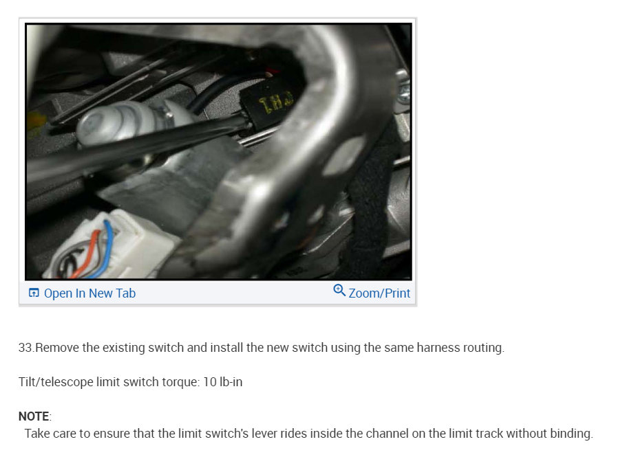

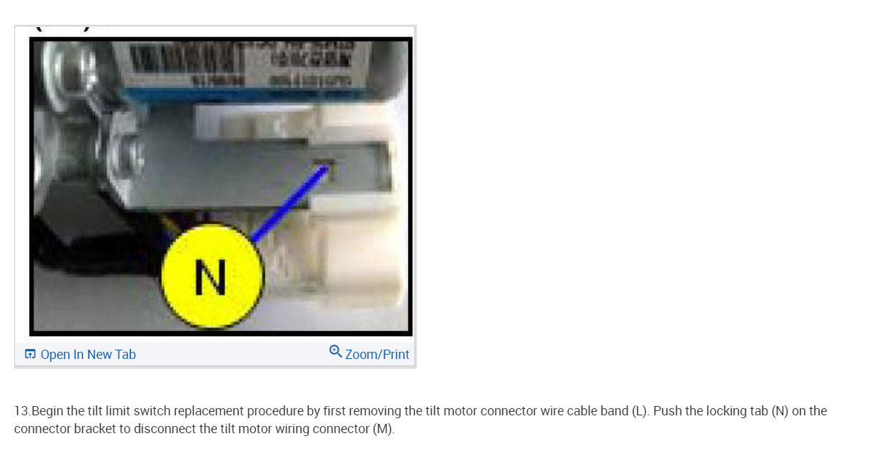

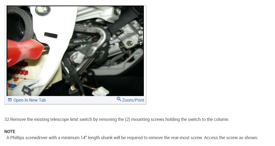

I bought the car cheap, tried power tilt but only works downward so left it alone. Is there a TSB on this issue?
Aug 17, 2022 at 9:17 AM
  • 55,433 POSTS

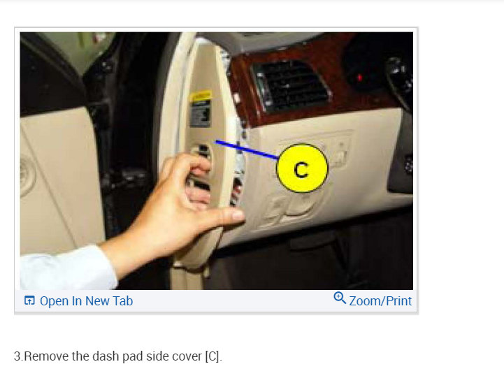

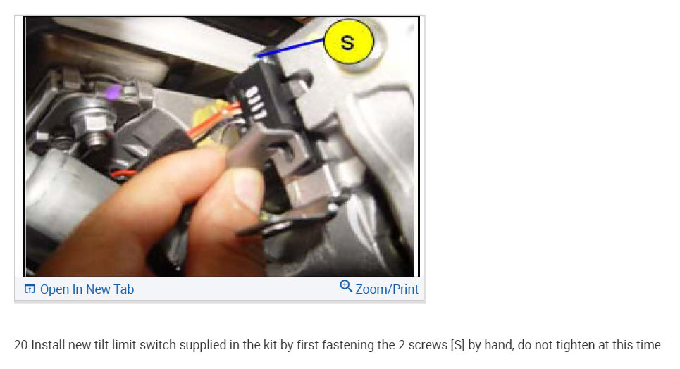

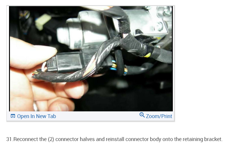

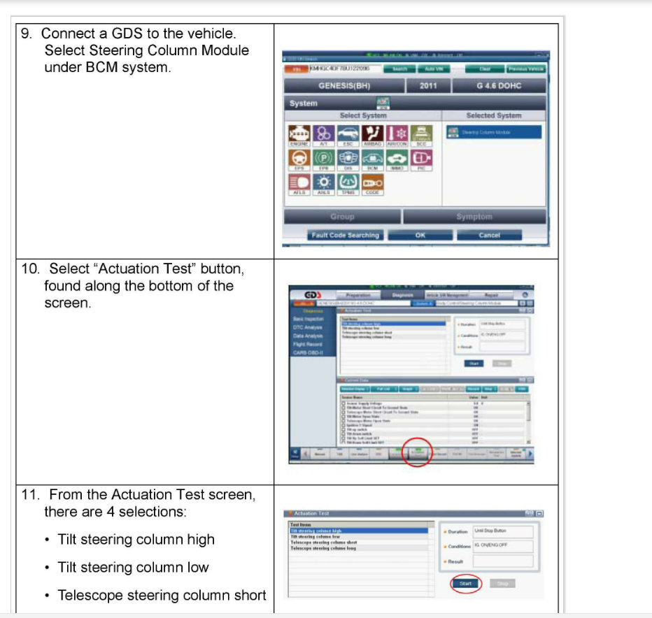

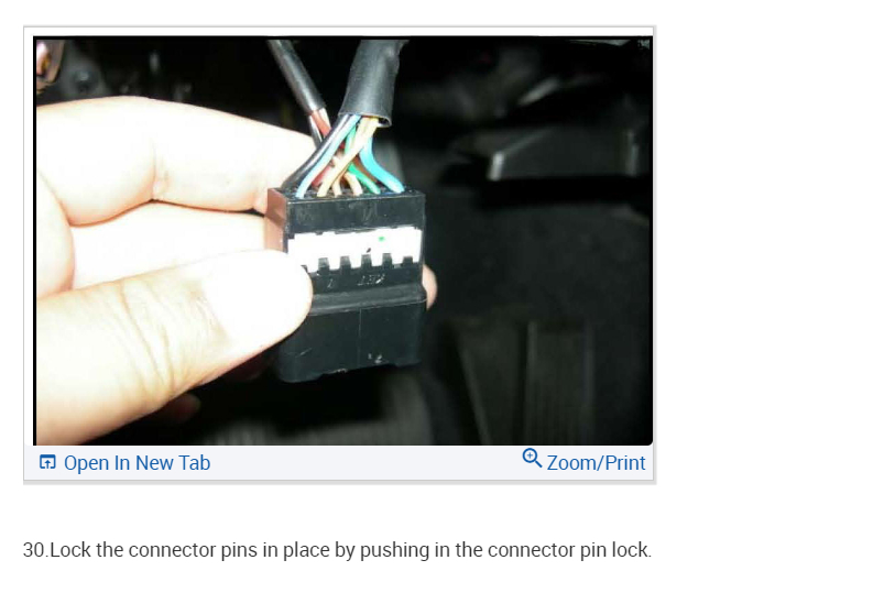

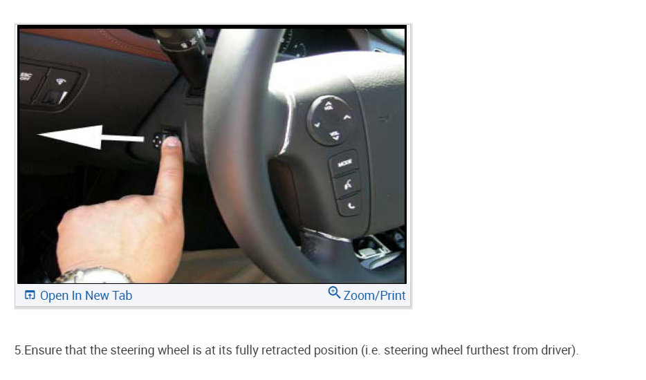

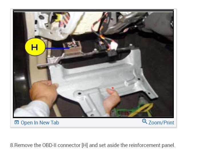

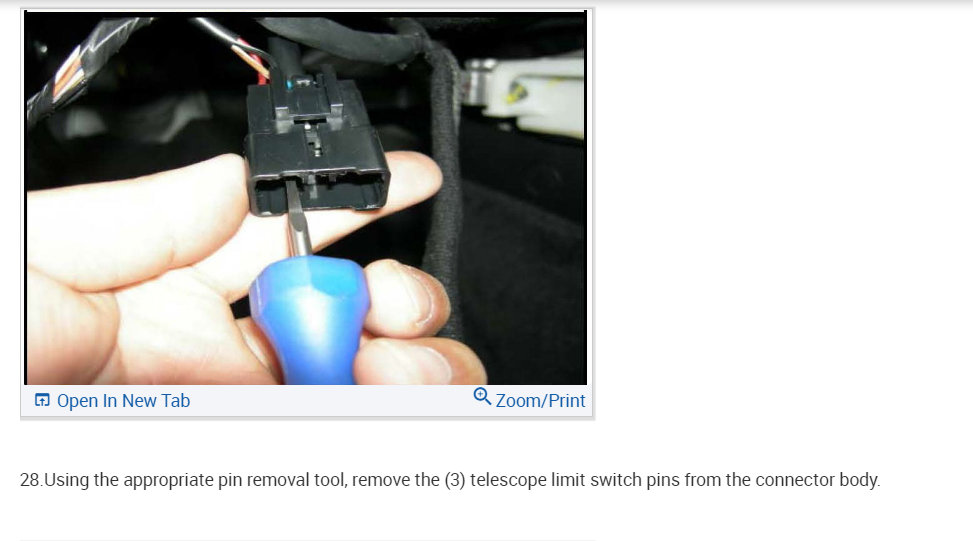

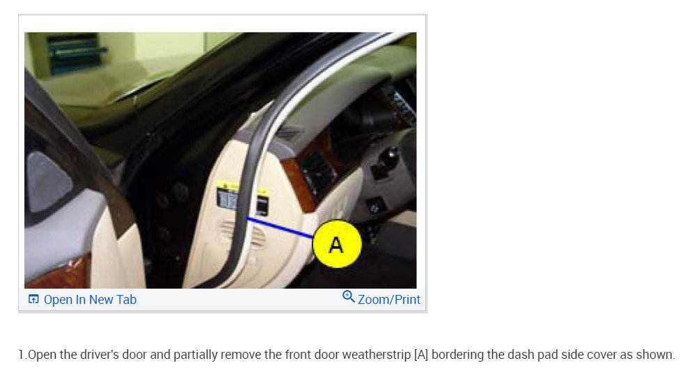

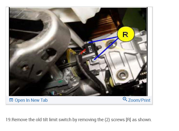

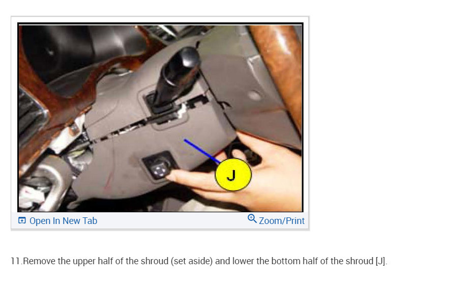

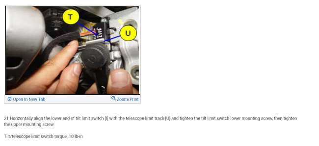

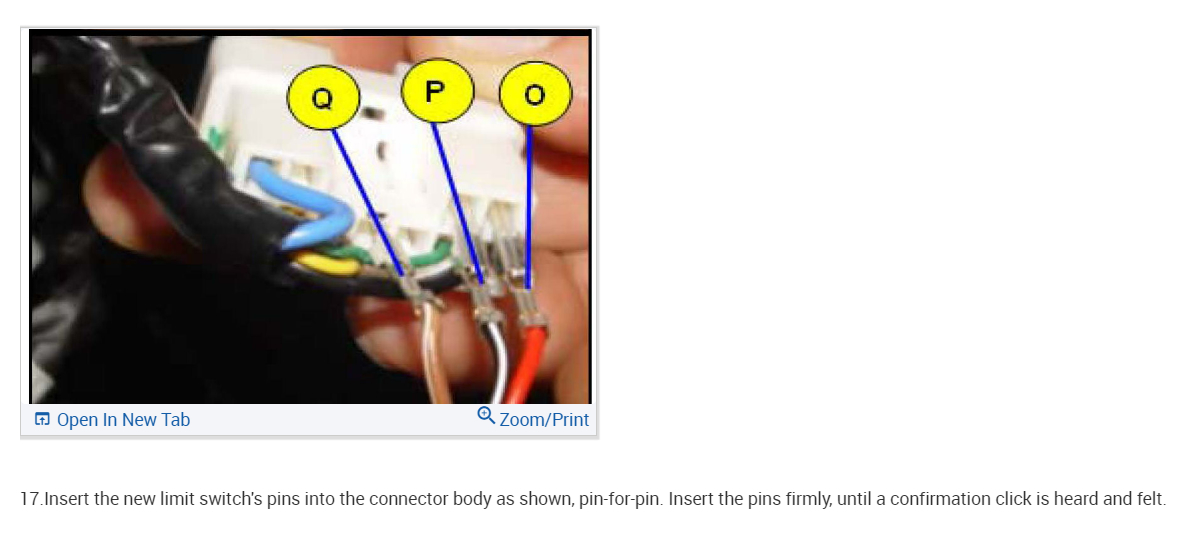

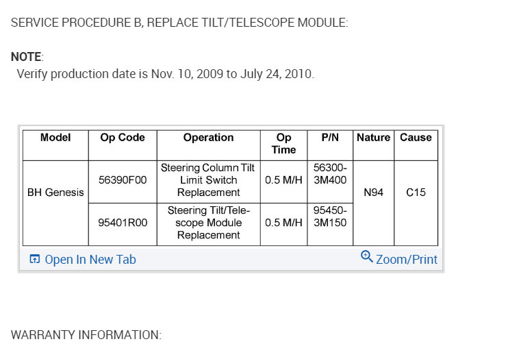

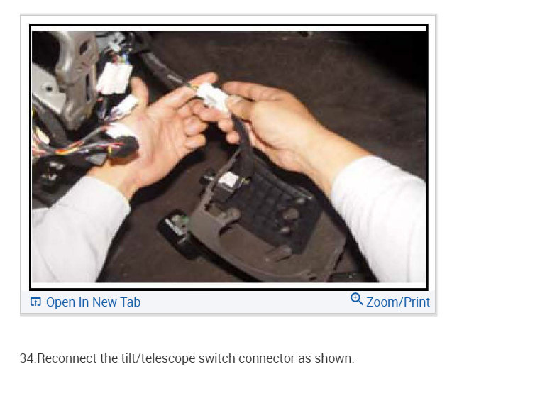

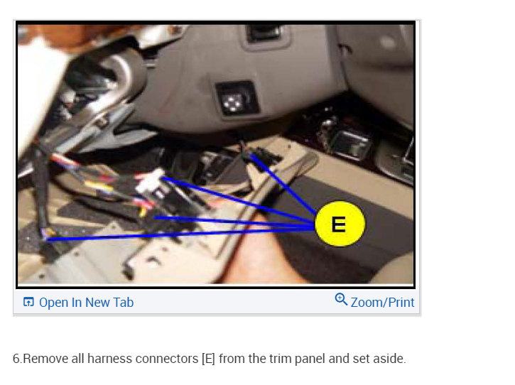

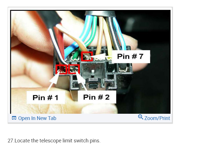

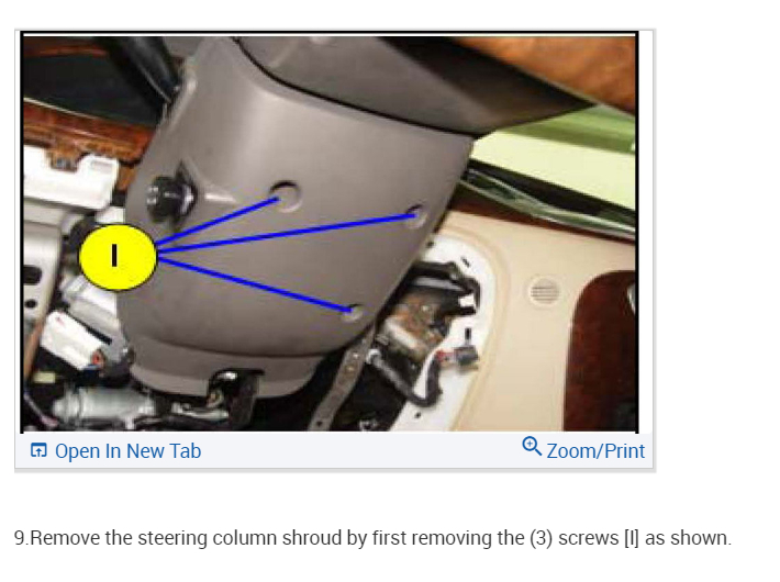

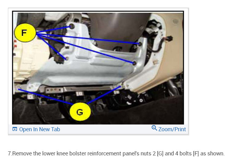

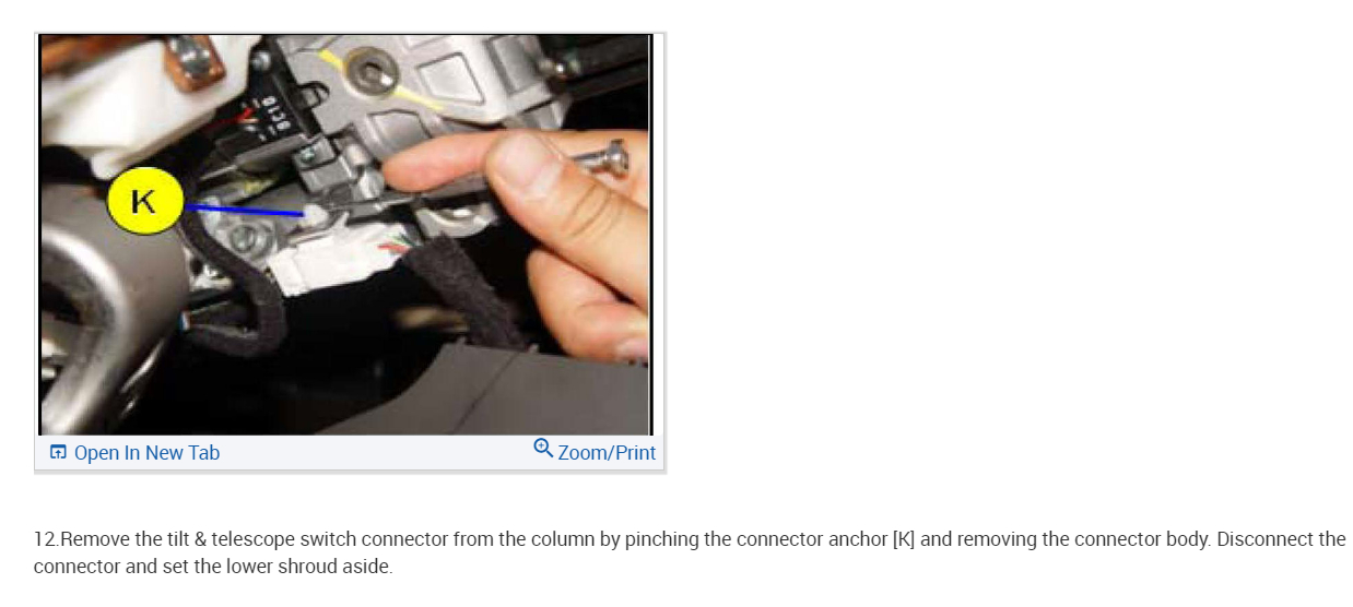

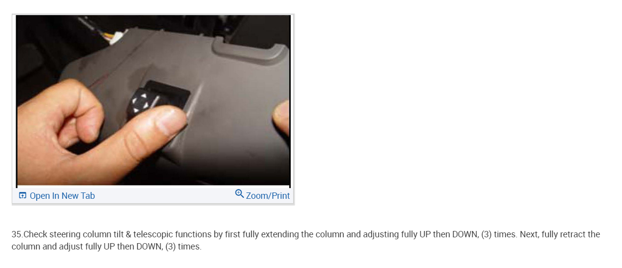

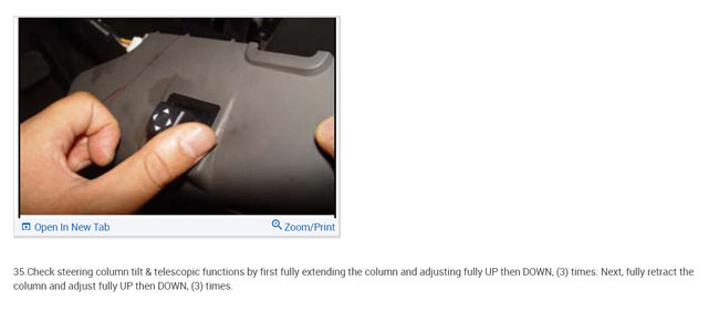

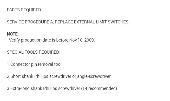

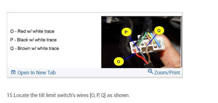

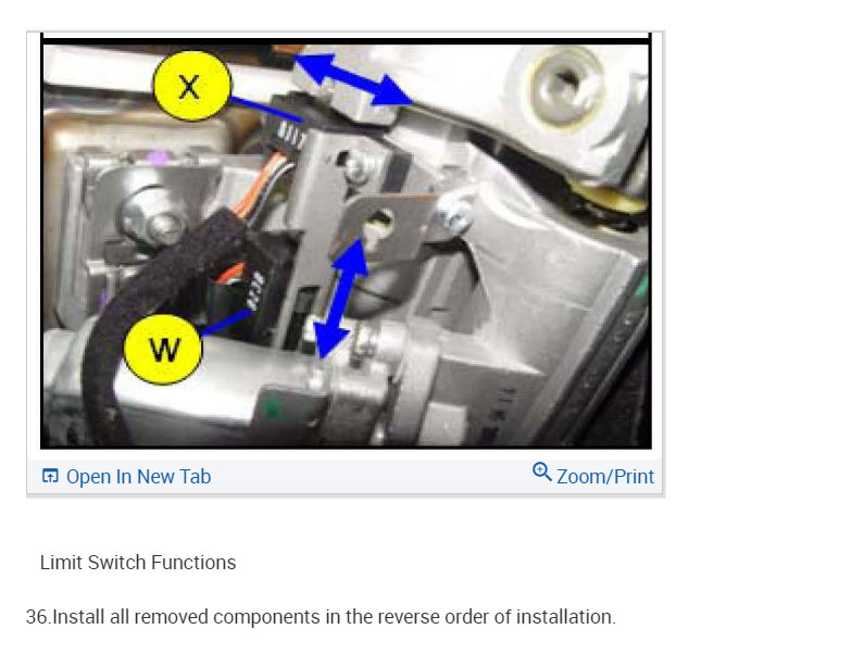

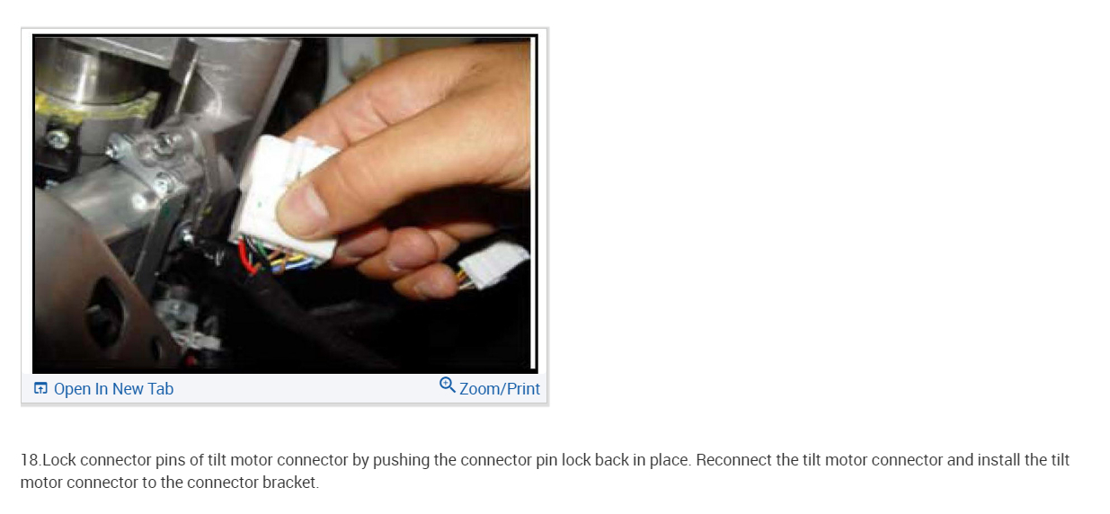

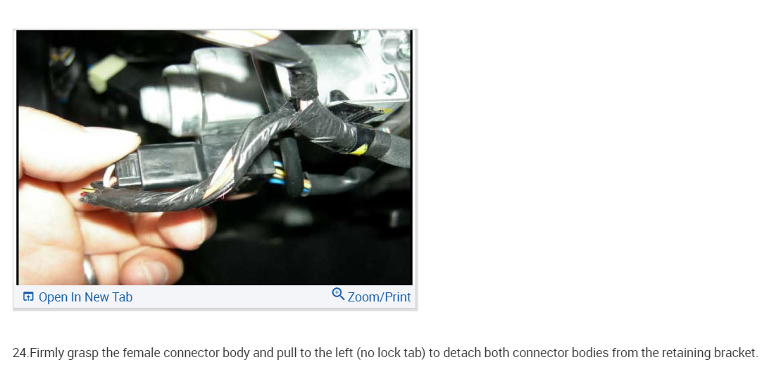

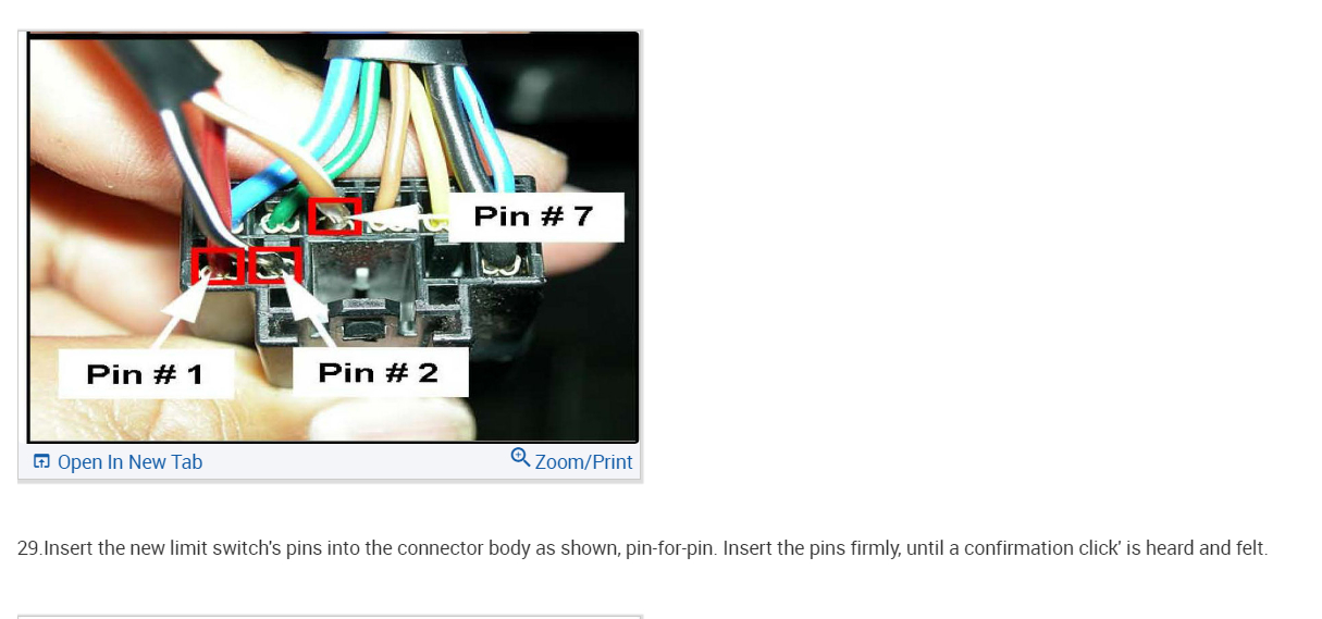

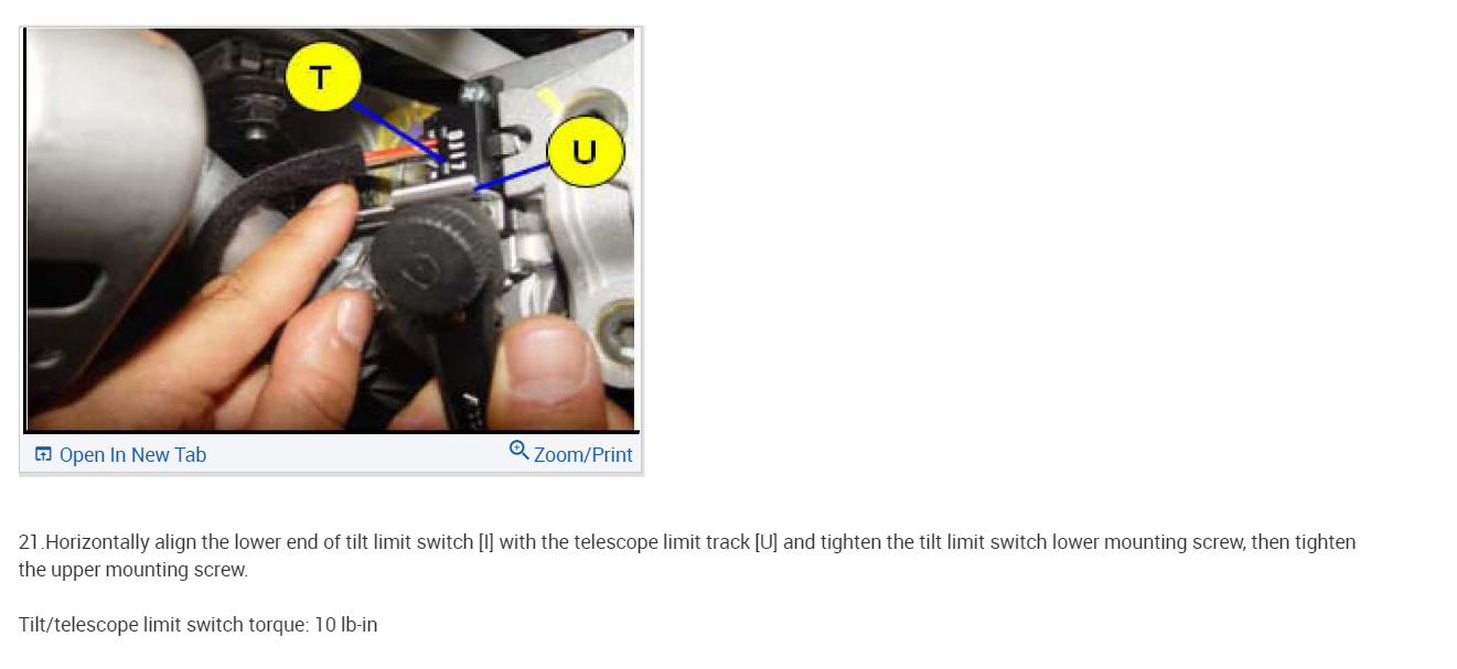

Yes, there are TSBs on this problem, check the images below.
Group: ELECTRICAL
Number: 11-BE-003
Date: JANUARY 2011
Model: 2009-2011 GENESIS
Subject
(UPDATE) STEERING WHEEL POWER TILT & TELESCOPE LIMIT SWITCH AND MODULE REPLACEMENT
This bulletin supersedes TSB 10-BE-002-1 to revise production date ranges and include secondary repair procedure.
DESCRIPTION:
This bulletin provides the service procedure to repair inoperation of tilt and telescope adjustment for BH Genesis vehicles.
NOTE:
Use Service Procedure A (for vehicles produced before November 10, 2009) to replace external limit switches.
NOTE:
Use Service Procedure B (for vehicles produced November 10, 2009 and later) to replace tilt/telescope module.
NOTE:
When replacing the tilt/telescope module (Service Procedure B), be sure to perform the GDS actuation tests and confirm proper operation of IMS system.
APPLICABLE VEHICLES:
^ Model - 2009-2011 (BH) Genesis W/ Power Steering Tilt/Telescope Column
^ Production Range - April 25, 2008 July 24, 2010
Aug 18, 2022 at 3:12 AM

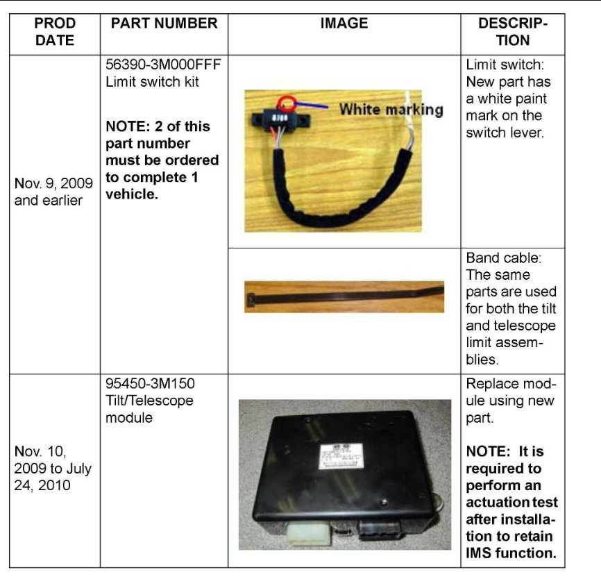

I see. Thanks. Based on what i read in here and mine was produced in march 09 i need 2 of the cables? With the part numbers listed in there?
Aug 18, 2022 at 4:14 AM
  • 55,433 POSTS
The part numbers are on the second diagrams in the images above.
Aug 18, 2022 at 11:53 AM
BHAMDOC1973
  • 2,007 POSTS
I know, what I am asking is: it says in there the repair needs two of the same part, does that sound right? The repair mentioned here is for the limit switch, which will apply to me, not the module, so hopefully this is an easy one.
Aug 18, 2022 at 12:01 PM
  • 55,433 POSTS
Yes, it does sound right, they have some kind of reconfiguration of the wiring harness.
