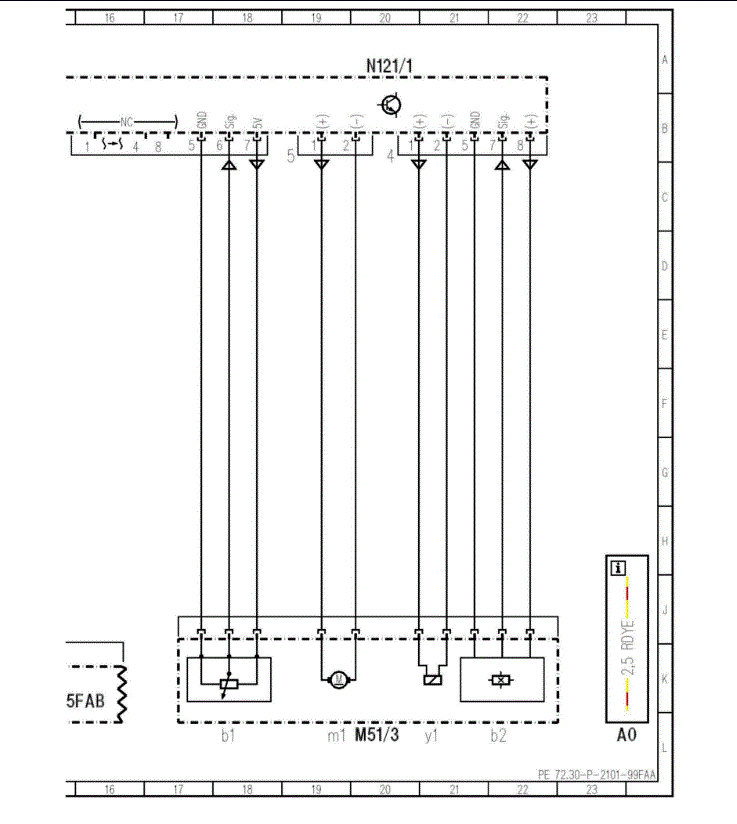

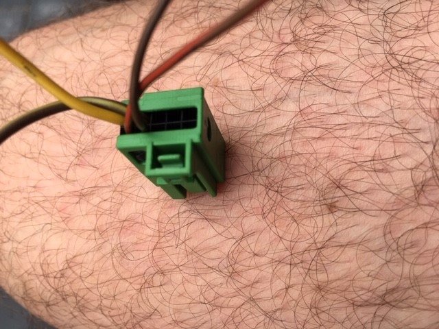

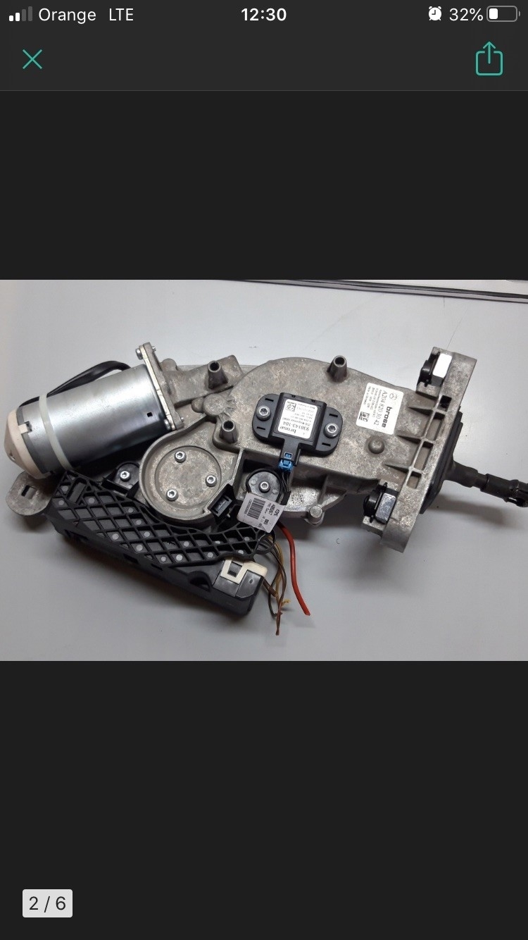

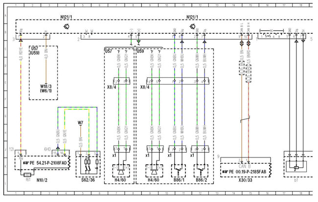

Hi, the vehicle listed above is an GLK X204. I purchased all original parts to upgrade my manual tailgate to automatic . I need electrical diagram to connect flap opening motor . On the screen you can see 6 psc cable
- red - +
- brown - mass
But i don't know where connect rest four cables in a green plug witch the module A2129009916
-yellow
-yellow/black
- brown
- brown/red
Can somebody help me ?

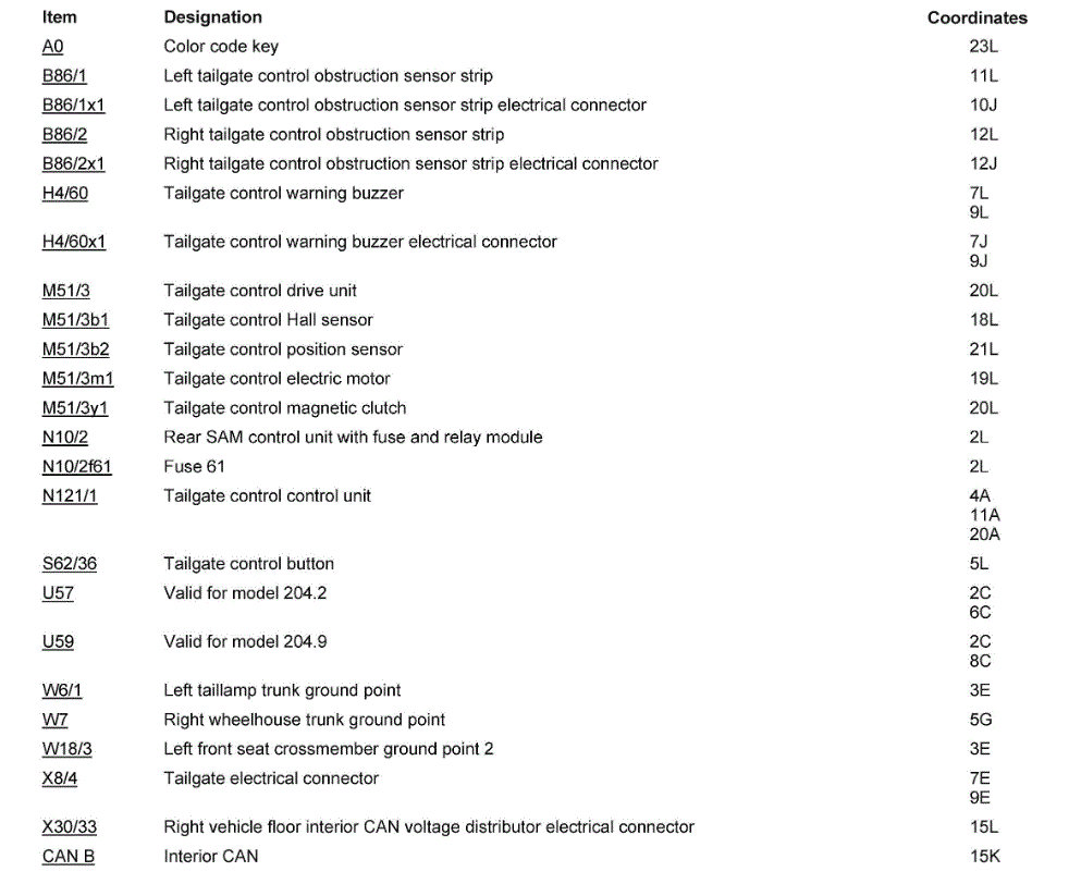

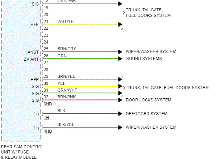

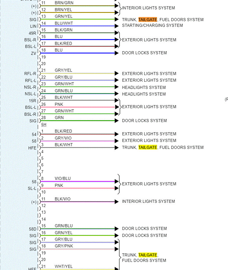

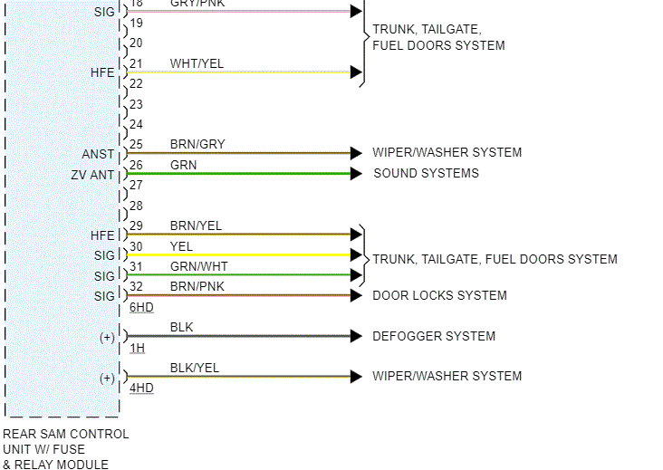

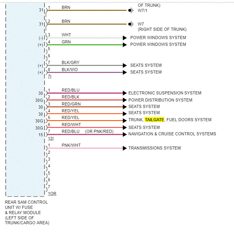

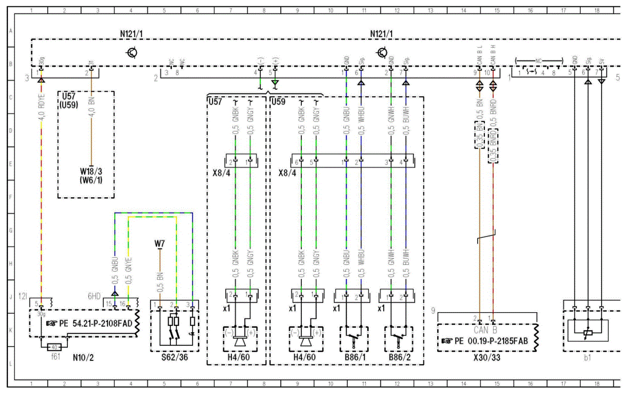

I attached everything I was able to find related to the tailgate. Let me know if any of this is helpful.
Jun 29, 2020 at 2:17 PM

Thank you for your help . I check this drawing and let me know if it helped .

You are very welcome. I just hope it works for you. My biggest concern is if the control module is set up to operate this component since it wasn't built with it.

I have a question about connection X30/33 can you tell me where i found physical this connection in my car ?
Jun 29, 2020 at 6:58 PM
  • 110,248 POSTS
All I can tell you is that it is part of the interior CAN system.
