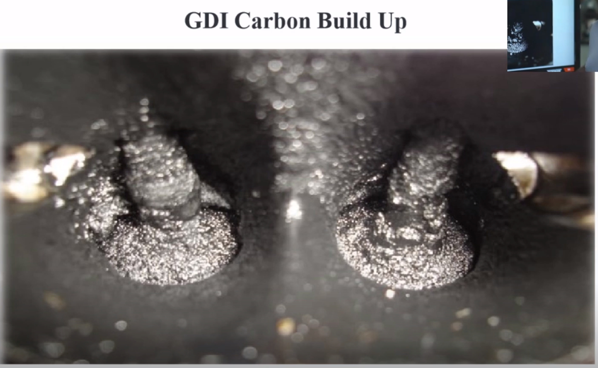

After 20 minutes of driving my power started to stutter very noticeably. It’s not rhythmic rocking, it’s as if there is a faulty connection. Some rapid and some longer stutters. I have had the plugs, coils, and Mass air flow sensor changed and it’s still doing it. No codes are showing. It’s been getting worse as I drive it more.

Hello, it's definitely a cylinder(s) misfires occurring. If it gets worse, codes will start to show up. But this is a high-pressure direct injection engine, most likely what is happening is carbon build up on the top of the intake valves. This happens with these systems because the fuel is injected directly into the cylinder and not into the intake manifold where it would clean the intake valves on its way into the cylinders. They recommend having the intake valves cleaned every 30,000 miles with these systems. It requires cleaning the valves manually. The issue will only get worse if not addressed very soon. Below is a picture of what happens to the valves on these systems, so I recommend having them checked very soon.
