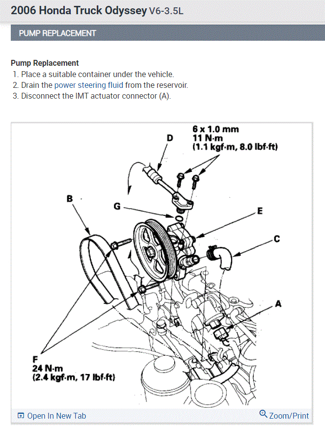

I need to replace my power steering unit, how hard is this going to be?
Aug 27, 2021 at 9:04 AM
  • 110,241 POSTS
If you are referring to the power steering pump, the manual calls for 1.6 hours of labor. It shouldn't be too difficult.
To get you started, here is a link that shows in general how one is replaced. You can use this as a guide.
https://www.2carpros.com/articles/how-to-replace-a-power-steering-pump

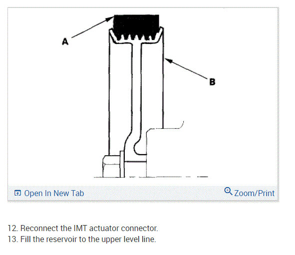

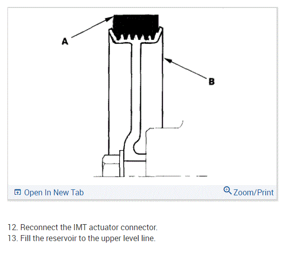

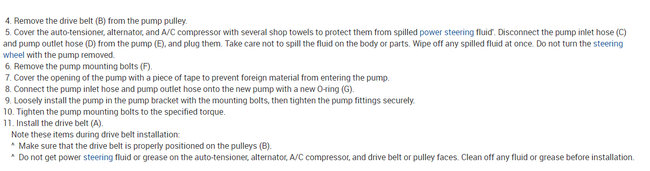

If you look at the attachments below, they provide the directions specific to your vehicle. Take a look through them and see if you have questions.
