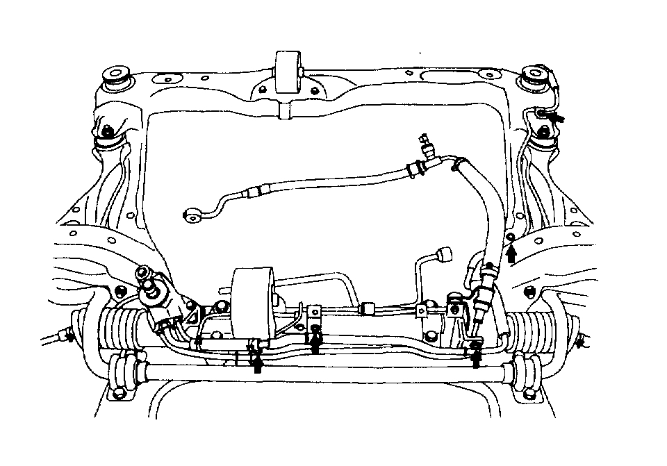

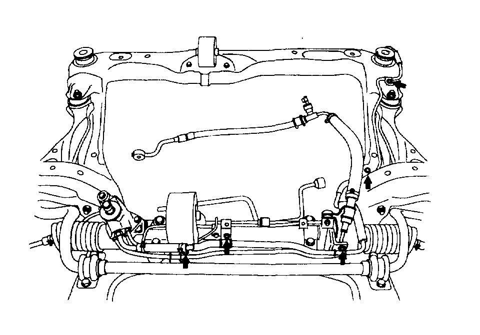

I cut and removed the original power tubing line.
Now having a problem getting the new one reinstalled?
Jun 29, 2019 at 1:34 PM
  • 110,244 POSTS
Welcome to P0495
Hi Brian. I'm not sure if you cut the high or low pressure line. Is it from the PS pump?

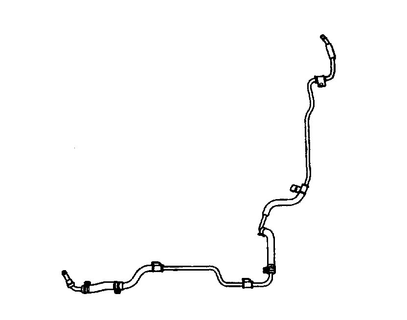

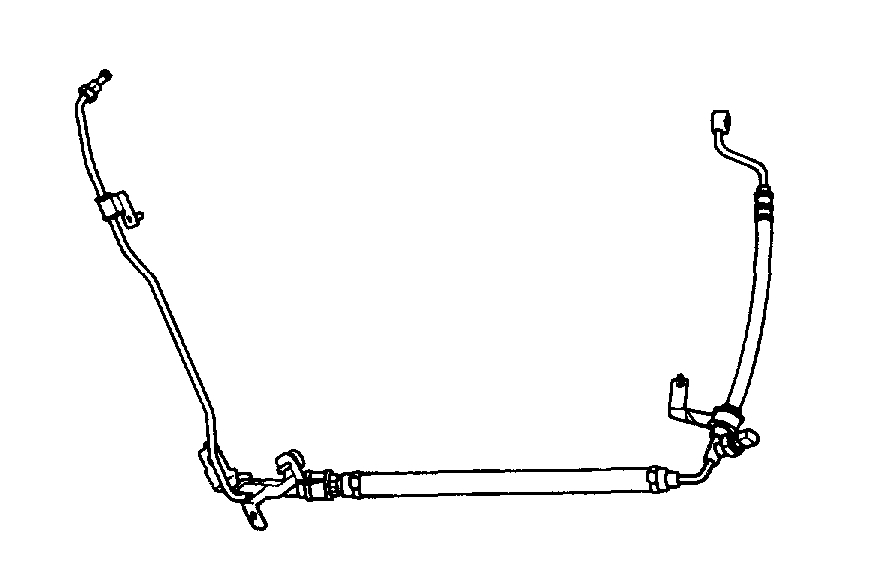

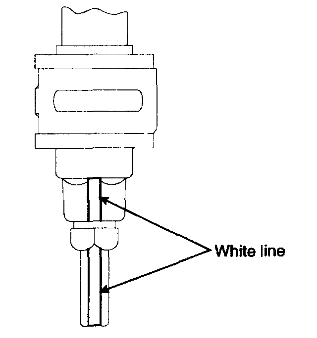

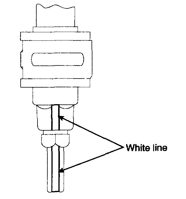

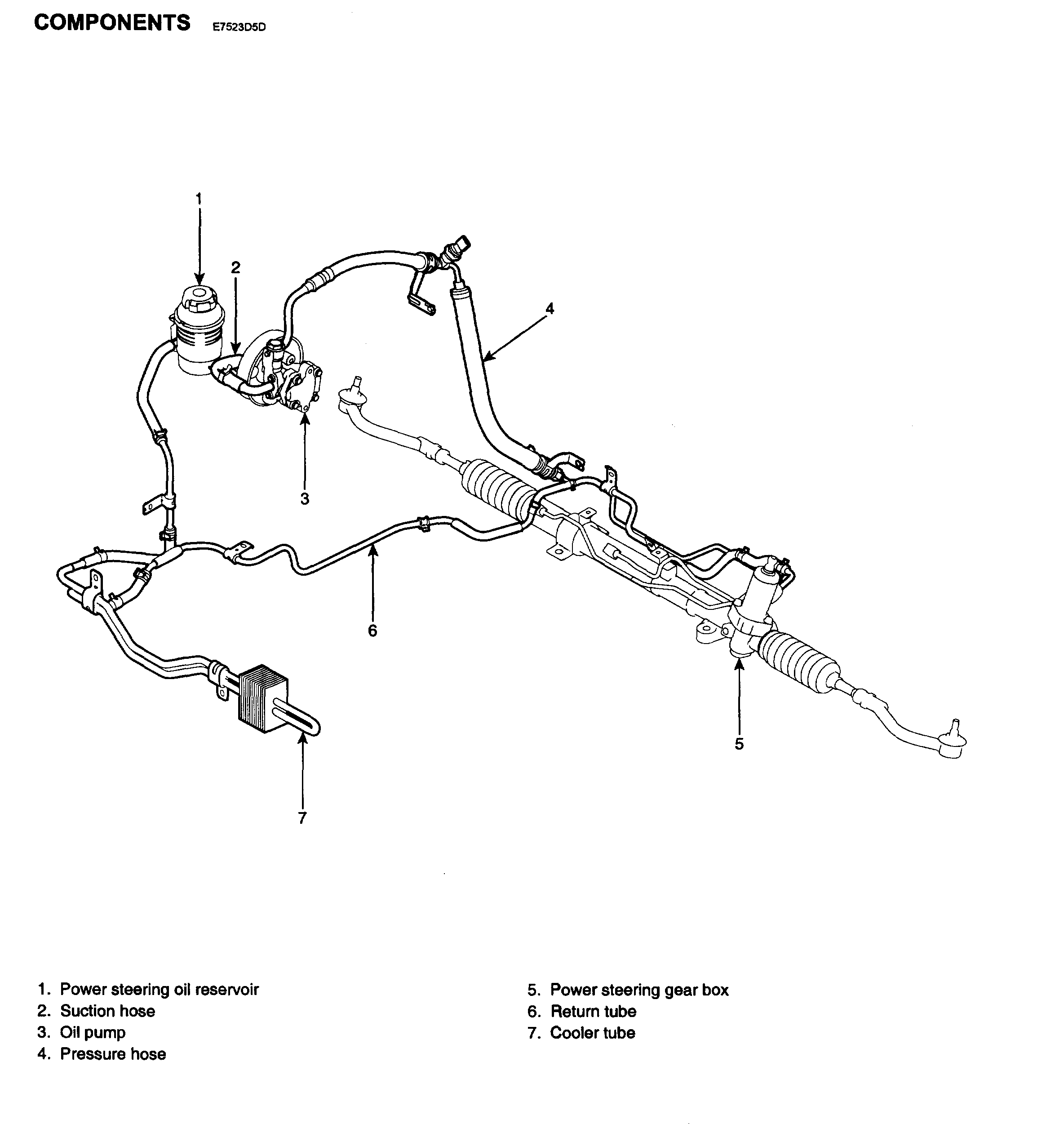

Here are the directions from my manual regarding power steering hoses and replacement. The attached pictures correlate with the directions. Take a look and let me know if it helps.
___________________________________________
REMOVAL AND REPLACEMENT
POWER STEERING HOSES
COMPONENTS
pic 1
REMOVAL
While installing the tube and hose assembly, be sure to align white marks on each fitting.
pic 2
PRESSURE HOSE, TUBE AND RETURN TUBE, HOSE
1. Remove the mounting clamps from the pressure tube and the return tube.
pic 3
2. Remove the pitting of both the pressure tube and the return tube from the gearbox.
3. Remove the pressure hose and tube.
pic 4
4. Remove the return tube and hose.
pic 5
INSTALLATION
Installation is the reverse of removal.
NOTE: Install the return tube and hoses so that they are not twisted and it does not come in contact with any other parts. After installation, air bleed the system.
