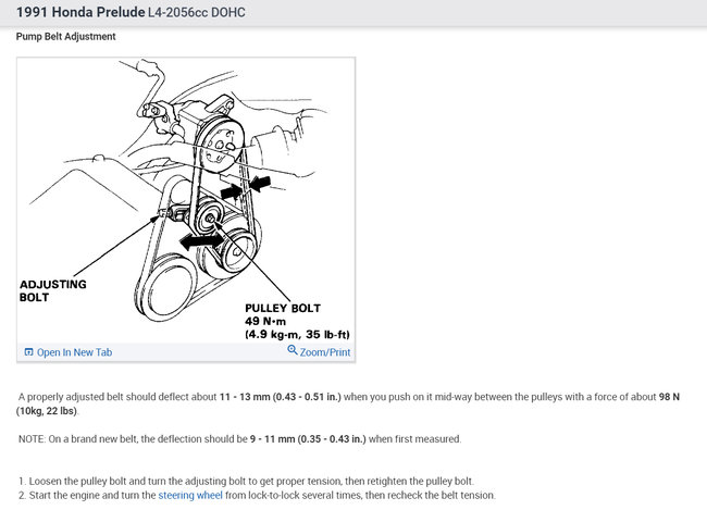

I need a new power steering pump tensioner pulley. Everything I look up is for 19992 and up.

Have you tried Advanced auto? Here is one I found:
https://shop.advanceautoparts.com/p/litens-belt-tensioning-pulley-assembly-original-equipment-quality-900423a/10150962-p?c3ch=PLA&c3nid=10150962-P&adtype=pla_with_promotion&product_channel=online&store_code=&gclid=Cj0KCQjwheyUBhD-ARIsAHJNM-NqcPX4E8AA2TDvGZ6Atm2u3cr2HbJ1uKQCHRA6z5X-sZtzZZ3-QP4aAjAoEALw_wcB&gclsrc=aw.ds

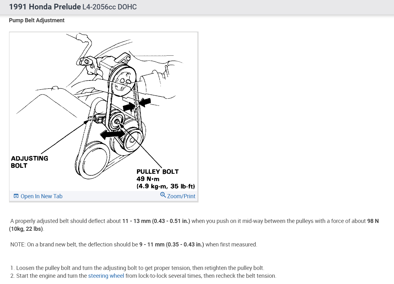

Also, here are the replacement torque specs and instructions on how to change it out in the diagrams below. Check out the diagrams (below). Please let us know if you need anything else to get the problem fixed.
Image (Click to enlarge)
