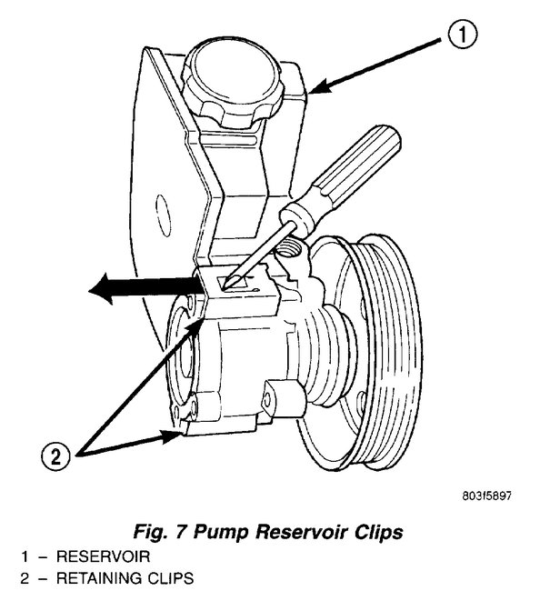

How do I remove power steering reservoir?
Sep 20, 2018 at 11:21 AM
  • 110,248 POSTS
Here are the directions your requested. The attached picture correlates with these directions.
_____________________
REMOVAL
1. Remove power steering pump.
2. Clean exterior of pump.
3. Clamp the pump body in a soft jaw vice.
4. Pry up tab and slide the retaining clips off.
5. Remove fluid reservoir from pump body. Remove and discard O-ring seal.
INSTALLATION
1. Lubricate new O-ring Seal with Mopar (R) Power Steering Fluid or equivalent.
2. Install O-ring seal in housing.
3. Install reservoir onto housing.
4. Slide and tap in reservoir retainer clips until tab locks to housing.
5. Install power steering pump. Refer to Power Steering Pump/Service and Repair/Replacement. See: Power Steering Pump > Procedures > Power Steering Pump Removal and Installation
6. Add power steering fluid, refer to Power Steering Pump/Service and Repair/Initial Operation. See: Power Steering Pump > Procedures > Power Steering Pump Initial Operation
