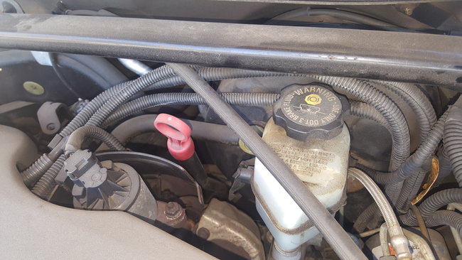

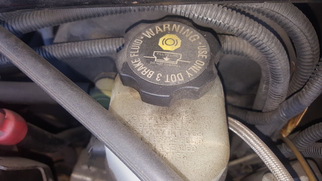

I have some pictures of my engine bay. I see the brake fluid reservoir, where is the power steering wheel reservoir. I see a red dipstick to the left of the brake fluid reservoir. Is this it?

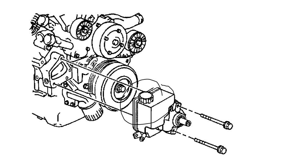

That is the transmission dipstick. The power steering in down at the bottom of the motor back by the firewall.
They actually paid someone to design it there. They never thought of us putting it in that location.

Okay, you need a long funnel to get to the fill for the power steering itself. Then you can add the fluid.
As far as changing it, you can use a vacuum bleeder that is used for the brake system. You can remove the fluid and install new fluid. You need to do this several times.
https://www.2carpros.com/articles/power-steering-fluid-flush
As far as bleeding it, you only need to turn the wheel side to side until it stops several times to bleed it out.
