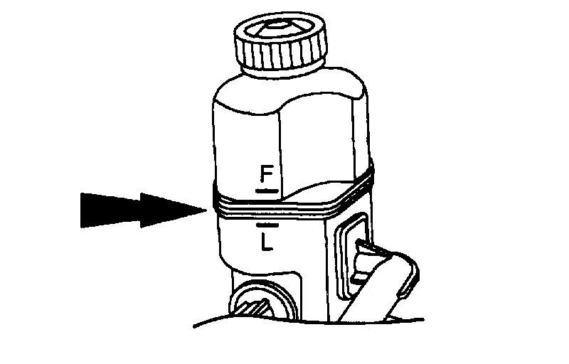

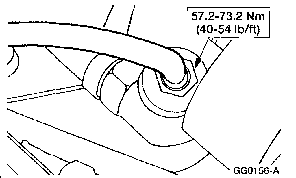

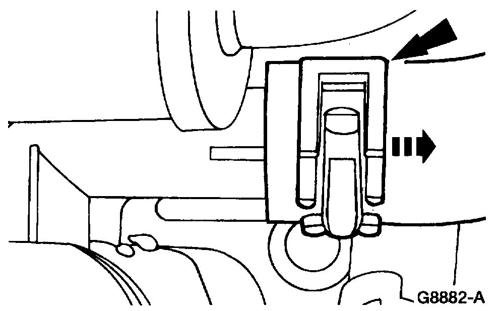

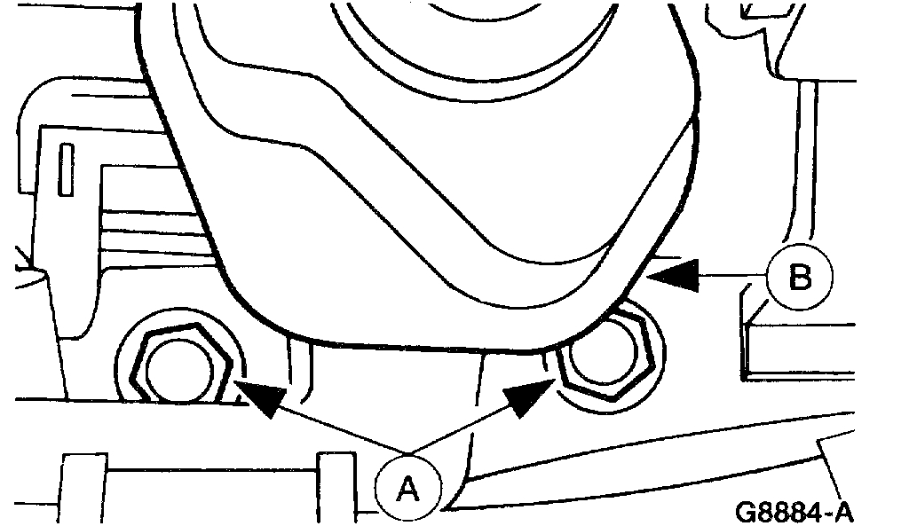

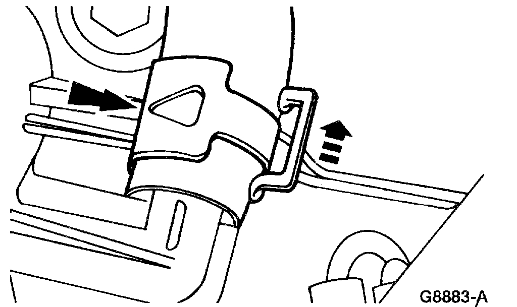

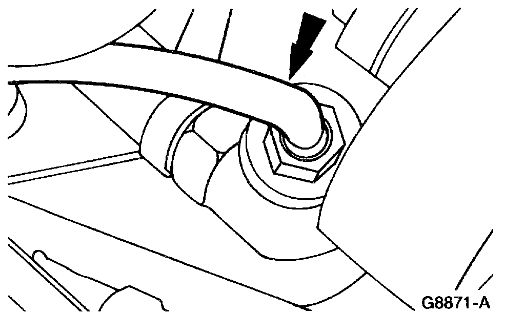

I need to replace the power steering pump but it doesn't come with the reservoir. How hard is it and what steps are needed to attach the old reservoir to the new pump?
Jul 18, 2019 at 11:33 AM
  • 110,194 POSTS
Welcome to 2CarPros.
It isn't hard. Here are the directions and the pics correlate with the directions:
_______________
Vehicle Steering and Suspension Steering Power Steering Power Steering Fluid Reservoir Service and Repair Procedures
PROCEDURES
Removal
pic 1
1. Loosen the clamp and disconnect the power steering reservoir pump hose.
pic 2
2. Loosen the clamp and disconnect the power steering return hose.
pic 3
3. Remove the (A) bolts and the (B) power steering pump reservoir.

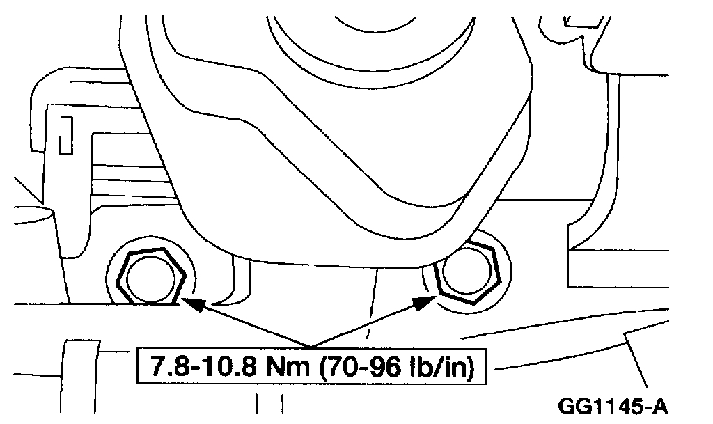

Installation
pic 4
1. To install, reverse the removal procedure.
^ Fill power steering system.

I don't know if you need them, but here are the directions for pump replacement.
Removal and Installation
Vehicle Steering and Suspension Steering Power Steering Power Steering Pump Service and Repair Procedures Power Steering Pump Removal and Installation

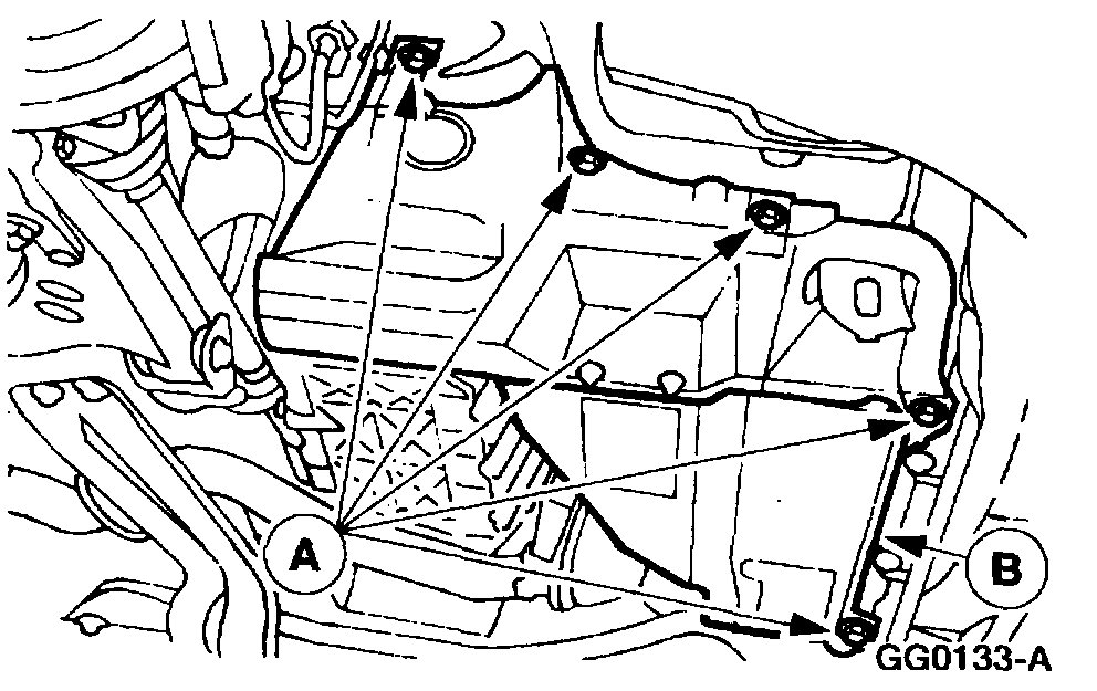

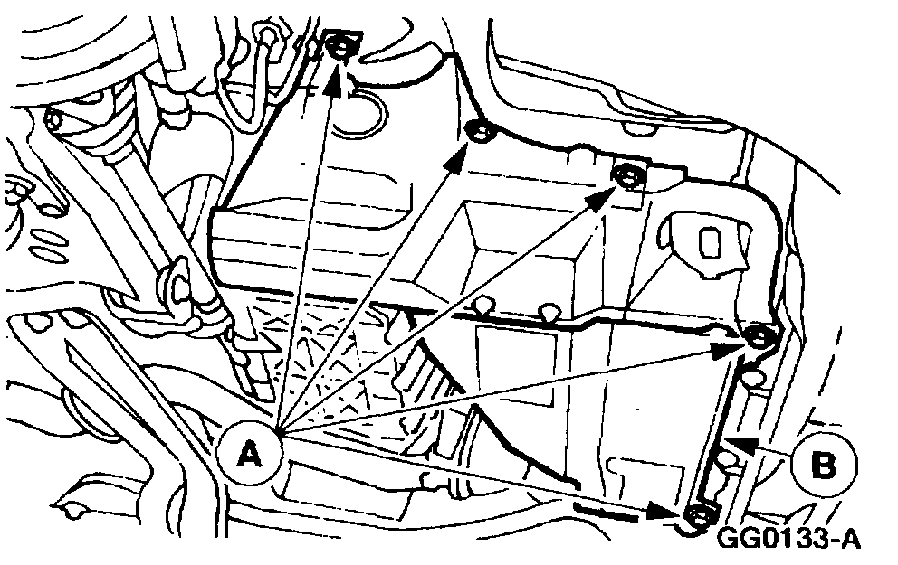

3. Raise and support the vehicle.

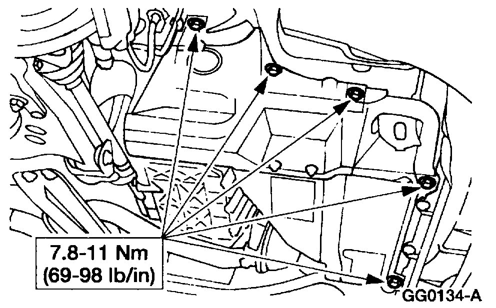

pic 5
4. Remove the (A) six bolts and the (B) RH lower splash shield.

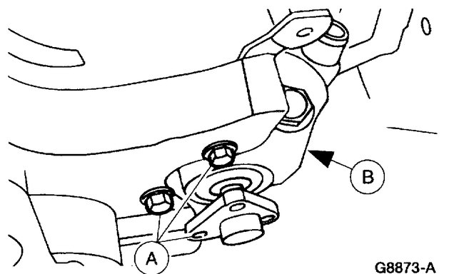

pic 6
5. Disconnect the power steering pressure hose.
6. Lower the vehicle.

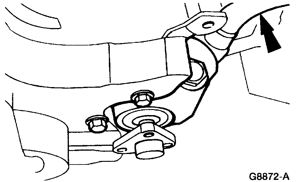

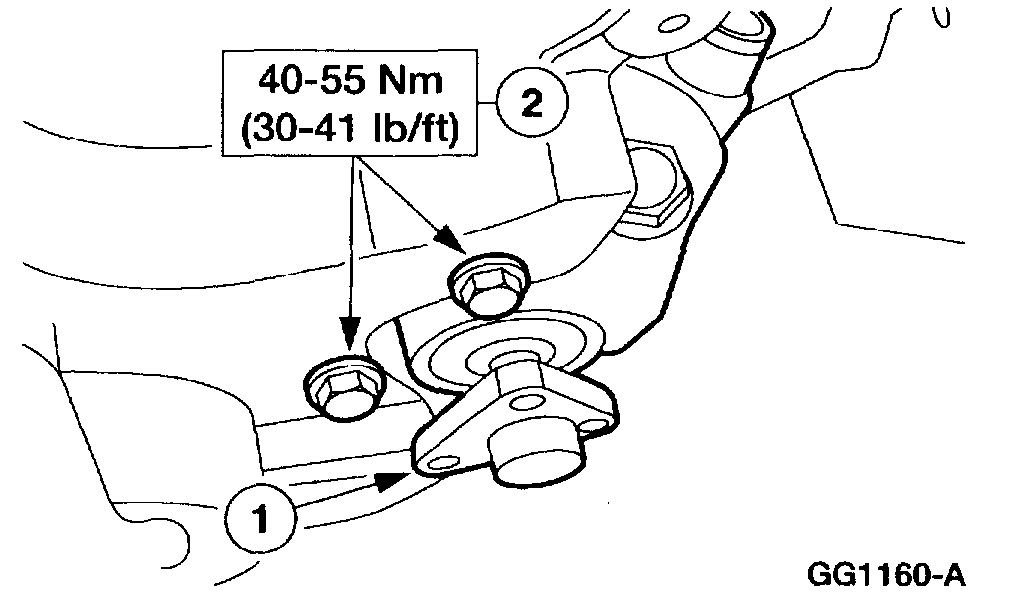

pic 7
7. Loosen the clamp and disconnect the power steering pump reservoir to pump hose.
pic 8
8. Remove the (A) three bolts and remove the (B) power steering pump.

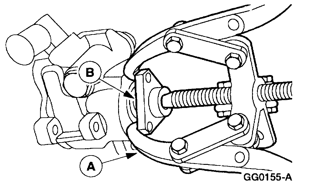

pic 9

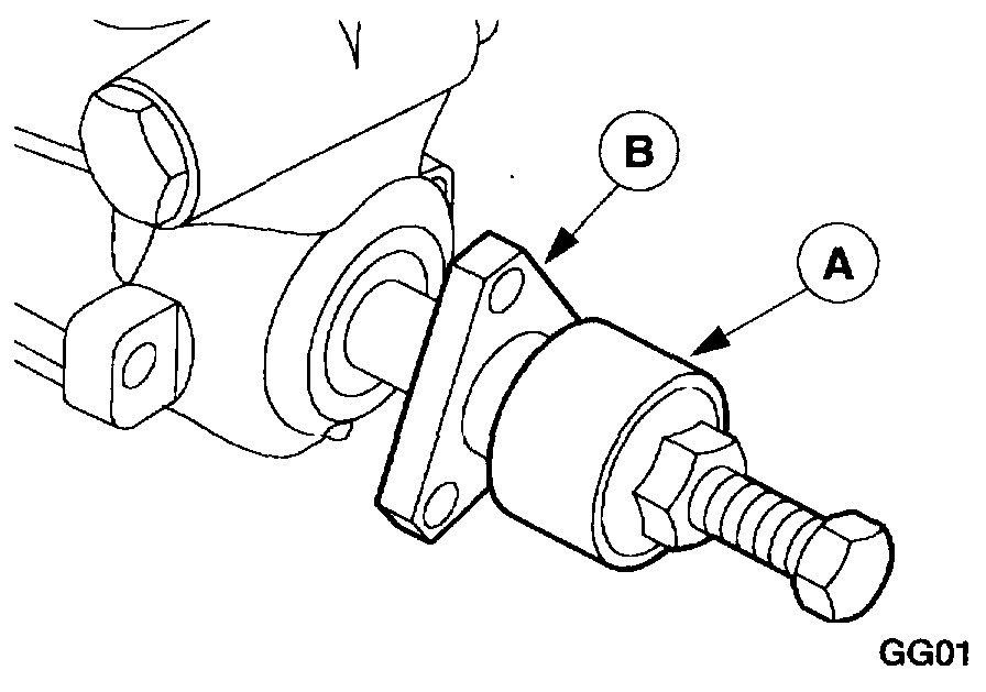

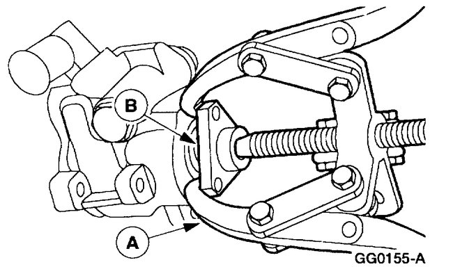

9. Use (A) Pulley Remover to remove the (B) power steering pump pulley hub, if necessary.
Installation
pic 10
1. Use (A) Power Steering Pump Pulley Replacer to install the (B) power steering pump pulley hub, if necessary.

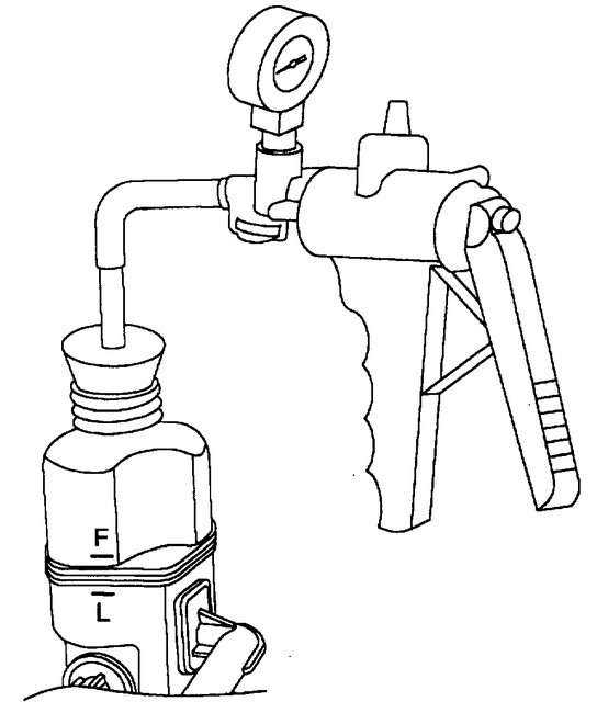

Remove the power steering pump reservoir cap. Check the fluid.
^ Use Motorcraft MERCON Multipurpose ATF XT-2-QDX or equivalent MERCON fluid.

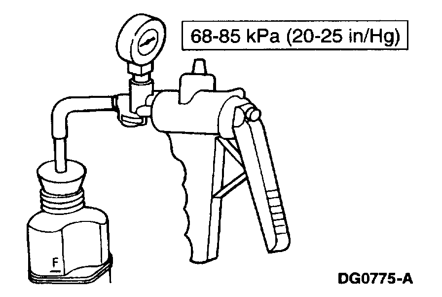

pic 15
2. Tightly insert the stopper of the vacuum pump into the reservoir.
3. Start the vehicle.

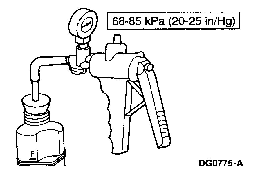

pic 16
4. Apply maximum vacuum and maintain it for a minimum of three minutes with the engine speed at idle.
5. Release the vacuum and remove the vacuum pump.
pic 17
6. CAUTION: Do not overfill the reservoir.
Fill the reservoir.
^ Use Motorcraft MERCON Multipurpose ATF XT-2-QDX or MERCON equivalent.
pic 18
7. Reinstall the vacuum pump. Apply and maintain maximum vacuum.
pic 19

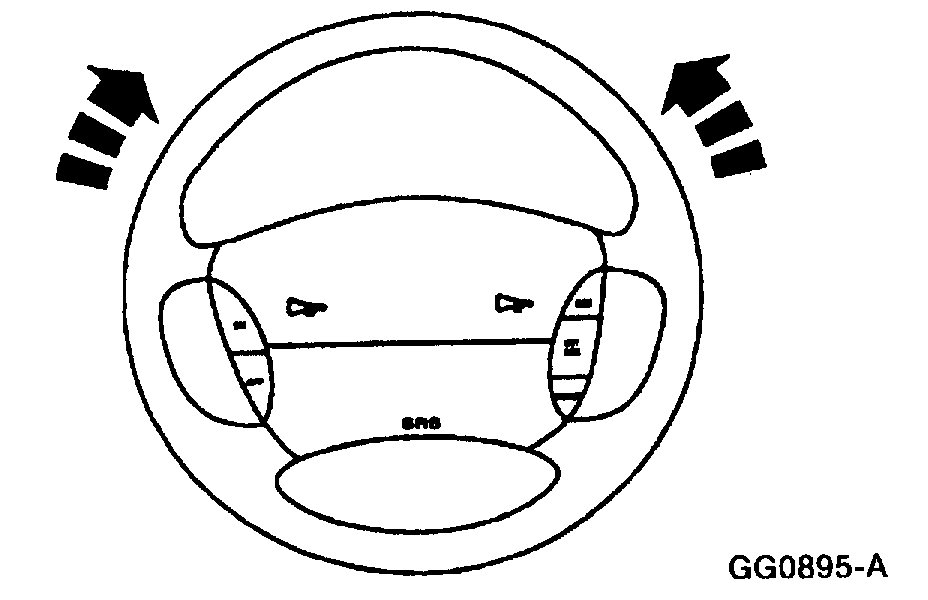

8. CAUTION: Do not hold the steering wheel against the stops for more than three to five seconds at a time. Damage to the power steering pump could occur.
Cycle the steering wheel fully to the left and right every 30 seconds for approximately five minutes.
