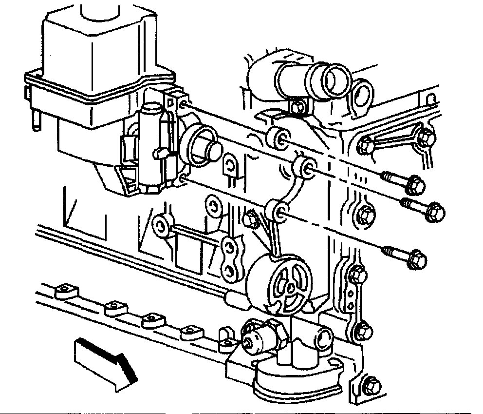

When changing out the power steering pump with a new one what other parts would need to be replace besides the power steering pump?
Jan 12, 2019 at 5:50 AM
  • 110,244 POSTS
If the pump is the only part that is bad, you shouldn't need anything else except power steering fluid. Since the serpentine belt will be off to remove the pump, confirm it is in good condition because now will be the time to replace it if needed.
Here are the directions for pump replacement. The attached pictures correlate with the directions.
___________________________________________
POWER STEERING PUMP REPLACEMENT
Power Steering Pump-Replacement
Removal Procedure
1. Remove the radiator air intake baffle.
2. Remove the air cleaner assembly.
See Pic 1

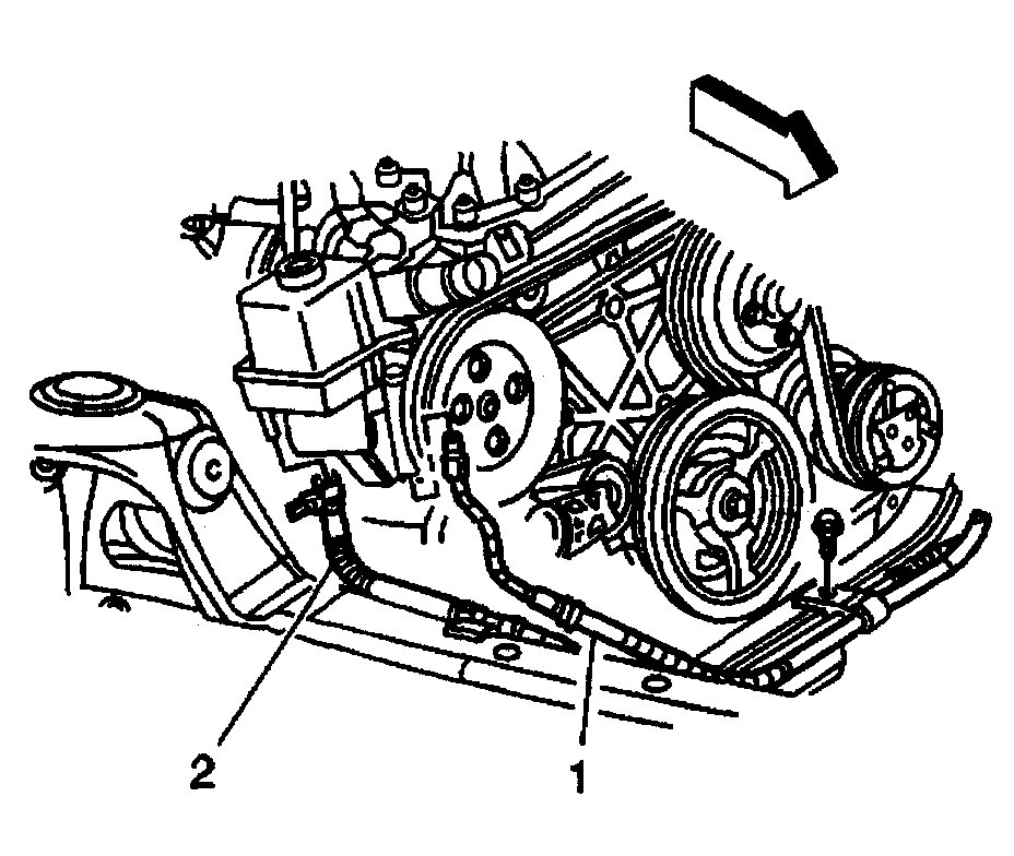

3. Remove the drive belt.
4. Install a drain pan under the vehicle.
5. Disconnect the power steering pressure hose (1) from the power steering pump.
6. Disconnect the power steering cooler hose (2) from the power steering pump.
7. Disconnect the wiring harness from the wiring loom on the power steering pump.
See Pic 2
8. Remove the power steering pump mounting bolts.
9. Remove the power steering pump.

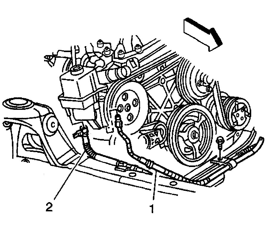

10. Remove the power steering pump pulley.
Installation Procedure
1. Install the power steering pump pulley.
Notice: Refer to Fastener Notice in Service Precautions.
See Pic 3
2. Install the power steering pump.

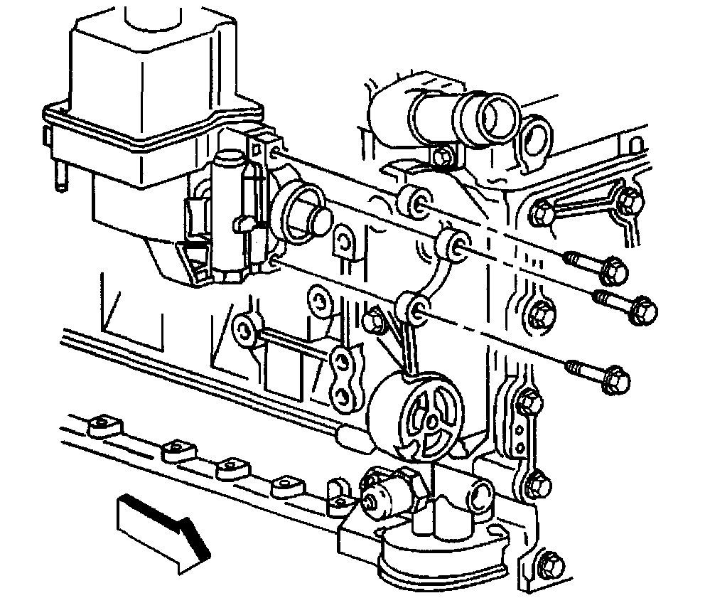

3. Install the power steering pump mounting bolts.
Tighten the power steering pump mounting bolts to 25 Nm (18 ft. lbs.).
See Pic 4
4. Install the power steering cooler hose (2) to the power steering pump.
5. Install the power steering pressure hose (1) to the power steering pump.
Tighten the power steering pressure hose to 25 Nm (18 ft. lbs.).
6. Remove the drain pan from under the vehicle.
7. Install me drive belt.
8. Install the air cleaner assembly.
9. Install the radiator air intake baffle.
10. Bleed the power steering system.
11. Inspect the power steering system for leaks and the hoses for clearance away from the frame and other components.

I will hold on to these steps for sure. but i will be putting on a brand new power steering pump is there any other parts i will need to buy like pulley? line hose, seals and racks?
Jan 12, 2019 at 6:39 AM
  • 110,244 POSTS
Hi:
The pulley is removable from the old one. You will need a special puller that most parts stores will lend or rent to you. However, if the pump is new, it should already have one installed. You will have to check the pump when you get it. If there are no leaks and everything appears to be in good condition, then you should be fine. There is an o-ring on the high pressure line that goes to the pump that you should replace, but if the old one is good, it should still be fine.
Honestly, the old pump comes out and the new one is installed. If there are no prior issues, you should be fine. Again, if the new pump doesn't come with the pulley, you will need to get a puller to remove the pulley from the old pump and install it on the new one.
At any time, feel free to get in touch with me if you run into trouble.
