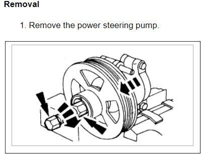

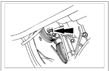

I would like to know how to access the power steering pump for removal/replacement please.
Mar 31, 2018 at 12:13 PM
  • 55,433 POSTS

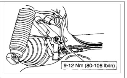

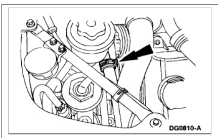

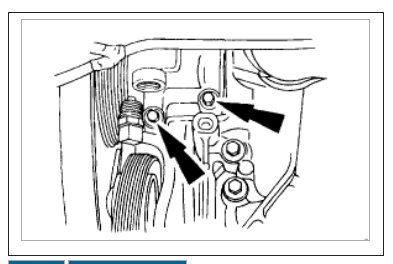

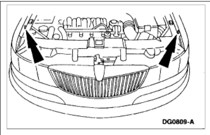

Yep we can help you will that. Here is a guide to help you see what you are in for when doing the job.
https://www.2carpros.com/articles/how-to-replace-a-power-steering-pump

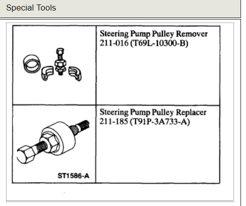

Here is how to remove the pulley.
https://youtu.be/MtHG4y_rdMI
Here is what it will be like for your car (below).
