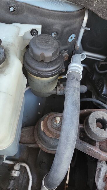

My car got stuck in the snow. Eventually managed to push it out with a bunch of friends. But seems like I fried the power steering pump in the process. Didn't have a problem before. Maybe a very slow leak. Dead now. With slight whine every second or so. Quick short noise that's presumably from it. Hear it even at idle without cranking the wheel. Definitely dead? Anything to try first? Fluid was low. Must have been low before. Topped it off but didn't fix it. Was at the low mark. Not below that. If I have to replace it do you have the repair procedures for it?

I would make sure the serpentine belt is in good shape first. If it is missing the power steering will not work. When the engine is running can you remove the power steering pump cap to see if the fluid is circulating? If not the pump has gone bad which is why the system is not working. Let me know what you find. Please upload a short video in your response of the problem, so I can see what's going on.

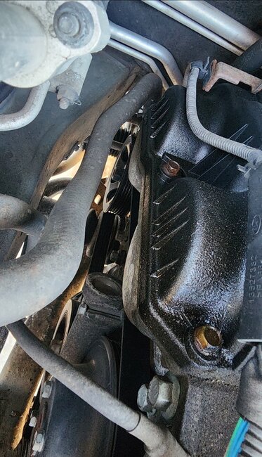

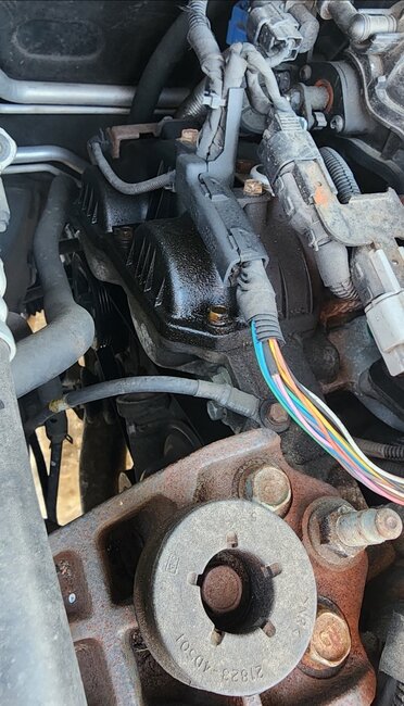

Belt looks fine. I'd maybe replace it at the same time because why not but looks OK. Car is driving fine otherwise so definitely not a belt issue. Don't love the reservoir design. Can't see for sure if the fluid is circulating. I see in the last picture on the right side some engine part is oily. What's that?

The oily part looks like the valve cover so no worries there. Chances are when you when into the snow to jammed the rack and pinion and it needs to be replaced if you can see circulation inside the reservoir with the engine running. Thanks for the images, they help, if you are unsure of the fluid movement remove the cap and get a video of the fluid when the engine is running so I can see.

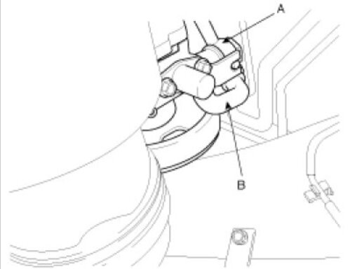

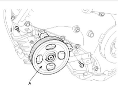

It does not look to bad to remove the pump, first disconnect the battery, then remove the drive belt. Then the pressure and return lines and the mounting bolts for the pump and you should be able to get it out of there. Check out the images (below). Please let us know what happens.

Any idea if I have to go from the bottom? That's what I was trying to figure out. Might have to go behind the wheel or something.
Feb 2, 2026 at 9:45 AM
  • 54,832 POSTS
Yes, remove the passenger side tire and possibly the inner wheel well plastic. This makes it much easier.
