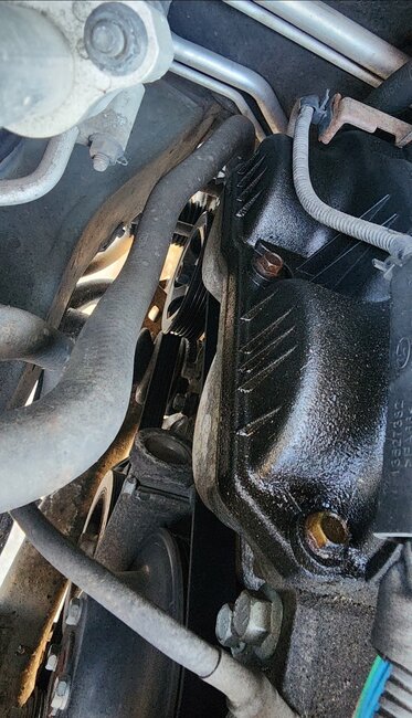

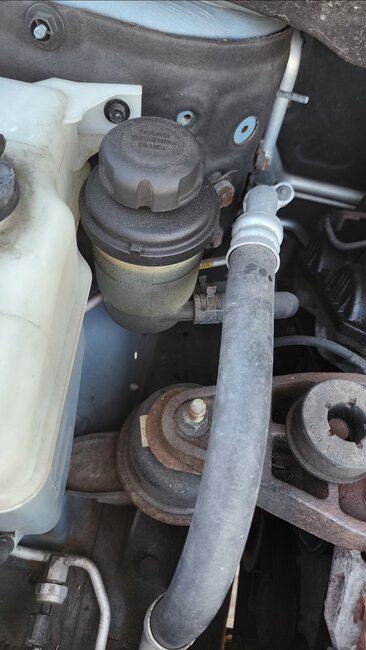

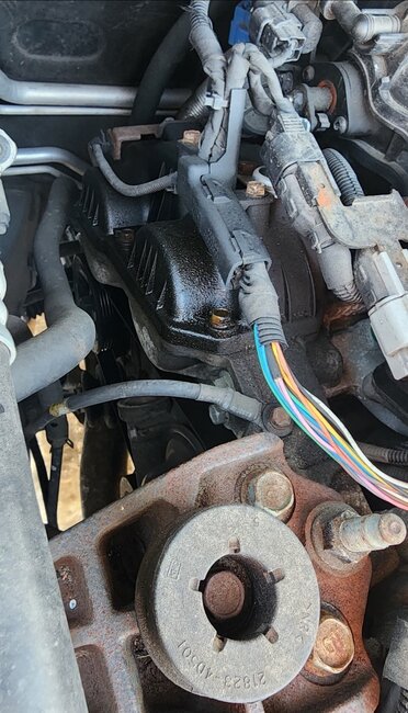

Belt looks fine. I'd maybe replace it at the same time because why not but looks OK. Car is driving fine otherwise so definitely not a belt issue. Don't love the reservoir design. Can't see for sure if the fluid is circulating. I see in the last picture on the right side some engine part is oily. What's that?
Jan 29, 2026 at 10:36 PM
  • 55,433 POSTS
The oily part looks like the valve cover so no worries there. Chances are when you when into the snow to jammed the rack and pinion and it needs to be replaced if you can see circulation inside the reservoir with the engine running. Thanks for the images, they help, if you are unsure of the fluid movement remove the cap and get a video of the fluid when the engine is running so I can see.

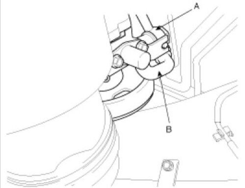

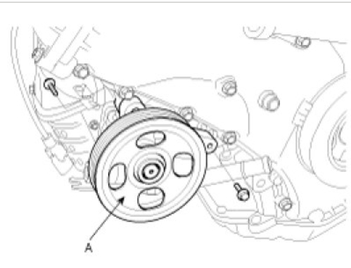

Only way to tell for sure is if I see fluid circulating in the reservoir? Assuming it's the pump what's the replacement procedure for this car?
Feb 1, 2026 at 10:23 PM
  • 55,433 POSTS
It does not look to bad to remove the pump, first disconnect the battery, then remove the drive belt. Then the pressure and return lines and the mounting bolts for the pump and you should be able to get it out of there. Check out the images (below). Please let us know what happens.
Feb 2, 2026 at 1:17 AM
EZEX
  • 53 POSTS
Any idea if I have to go from the bottom? That's what I was trying to figure out. Might have to go behind the wheel or something.
Feb 2, 2026 at 1:45 AM
  • 55,433 POSTS
Yes, remove the passenger side tire and possibly the inner wheel well plastic. This makes it much easier.
