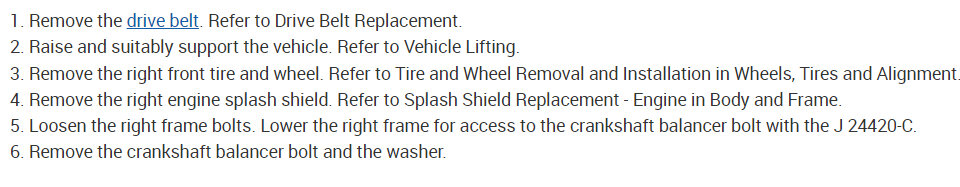

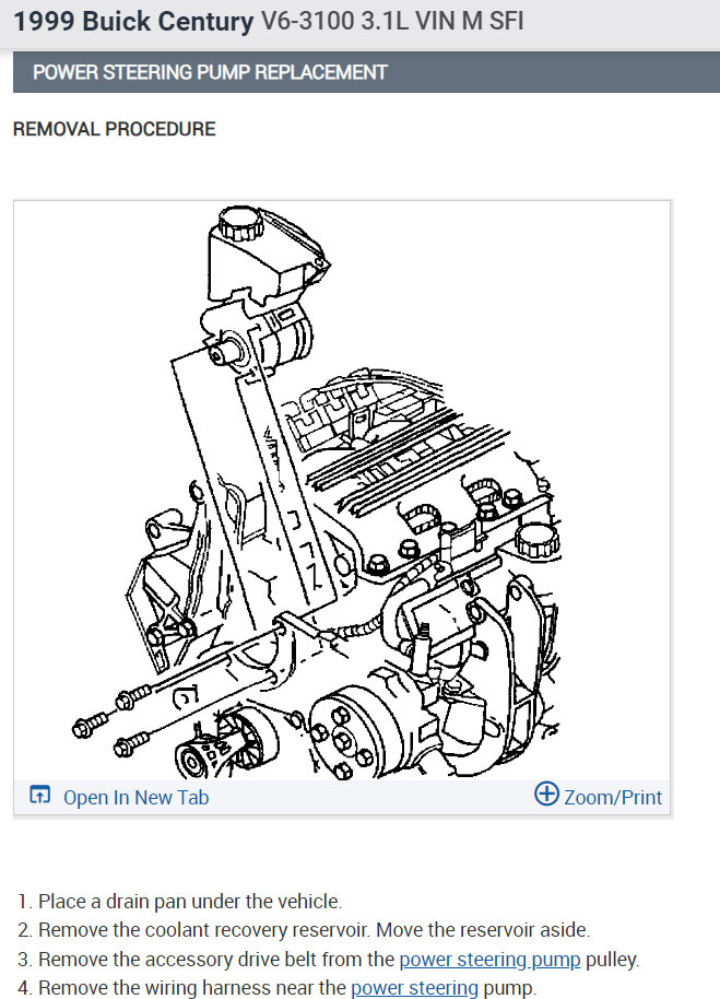

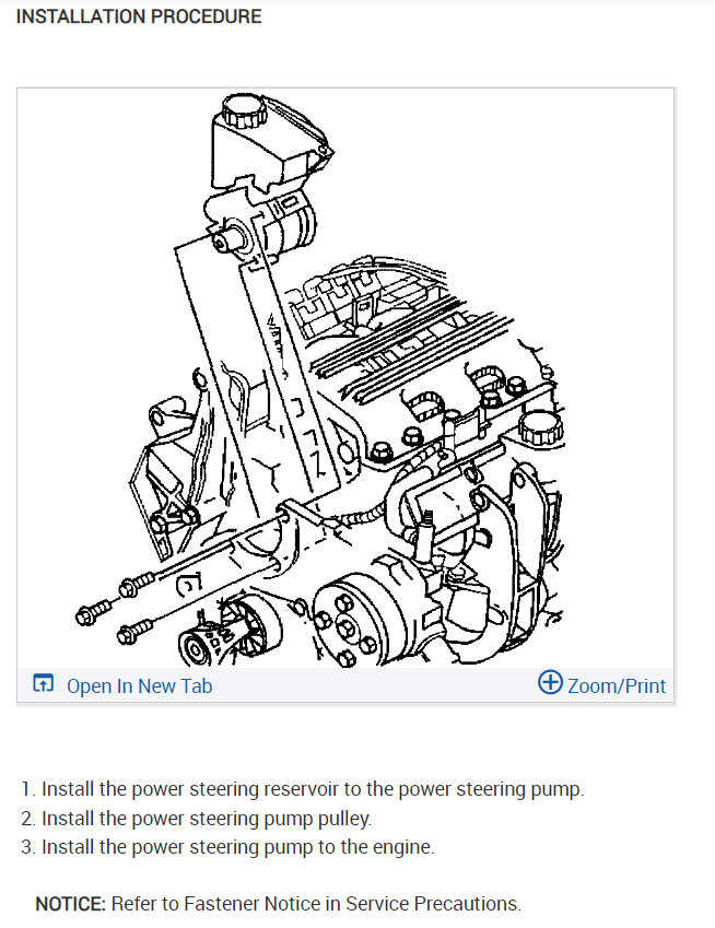

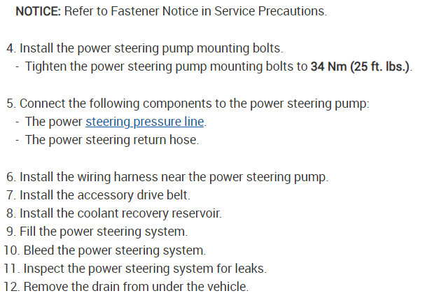

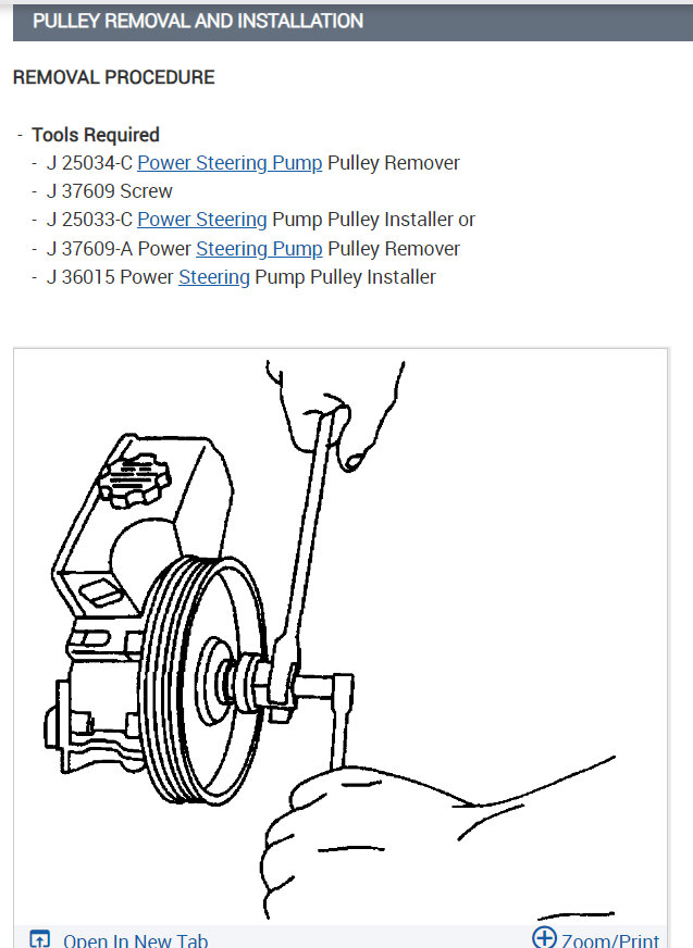

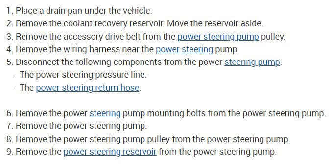

Hello. I need the step by step on replacing the power steering pump and swapping the pulley from the old pump to the new one.
Background: power steering is non-existent when sitting still with the engine idling, or even revving it. It takes most of my upper body strength to turn it. There is no whining noise, and the fluid appears fine. This all started at the drop of a hat, and not over time. I'm thinking that a pressure controller inside the pump has failed.
Dec 1, 2023 at 10:55 PM
  • 55,743 POSTS

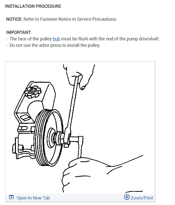

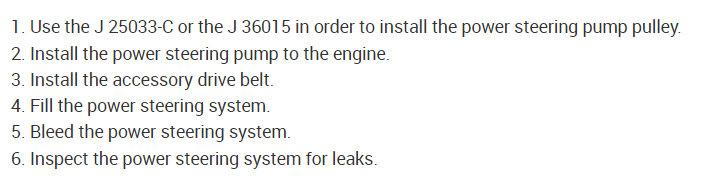

Yep, it sounds like the pump is bad. here is a generic guide to help you step by step with instructions in the diagrams below to show you how on your car:
https://www.2carpros.com/articles/how-to-replace-a-power-steering-pump
This video will help you remove and install the pump pulley:
https://youtu.be/MtHG4y_rdMI?si=1R5rF30vAraPpDzq
Here are the instructions for your car. Check out the images (below). Let us know if you need anything else.

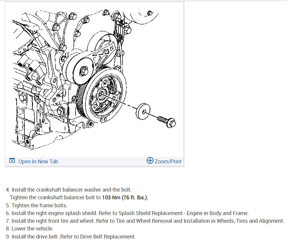

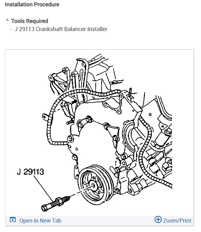

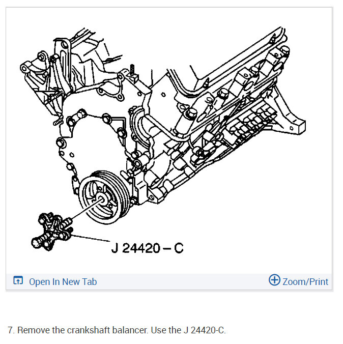

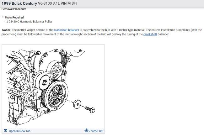

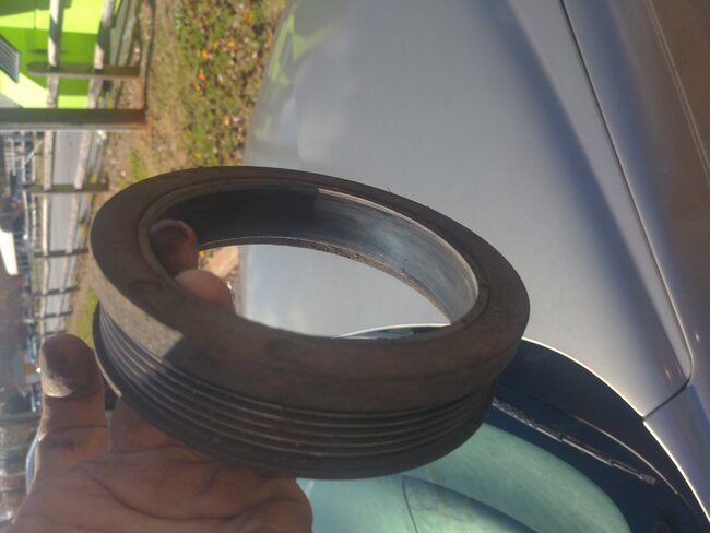

Well, I started the job. Pulled the belt off. And this fell off of the crank pulley. That's a new one by me ..
Dec 6, 2023 at 12:45 AM
  • 55,743 POSTS
Yep, I have seen this before, the balancer comes apart and it causes the belt not to be driven. Good job finding the problem. Here are the instructions on how to change the balancer out and this video can help as well:
https://youtu.be/WITN7Q8SX1U?si=8ItDxvmndpuTZlVe
I like to heat up the balancer before installation which can make the installation easier. Check out the images (below). Let us know if you need anything else.
