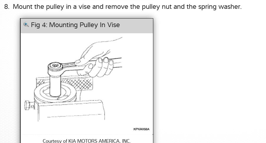

Power steering pump pulley type.
41,000 MILES • 1.6L • 4 CYL • AUTOMATIC
KEEGANJDAVIS
  • 10 POSTS
I am replacing my power steering pump, and I want to make sure before I purchase the parts, is the power steering pulley press on? Will I need a pulley tool to put the new pulley on the pump?
Apr 7, 2016 at 2:09 AM
HMAC300
  • 48,601 POSTS
no it unbolts and comes off e careful putting it in vise like pic so you don't bend pulley
