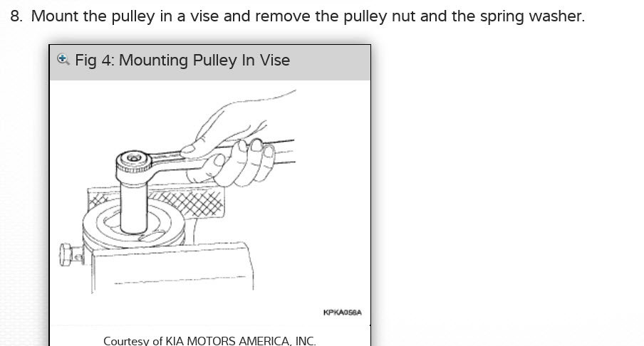

I am replacing my power steering pump, and I want to make sure before I purchase the parts, is the power steering pulley press on? Will I need a pulley tool to put the new pulley on the pump?

no it unbolts and comes off e careful putting it in vise like pic so you don't bend pulley
