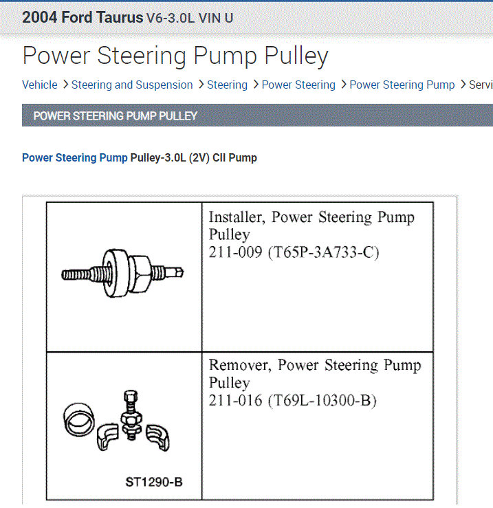

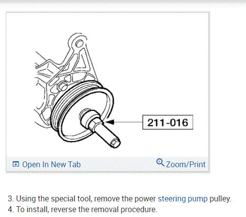

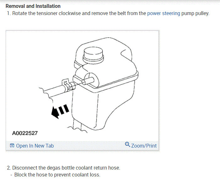

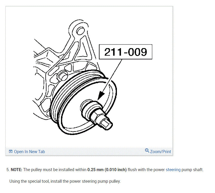

Removal of the power steering pump pulley will require specialized tooling. Oftentimes, a parts store will lend you what is needed. This video shows the job being done on a similar car but the process is the same.
https://youtu.be/MtHG4y_rdMI
To get you started, here is a link that shows in general how it is done:
https://www.2carpros.com/articles/remove-reinstall-power-steering-pulley
If you look at the attached pics, they include the directions specific to your vehicle for pulley removal.
See pic below.
