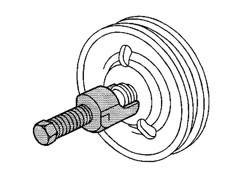

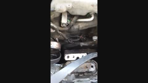

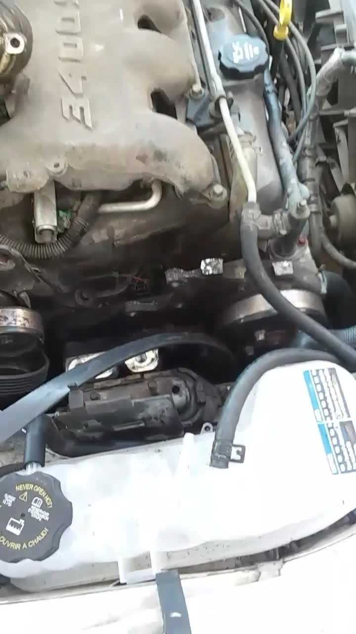

power steering pump pulley completely shredded off from the middle ring it can come off completely.
Jun 20, 2019 at 6:33 AM
Good afternoon,
Can you post a picture for me to view?

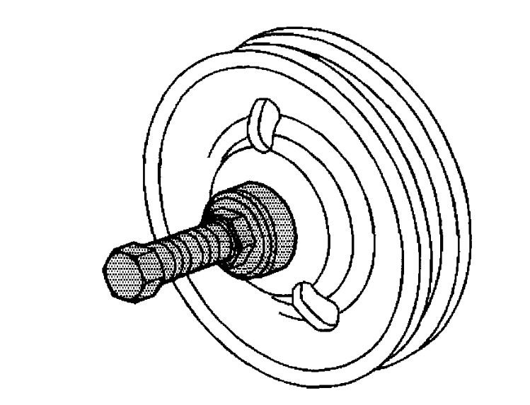

I posted the tools required below and a picture for you.
^ Tools Required
- J 25033-C Power Steering Pulley Installer
- J 25034-C Power Steering Pulley Remover

I think I just need the puller/remover kit. but the problem is I'm low on funds and can't put down the deposit for loan-a-tool at AutoZone. is there any other way to do this without the kit?
Jun 20, 2019 at 8:37 AM
Not without damaging the pump itself.
Maybe you could take the pump to a parts store and have them do it there for you.
Jun 20, 2019 at 8:46 AM
JIMMY SMITH
  • 5 POSTS
well now I have to take apart all the connected stuff right and the fluid what about that? what do I do with that?
Jun 20, 2019 at 9:07 AM
JIMMY SMITH
  • 5 POSTS
I do not know how to do either of those.
Remove the two lines attached to the pump to free it from the lines.
Jun 20, 2019 at 9:25 AM
JIMMY SMITH
  • 5 POSTS
it won't leak out or it will the fluid.
Jun 20, 2019 at 9:45 AM
Yes. All the fluid will come out.
