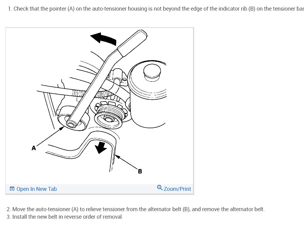

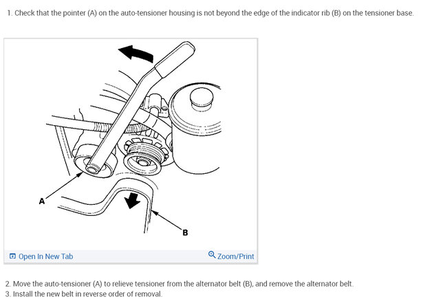

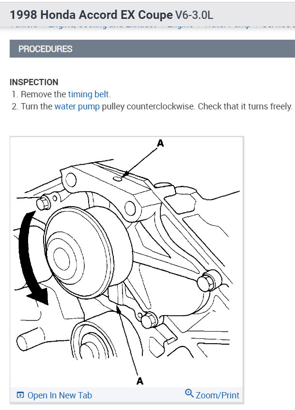

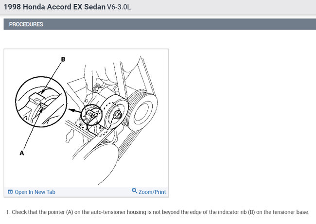

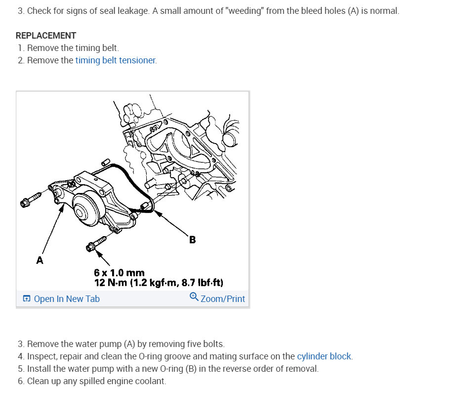

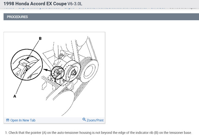

You could be correct; I have seen the water pump go out and cause this noise. Can you please shoot a quick video with your phone so I can hear the noise? That way I can tell for sure what's going on. You can upload it here with your response. To be sure the noise is being caused by something outside the engine please remove the serpentine belt and start the engine for a brief time (30 seconds) to see if the noise is gone, this will help us go in the right direction. Check out the images (below). Please let us know how it goes.

Thanks for the video. I would remove the belt and start the engine to see if the noise is still there because it sounds like the timing belt tension is bad or the belt is loose and hitting the timing belt cover. Or it could be the pump itself due to low fluid/leak. Let me know so I can help you fix it. Check out the images (below). Please let us know what happens.
