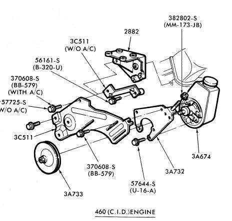

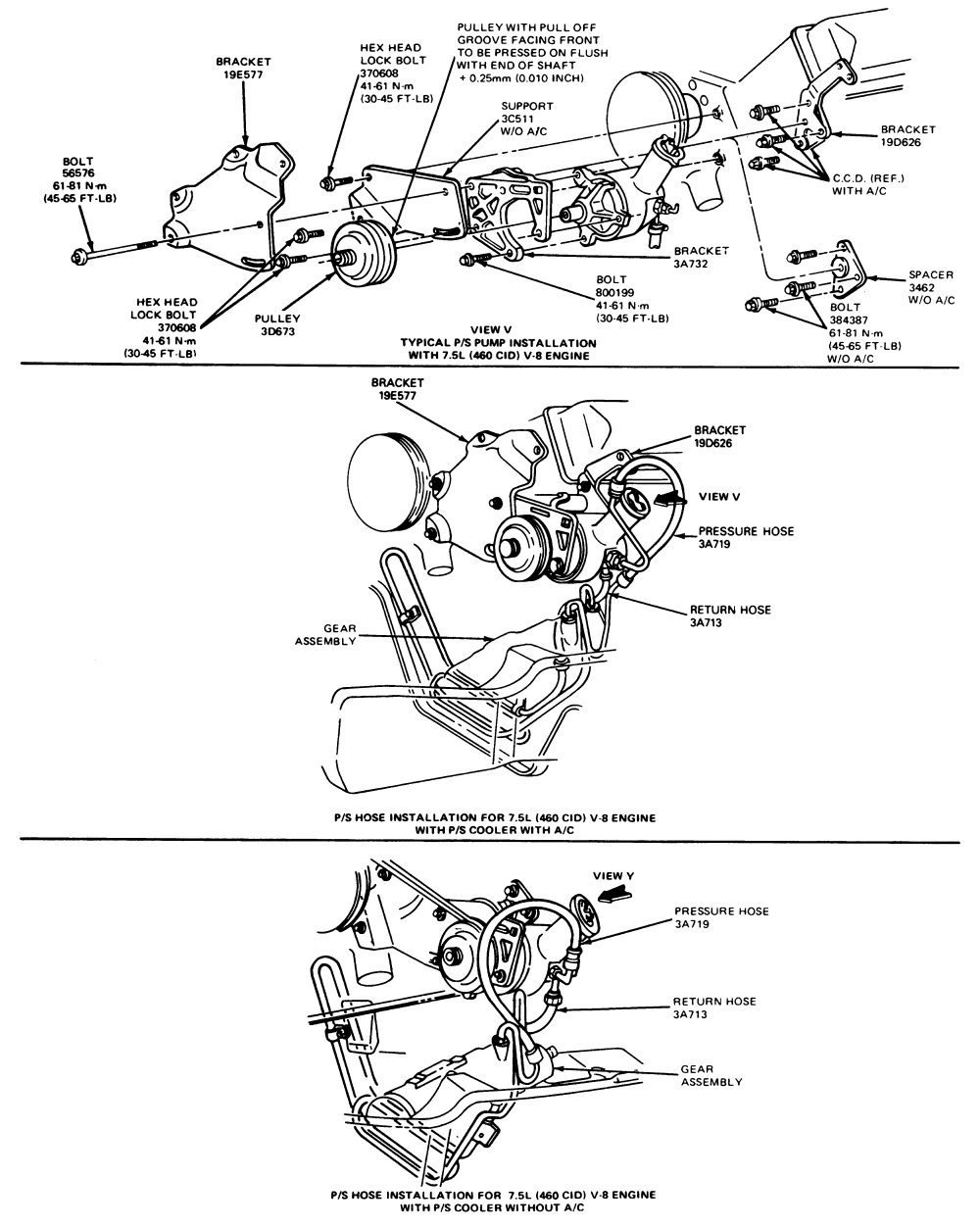

Took it off to repair and can't remember how it goes back on.
Need diagram please.
E350 coachmen motorhome
Dec 12, 2019 at 7:04 AM
STEVE W.
  • 15,394 POSTS
Take a look at this video and pictures and see if yours is set up the same as one of them. Many times the upfitters moved things around on the engines to fit the accessory drives into the places they want them so they don't match the mounting used by the manufacturer. Usually they minimized that on a class C like yours but it's been known to happen.
https://www.youtube.com/watch?v=t1qy83O4t0s
Dec 15, 2019 at 2:07 AM
4X4BYIN
exactly what was needed. thank you
