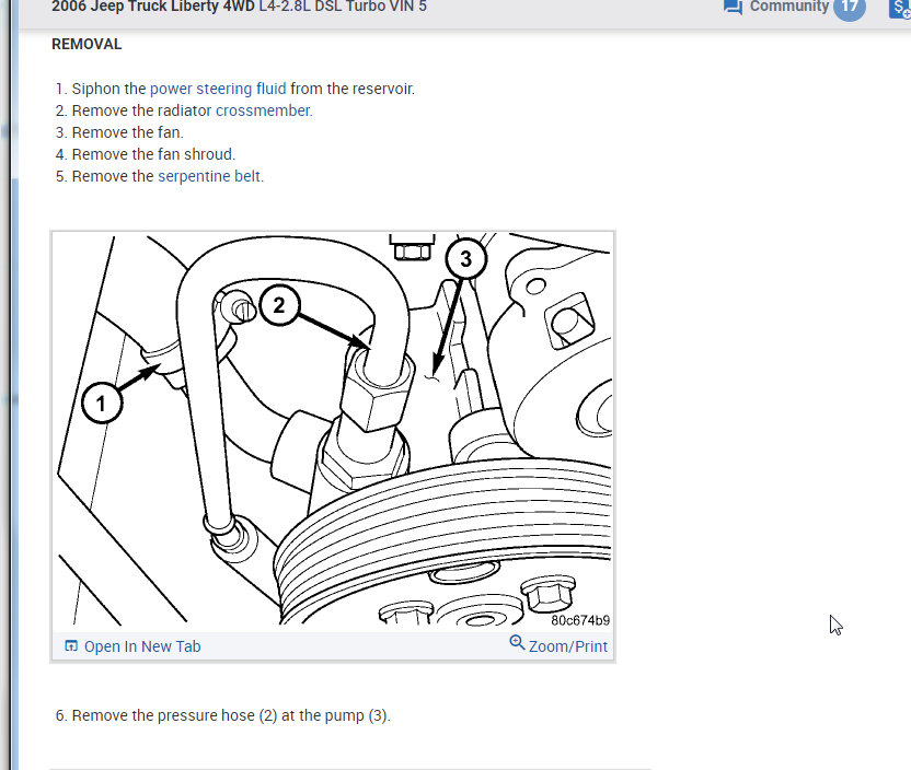

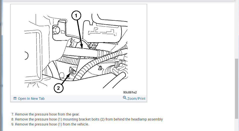

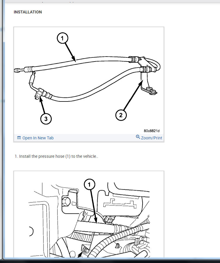

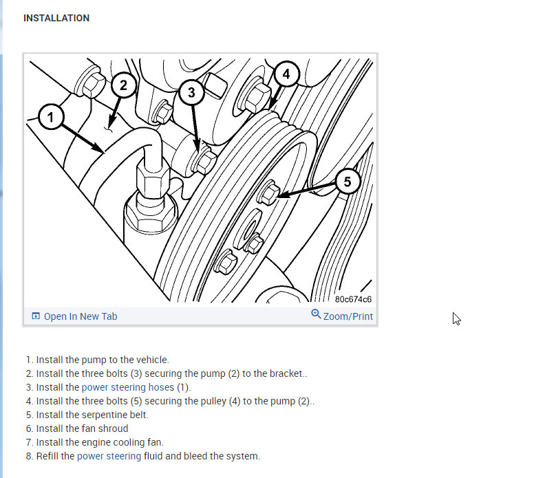

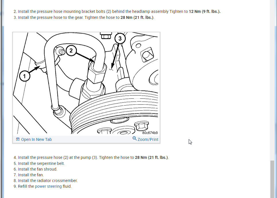

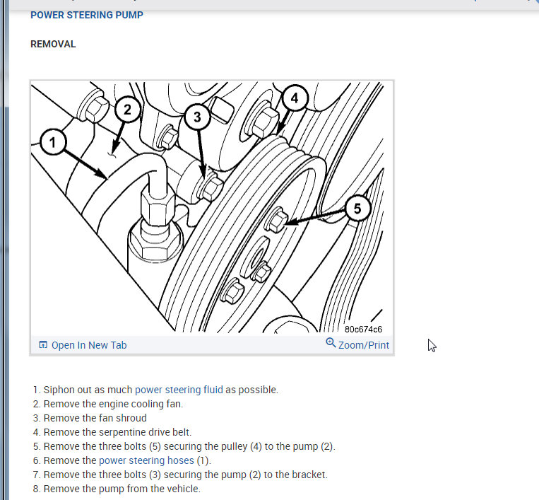

I would suggest having them show you the problem that they find. Clearly this is not the easiest thing to tell you what the issue is without looking at the vehicle but they need to run the vehicle and watch all the lines as you most likely have a split line. If it leaks when it is cold then most likely the line is cold and hard and it allows the fluid to escape out of a crack. If they are not looking at it when it is cold then they may not be finding the crack in the line.
Below is the process from the manual on a pump and the pressure line for your review. Again, I would make sure whatever they find, they show you and if it doesn't make sense then I doubt they are finding the issue.
