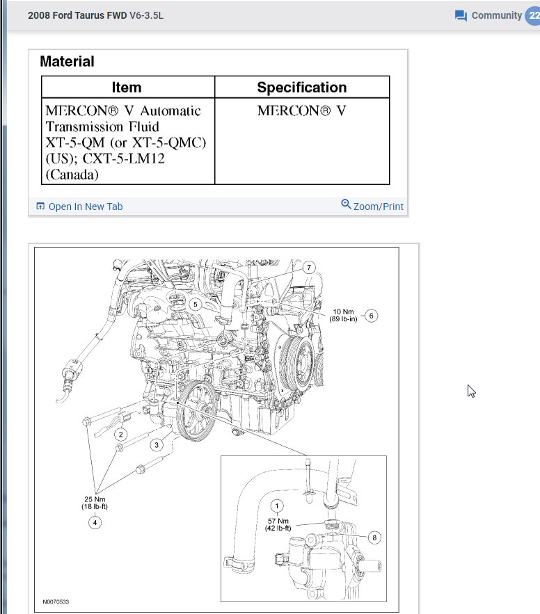

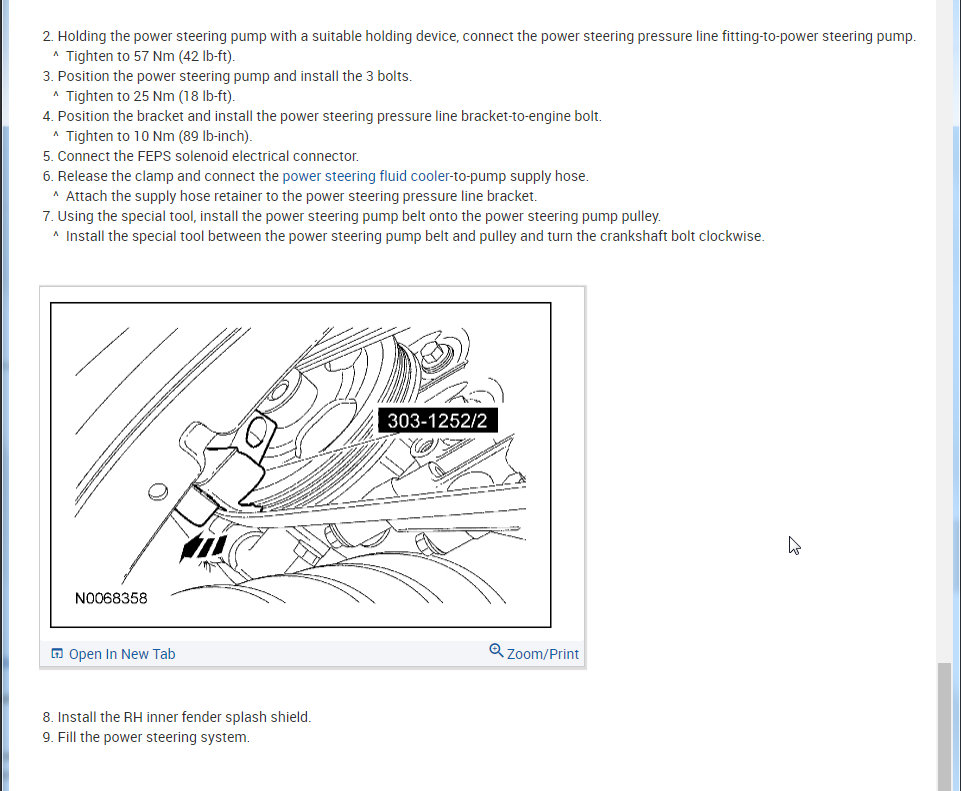

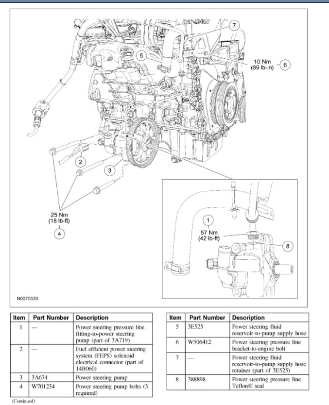

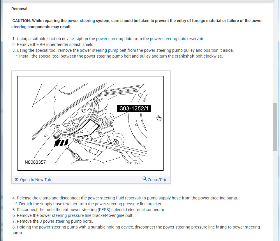

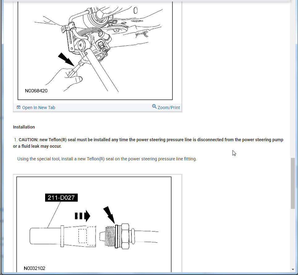

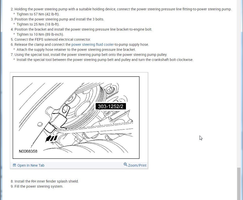

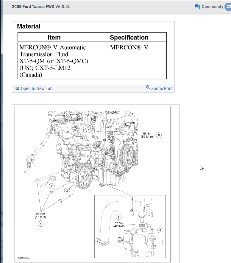

I took car in they fixed the return hose I believe it was from the cooler to the pump but now it’s the pump also. They want another $300.00. So I’m going to pull 1 or buy 1 and do it. Where is it located and can you tell me how to do the process. YouTube Videos are not always accurate and pause and play I just want simple step by step. Maybe a picture or two. Thanks in advance.
Apr 11, 2021 at 4:26 AM
No problem. Here is a guide and a video on how to do this:
https://www.2carpros.com/articles/how-to-replace-a-power-steering-pump
https://youtu.be/C1h8Xl1E8hI
Below you will find the process from the manual on how to replace this for your specific vehicle. Please run through this material and let us know if you have other questions. Thanks
