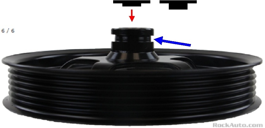

The next issue is you will need a special pulley puller to get the pulley off the old pump. You can find a set of tools at Harbor Freight Tools, but most auto parts stores that rent or borrow tools will have that set. In my city, they make you buy the tools, then you get a full refund when you return it. If you decide to keep a tool, you still return it, then they order or give you a brand new one.

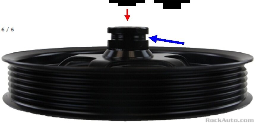

You'll notice there's a collar about an inch and a quarter in diameter around the front of the pulley. Depending on who made the tools, a one or three-piece tool goes around that lip, (blue arrow in my nifty photo), then a bolt is threaded through that tool to push the shaft out of the pulley.
The next issue is when you push the pulley onto the new pump, how far you push it on is critical. 1/16" too much or too little can set up a miserable belt squeal. Rebuilt pumps often come with a bolt that threads into the shaft's center hole, and a nut and washer to run the pulley on. While they do work once or twice, you still need that special tool set to remove the pulley and to pull it back out if you press it on too far.
One way to know the pulley is on the correct depth is to observe the ring of rust inside the pulley's center hole. After pushing the pulley on, remove the tool, then if you see any shiny area showing on the center hole, the pulley has to go on further. You can creep up to the proper depth that way, but you won't know it if you went on too far.
The better way is to use a special spacer to set the depth. I can't find a photo, so I drew two examples in the photo below, (top of photo). You chose the spacer with the depth that matches the old pulley's depth and place that on the pulley just before you attach the pulling tool. They have holes for the pulling bolt to go through. The narrow part of the spacer, (on the bottom in my drawings), hits the end of the shaft when the correct depth is reached. It won't let you push the pulley on too far. Those spacers normally do not come as part of the special tool kit. When I used these at a Chrysler dealership, the replacement pulleys and replacement pumps came with the correct spacer, then we were expected to just throw them away later. I kept them and found there were only two sizes at that time. If the pulley is pressed on flush with the end of the shaft on the old pump, you don't need or use either spacer with the new parts.
If you do go with a used pump, look at how far your pulley is pressed on, then find a pump from the same year and model and check that this pulley is on the same depth. That eliminates the need for the special tools.
I can't tell you the nut size for the pressure hose other than to suggest it's most likely metric. Use a flare-nut wrench, aka Line wrench because these nuts will be very soft. Flare nut wrenches grab the nut in four places instead of two with standard open-end wrenches. I'd expect that nut to be 15 or 17 millimeter, but GM is famous for often using the very uncommon 16 millimeter too.

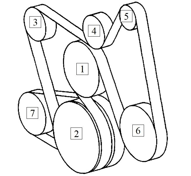

I looked at the belt routing diagram but they couldn't be bothered to label the pullies. My guess is, . . . looking from the front, the power steering belt is on the lower right. I labelled that # 6. If you remove just that, the belt will rub on the upper pulley, # 4. You'd have to bypass pulley number 5. If that is a spring-loaded tensioner pulley, you won't have a way to keep the belt tight. If you go around pulley # 4 in the opposite direction, the ribbed side of the belt will be running on a smooth pulley.
This would be a trial and error job. Unless you can find someone who has already done this, and knows the belt size needed, the best I can suggest is to use a piece of string to get a measurement, then see if the auto parts stores have something. They normally go by application, not size, but they might have listings in their books for which part number is what size.

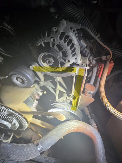

2 is fan. 3 is tension pulley. 4 is idle pulley i guess. Its a free pulley it seems. 5 is alternator. 6 is power steering pump. My concern of replacing it with a used one is that it seems to be more to it than just bolt the old one iff and slapping a new one on. The gear ratio stuff and all that confuses me. All I saw was one metal metal going to it for fluid. When shopping for part, it asked me if it was a gear box or rack I have no idea what that means. I did get the GM part number but a new one is $450. The truck isnt worth alot. I also have to get it pressed in I believe. I dint know what to do

I understand that but there is a brace between the pulley and pump

I've never done this on a GM truck, so hopefully Steve can be of help, but I do know on many Ford models, the pump's shaft goes through an aluminum mounting bracket, then the pulley is pressed on. Dandy design, which Ford is known for, that makes replacing the pump very difficult and requires the special tools, even if you want to get one from a salvage yard.

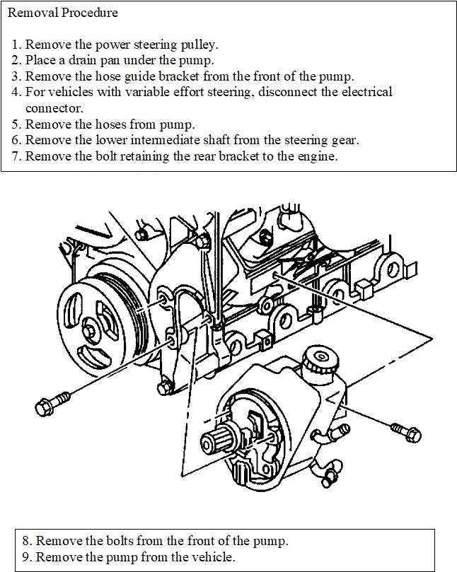

Steve, can you explain to me, step # 6 in the instructions I posted earlier says to remove the intermediate shaft to the steering gear. Why is that necessary? Next, they say to remove the pulley, like I described has to be done on Fords. From the drawings, that doesn't appear to be necessary either. Have you ever done one of these?
As for the type of steering on this truck, both are listed in the parts list on Rock Auto, so both were available, possibly different between 2wd and 4wd. For many years trucks only had the "recirculating ball", or common steering gear box. I posted photos below. That gear box is on top, looking down on the top of it as you'd see it under the hood. A picture of the rack and pinion steering gear is at the bottom. The two parts are not in scale. The top gear box is much smaller and very much heavier.

Being a 2WD it may have a rack in it, really depends on the option package but the description of still steering OK without power assist would make me bet it's a rack, RB boxes without power generally steer like you are trying to unscrew a tree out of the ground. GM started doing the same as Ford about when they came out with the new front accessory drive plates on the new LS design. GM tells you to remove the intermediate shaft because the rear brace on the pump bolts to the block behind it, it can usually be removed without taking the shaft out but it's tight. The pulley removal is a piece of cake with a removal tool. Takes longer to type that out than it takes to remove the pulley. The tool is available as a rental at most part stores. This is the same pulley and process, https://www.youtube.com/watch?v=MtHG4y_rdMI
If you have never touched a wrench before it will take roughly 3 hours to change it, if you know what you are doing you can easily take an hour off that time. The worst part is usually bleeding out the air.
From your description I agree with Doc, the pump shaft broke when the pump locked up internally. The jolt snapped the belt. Replace the pump and you should be good to go.

On the diagram of yesterday's post I meant to say that #1 pulley is thr fan and #2 is the water pump. I believe that's right

While you can remove it with the mount you will need to remove a lot more parts than just removing the pulley and dropping the pump out.

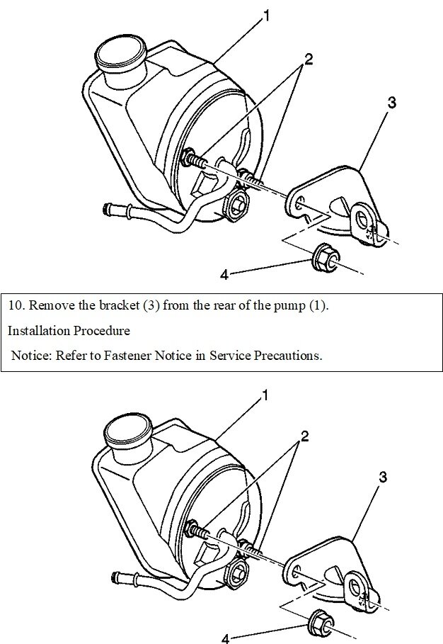

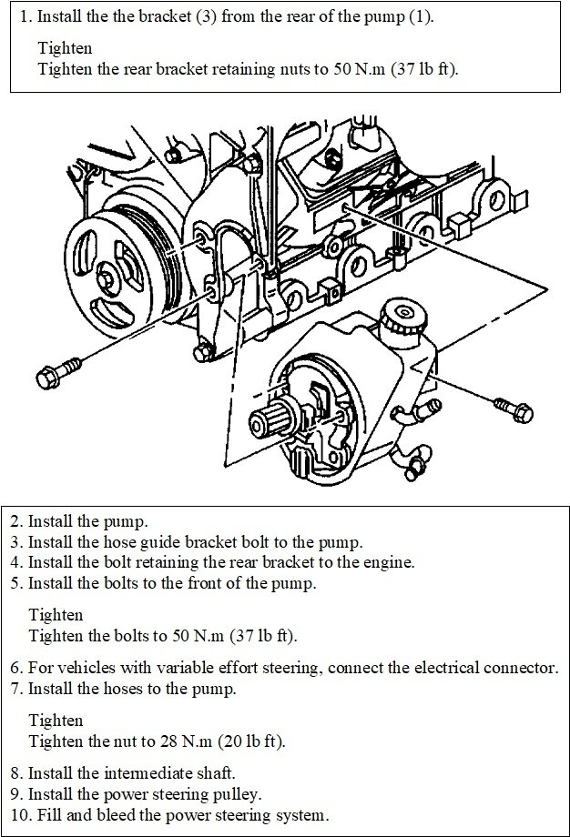

There are 3 bolts in the front and the one in the rear bracket. Then you swap the rear bracket to the new pump. The torx is machined in the center of the shaft, doesn't get removed. The puller nose sets on it. Then when you install the pulley the stud screws into the threads inside the torx area.

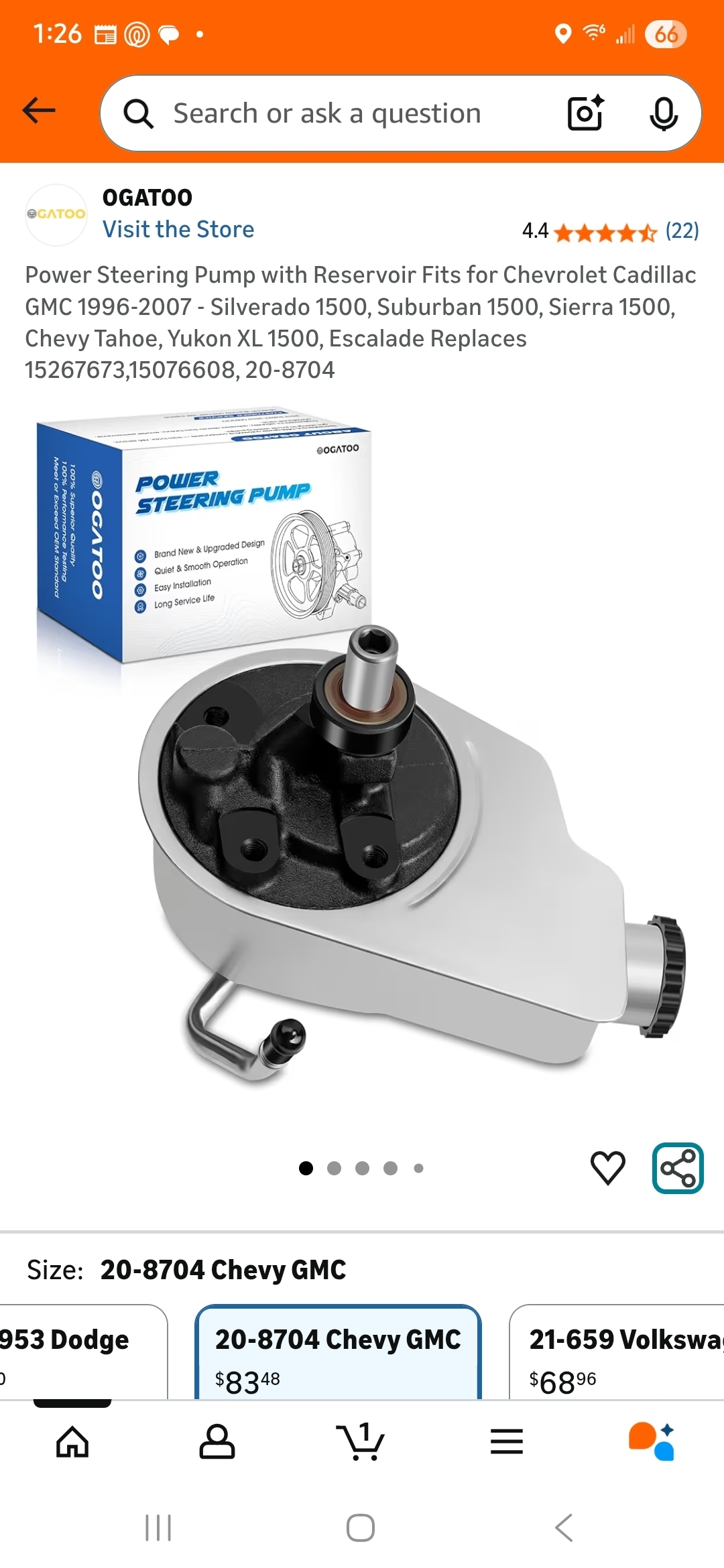

This part off of Amazon shows that it will fit my vehicle because it has the same part number as mine and it's a lot more cheaper than the $385 one. I just wanted to make sure that it would get the job done.

I generally do not use parts that are online only, and far cheaper than all the other parts stores. Far too many people have discovered that they got junk parts. However it's your choice. Did you look on Rock Auto? They show the OE for 300 but a lot of other options for half that price.

No I did not I will take a look at that

Even a remanufactured OE part is likely better than any of the low end parts. With how bad the new parts have been getting these days I'll go to a salvage yard before I use some of them. Took me three new alternators before I found one that actually worked. Even then it failed in 2 months. Went and got a used one from a yard and installed it, working as it should without any issues. Talk to any shop and you will hear the same thing. So I try to use new OE first, Reman OE second, used OE third and aftermarket only if I cannot find one in the first three. There are a few exceptions, like the oil cooler and water housings on the pentastars, the aluminum aftermarket units seem to hold up much better than the plastic pieces.
