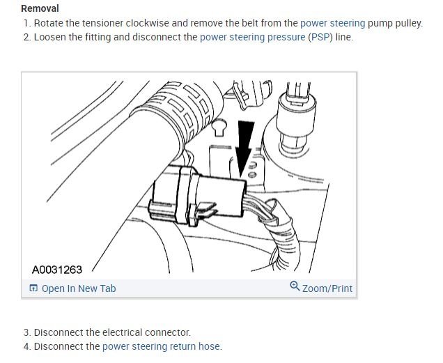

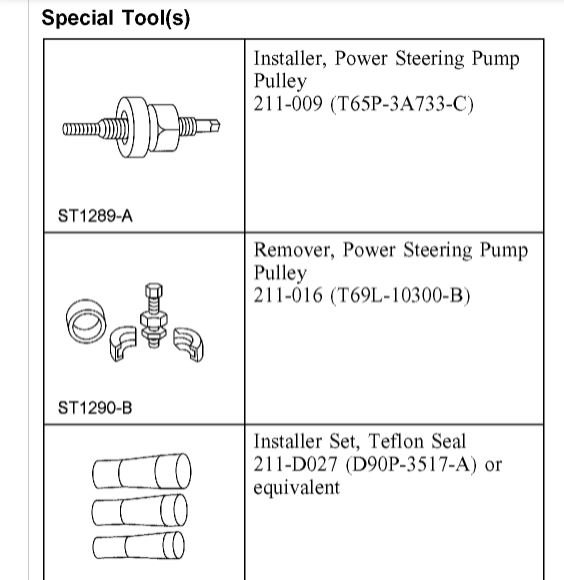

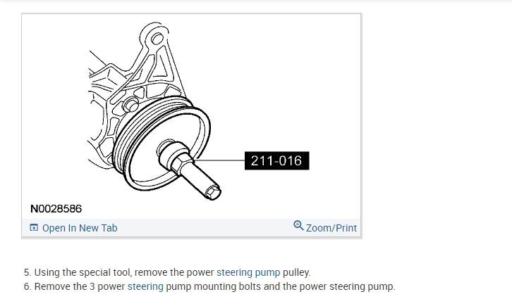

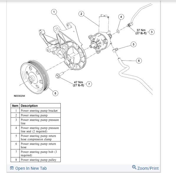

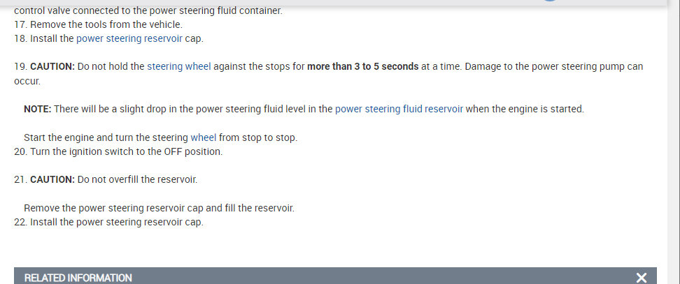

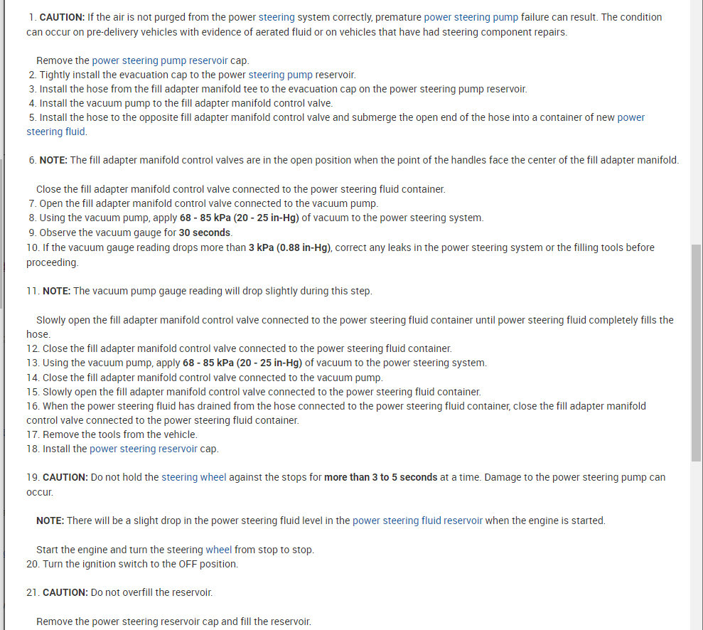

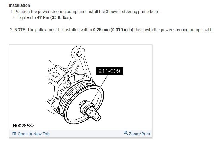

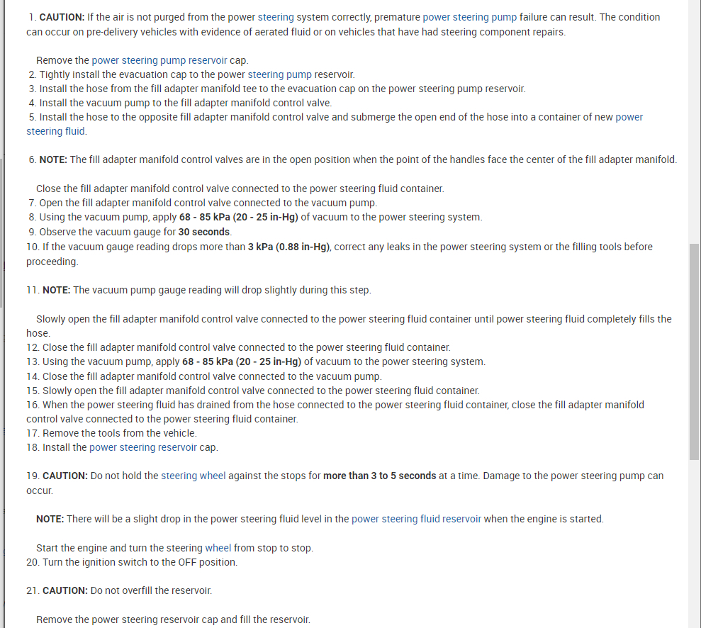

When replacing the power steering pump, how many bottles of fluid will I need, and do you need a press machine or tool to press the pulley on?
Sep 21, 2021 at 9:21 PM
Experienced Mechanic
52,796 POSTS
Good morning,
You need a puller to remove the pulley. You can buy or rent one at a parts store for this procedure.
https://www.2carpros.com/articles/remove-reinstall-power-steering-pulley
I attached the procedure for you below for the pump removal and the pulley removal.
https://www.2carpros.com/articles/how-to-replace-a-power-steering-pump
Make sure you flush the system of all the old fluid.
https://www.2carpros.com/articles/power-steering-fluid-flush
I included the process to fill the system as well. There is not a specific amount of fluid because it depends if you get all of the old fluid out, however, it normally works out to about 2 quarts.
