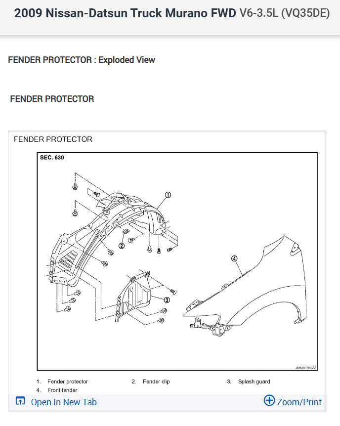

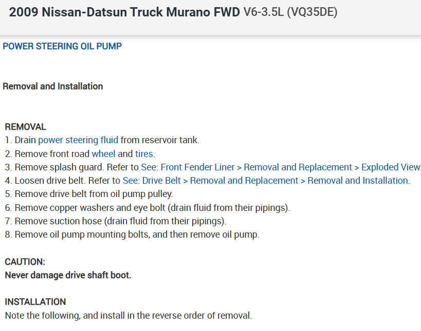

Took three days to remove it but now I can’t get the new power steering pump back in. Any tips or tricks? I have tried coming is from the left and right. I can get it to go up and not sure how to even start. Day two of trying to get it back in. Any suggestions would be appreciated.

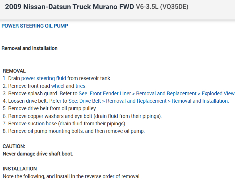

Yep, you need to remove the inner fender liner on the driver's side. Here is how and the instructions for the steering pump replacement as well. Check out the images (below). Please let us know what happens.
