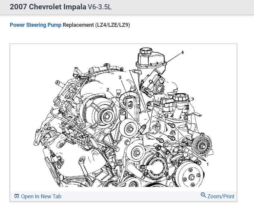

I notice yesterday that there was a leak coming from under my car so I checked under the hood and saw fluid dripping down the serpentine belt area. also my power steering was low on fluid when I topped it off in the morning . The following day I turn my car off and on to check the power steering level, I opened the reservoir cap to find my fluid leaking out from the top, bubbling and the fluid was a light brown color. The pump is also making a whining noise . Before hand I have already replaced my torn rack and pinion one month ago.

Sounds like you are on the right track. The whining noise indicates a bad pump. If the sound gets really loud when you crank the steering wheel as far as it can turn (in either direction), that is a big indicator that the pump is bad.

Power steering fluid was also coming through the top of the reservoir where the cap was sealed closed. Does that mean I have to replace the pump along with the reservoir?
Mar 5, 2019 at 3:38 AM
  • 55,224 POSTS

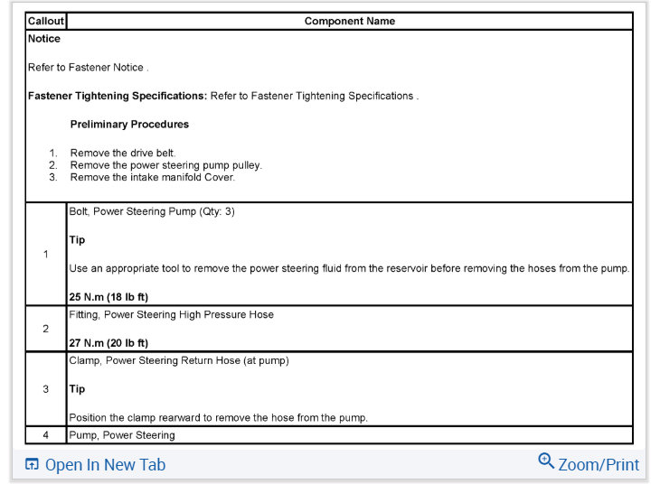

Yes, this is because the pump is sucking in air causing the fluid to overflow. here is a guide to help walk you through the repair with instructions and diagrams below to show you how on your car:
