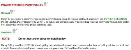

I have the power steering pump and was wondering if i need any special tools to get the pulley off or if i can do the change of a new power steering pump with general tools? I was just wondering if there was any specific tools that i needed to get before i started to tear it apart?
Apr 28, 2018 at 8:11 AM (Merged)
HMAC300
  • 48,601 POSTS
Yes, you need a pulley remover and installer. See if auto parts rent it.

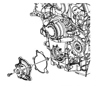

Welcome to 2carpros and TY for the donation Notes Water Pump Replacement (RPO's LZE/LZ4/LZ9) Removal Procedure
https://images.2carpros.com/forum/automotive_pictures/12900_w1_5.jpg
Drain the cooling system. Refer to Draining and Filling Cooling System (LS4 Static Fill) Draining and Filling Cooling System (LZE, LZ4, LZ9 Static Fill) Draining and Filling Cooling System (9C1, 9C3 Static Fill) Draining and Filling Cooling System (LS4 GE 47716 Fill) Draining and Filling Cooling System (LZE, LZ4, LZ9, 9C1, 9C3 GE 4771 Fill). Loosen the water pump pulley bolts. Remove the drive belt. Remove the water pump pulley bolts and pulley.
https://images.2carpros.com/forum/automotive_pictures/12900_w2_4.jpg
Remove the water pump bolts. Remove the water pump and gasket. Clean the water pump mating surfaces. Installation Procedure
https://images.2carpros.com/forum/automotive_pictures/12900_w3_3.jpg
Position a NEW water pump gasket and the water pump to the engine front cover. Notice: Refer to Fastener Notice. Install the water pump bolts. Tighten the bolts to 10 Nm (89 inch lbs.) .
https://images.2carpros.com/forum/automotive_pictures/12900_w4_2.jpg
Install the water pump pulley and bolts. Install the drive belt. Tighten the water pump pulley bolts. Tighten the bolts to 25 Nm (18 ft. lbs.) . Fill the cooling system. Refer to Draining and Filling Cooling System (LS4 Static Fill) Draining and Filling Cooling System (LZE, LZ4, LZ9 Static Fill) Draining and Filling Cooling System (9C1, 9C3 Static Fill) Draining and Filling Cooling System (LS4 GE 47716 Fill) Draining and Filling Cooling System (LZE, LZ4, LZ9, 9C1, 9C3 GE 4771 Fill). Inspect for leaks.

MDYKES3948
Six cylinder two wheel drive automatic 69,000 miles.
I have remove belt and the three bolts and lines. Pump is loose but will not come out. Do I have to take more off the motor?

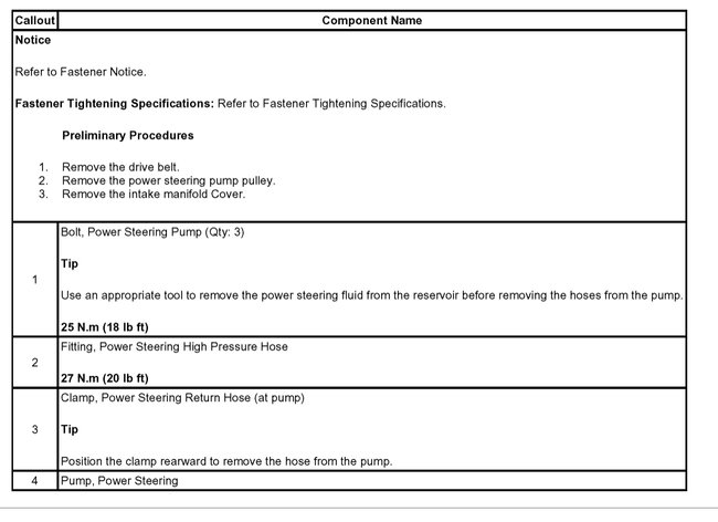

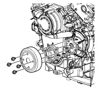

FACTORYJACK
  • 4,159 POSTS
It looks like in either V6 configuration, it calls for pump pulley removal as one of the initial steps in removal. It does not say why, and the illustration is not detailed enough to show any reason. Removal of the pulley requires a special tool, a power steering pump pulley removal tool. It may be available at a rental store, or a parts store that rents tools. I would imagine it is a fairly common tool requested.
MDYKES3948
There is no room to put a puller.
FACTORYJACK
  • 4,159 POSTS
What type of puller are you using? a power steering pulley puller is not very large.

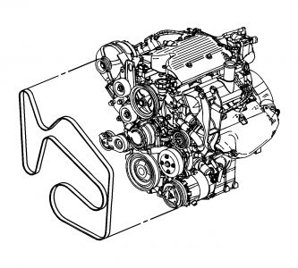

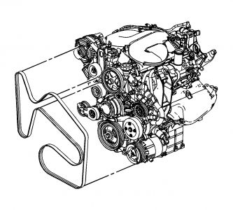

MDYKES3948
Thanks for your help last night. I got it replaced but need belt diagram. can you help?
FACTORYJACK
  • 4,159 POSTS
I have two illustrations, they are for the two V6 options. It looks like the belt routing is the same in both, I believe the illustration only differs with the engine picture. The first is the 3.5, and the 3.9 is the following.
https://images.2carpros.com/forum/automotive_pictures/309872_1607918_1.jpg
https://images.2carpros.com/forum/automotive_pictures/309872_1614089_1.jpg

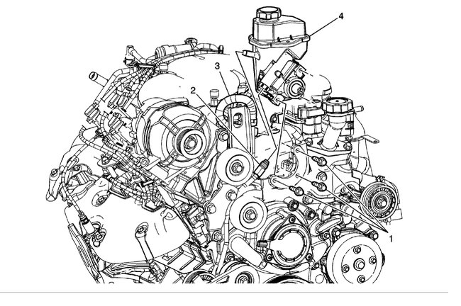

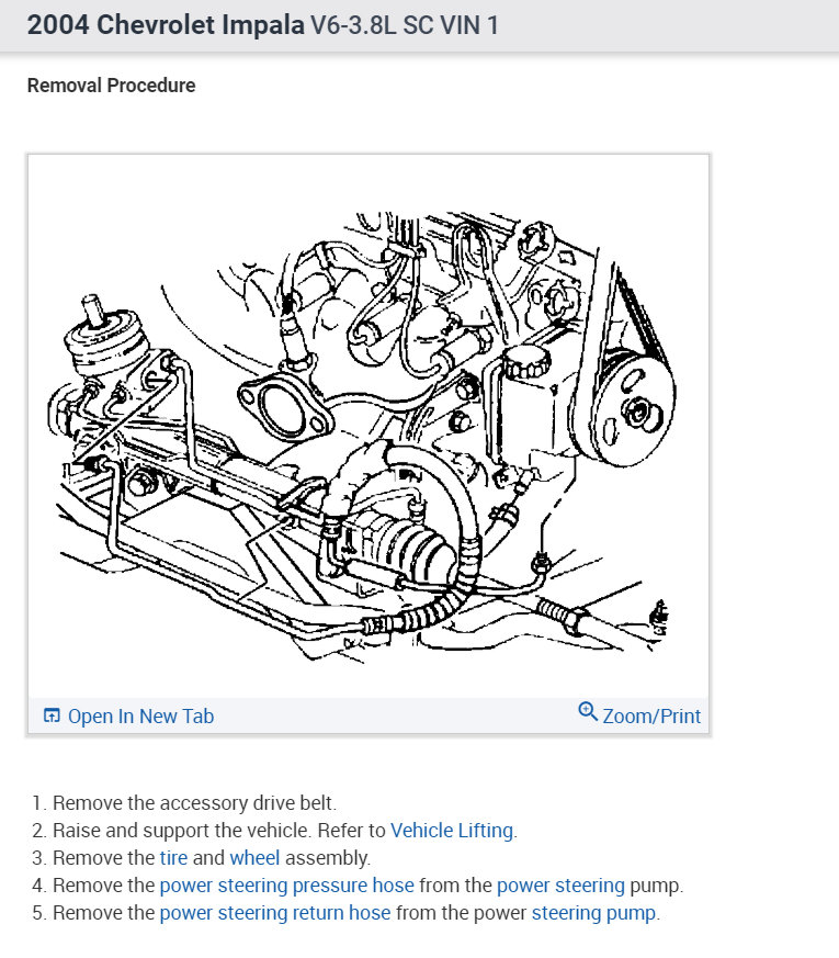

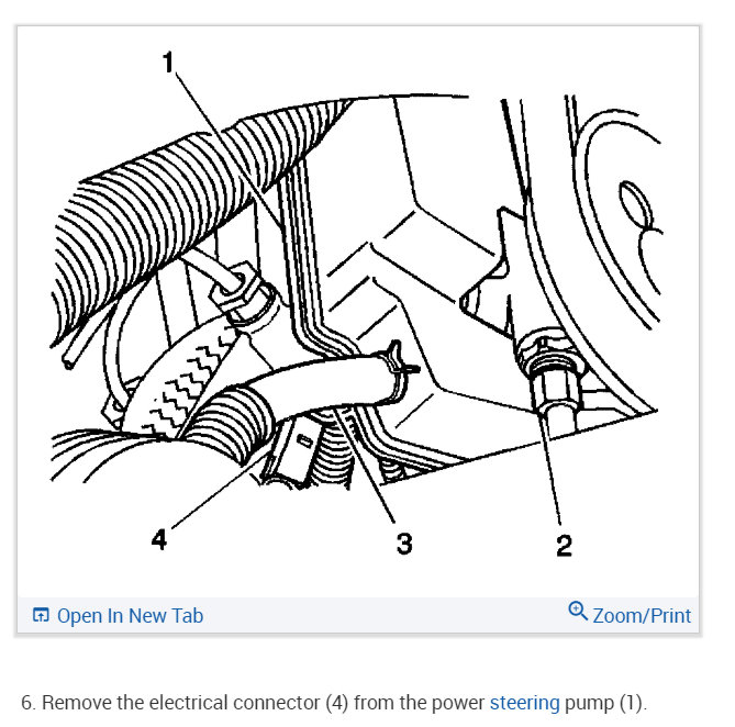

  • 55,381 POSTS
It sounds like you have a defective pump that is pulling in air which makes the fluid have air in it and the noise will never go away until you redo the pump. May I suggest an AC Delco pump.
Here is a guide to show you what you are in for when doing the job:
https://www.2carpros.com/articles/how-to-replace-a-power-steering-pump
and you should flush the system.
https://www.2carpros.com/articles/power-steering-fluid-flush
Here are some diagrams that shows how it will be on your car (below).

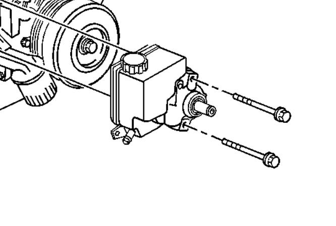

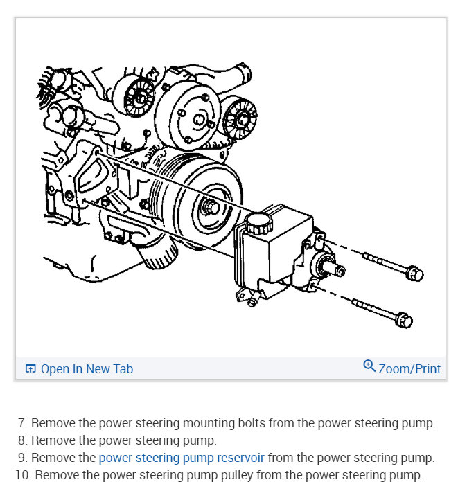

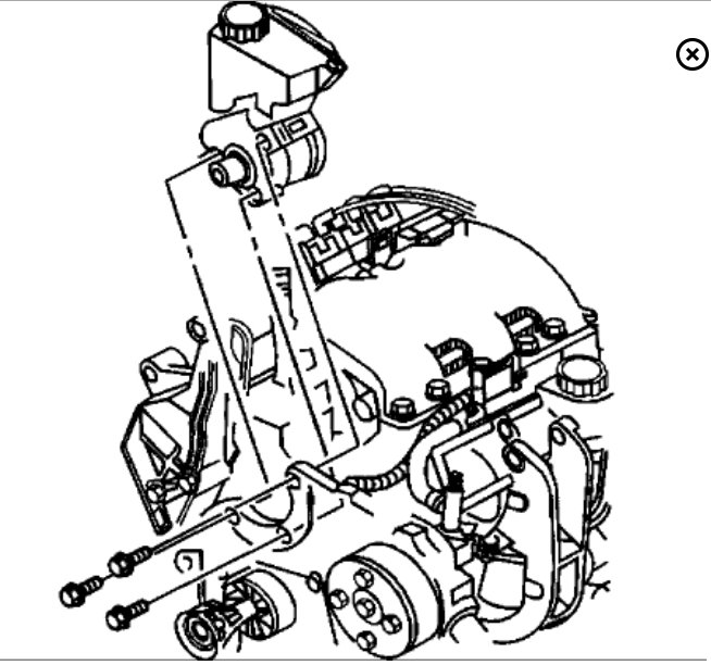

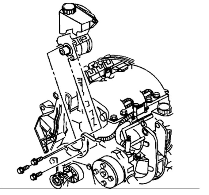

BLUELIGHTNIN6
  • 16,542 POSTS
https://images.2carpros.com/forum/automotive_pictures/261618_Noname_2734.jpg
https://images.2carpros.com/forum/automotive_pictures/261618_Noname2_889.jpg
Feb 13, 2019 at 2:57 AM (Merged)

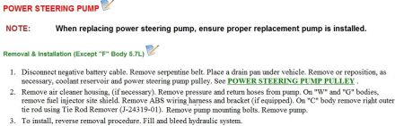

DENNYP
  • 1,824 POSTS
remove the belt, remove the two hoses from the pump, remove the bolts that hold the pump to the engine, remove the pump.

PUGGLAS
If its the same as my 2003, it is well hidden. Look below the alternator near the firewall. Its a "feel for it" thing if you can wriggle your hands down there.
  • 55,381 POSTS
Hey SANDERSMKRL,
The pump is located on top under the fluid reservoir. First remove the serpentine belt and then the mounting bolts here are a couple of guides and a diagram that will help.
and
Please let us know happens so it will help others.
Best, Ken
