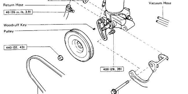

Trying to find out how to remove power steering pulley. Pulley must be removed before pump will come out. Conventional pulley remover will not work, there is no lip on the pulley to hook it to.

These are not pressed on pulleys. Once you remove the nut holding it, it should come off. You may need to use a small hammer to move it but it should come right off.
