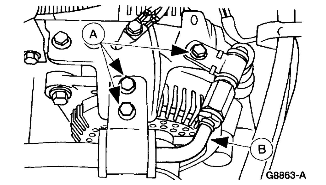

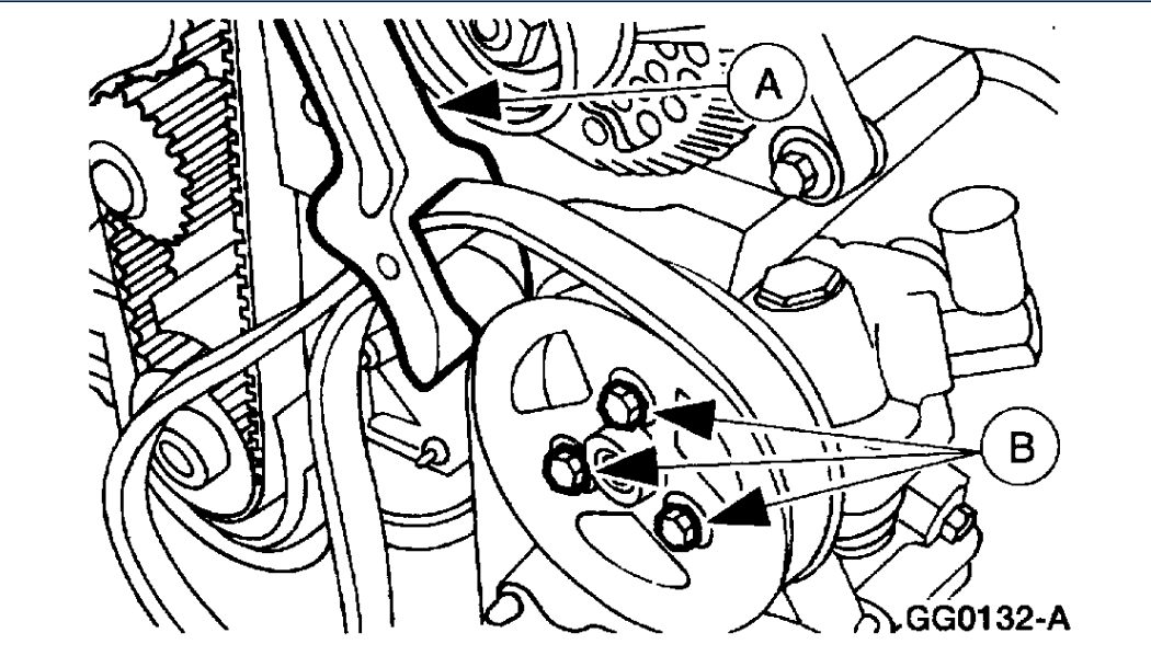

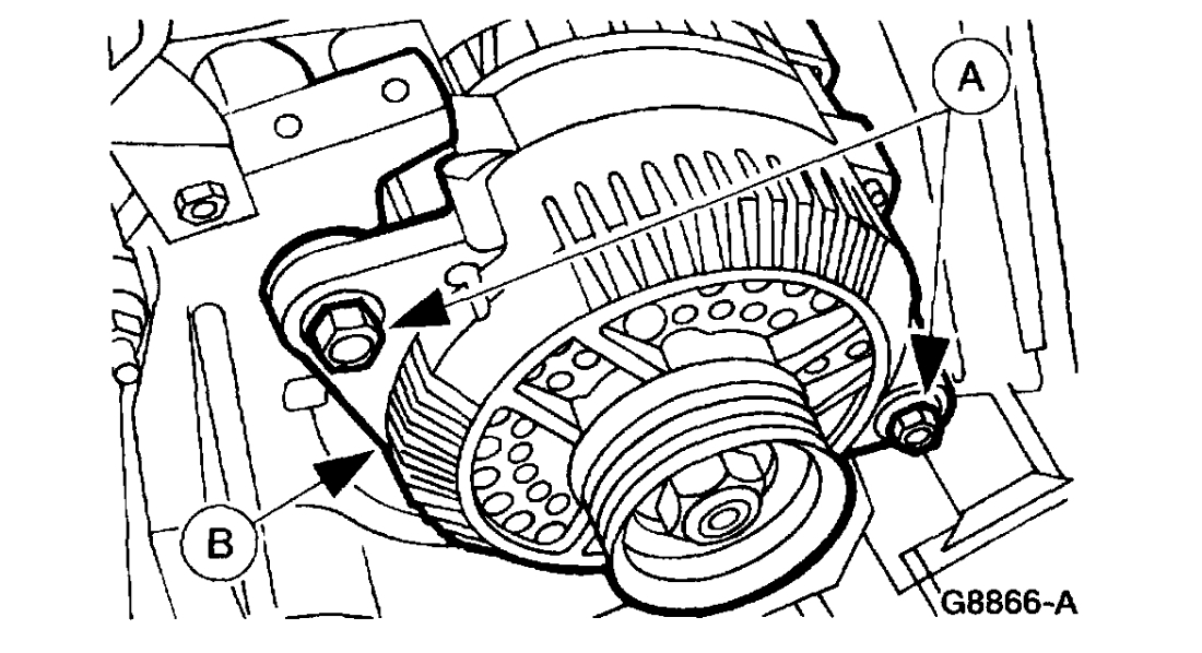

The power steering pulley fell off and that has not happened before. I want to replace it but need some instructions on what tools to use and how to reinstall a new one.

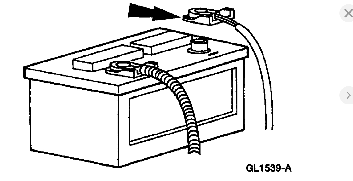

1. Disconnect the battery ground cable.

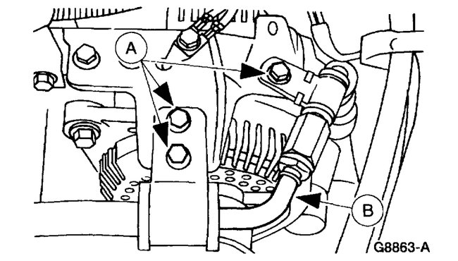

3. Remove the (A) bolts and position the (B) power steering pressure hose aside.
imageZoom/Print

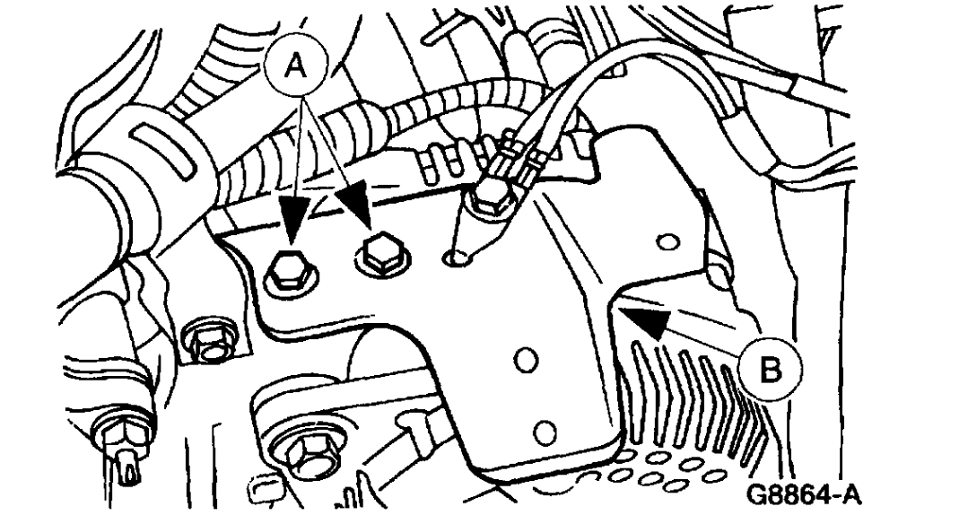

4. Remove the (A) bolts and position the (B) power steering pressure hose support bracket aside.
imageZoom/Print

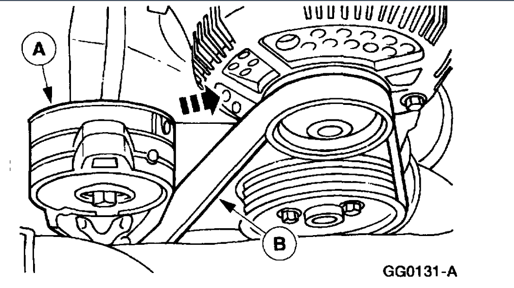

5. Rotate the (A) drive belt tensioner to release the tension and remove the (B) drive belt.

6. Remove the (A) generator bolts and position the (B) generator (GEN) aside.
imageZoom/Print

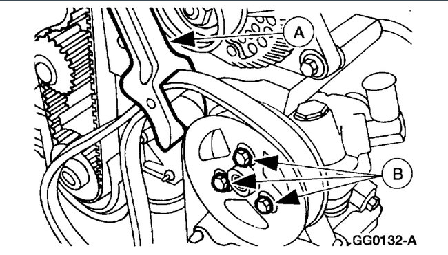

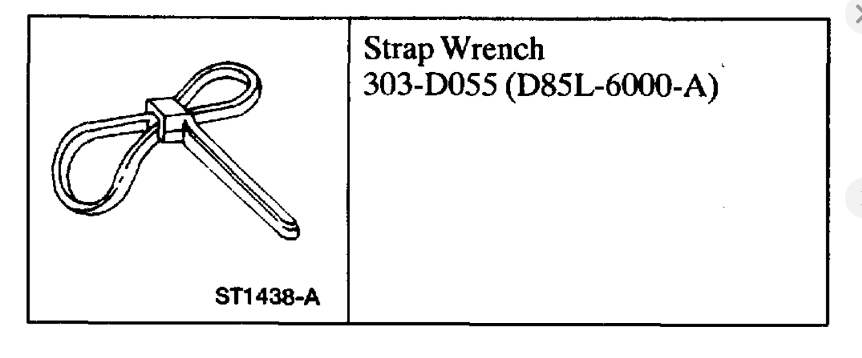

7. Use (A) Strap Wrench to remove the (B) pulley bolts.
8. Remove the power steering pump pulley.
