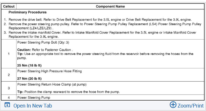

Car has lost nearly all power steering. The fluid is foaming up. When I took off the reservoir cap, it literally popped from pressure. I have already drained and flushed the system and added new fluid and no change.
Dec 4, 2024 at 2:24 PM
  • 55,562 POSTS

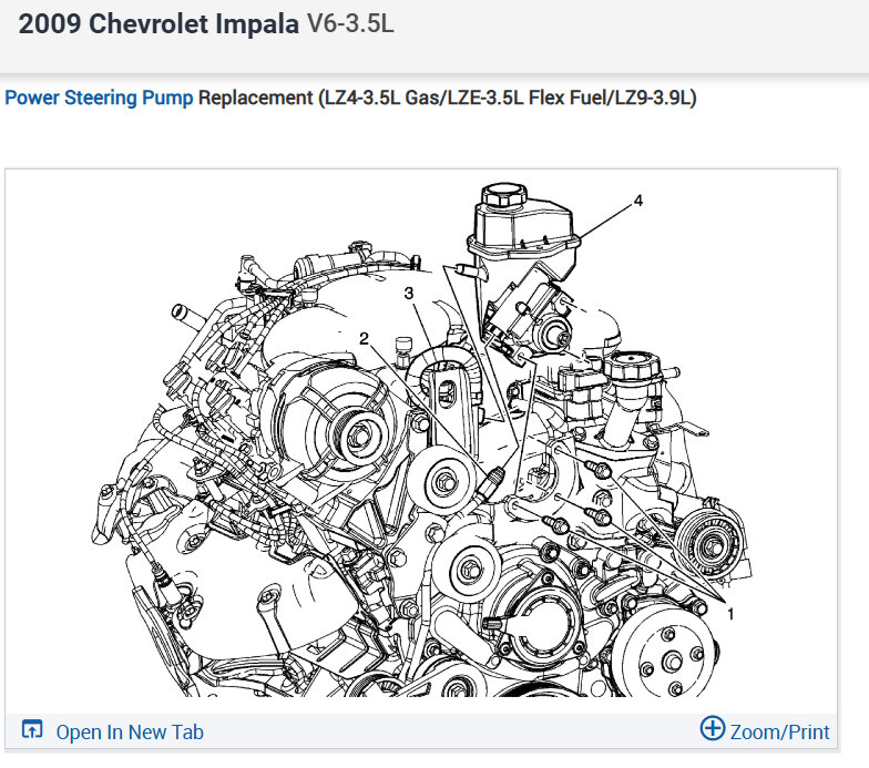

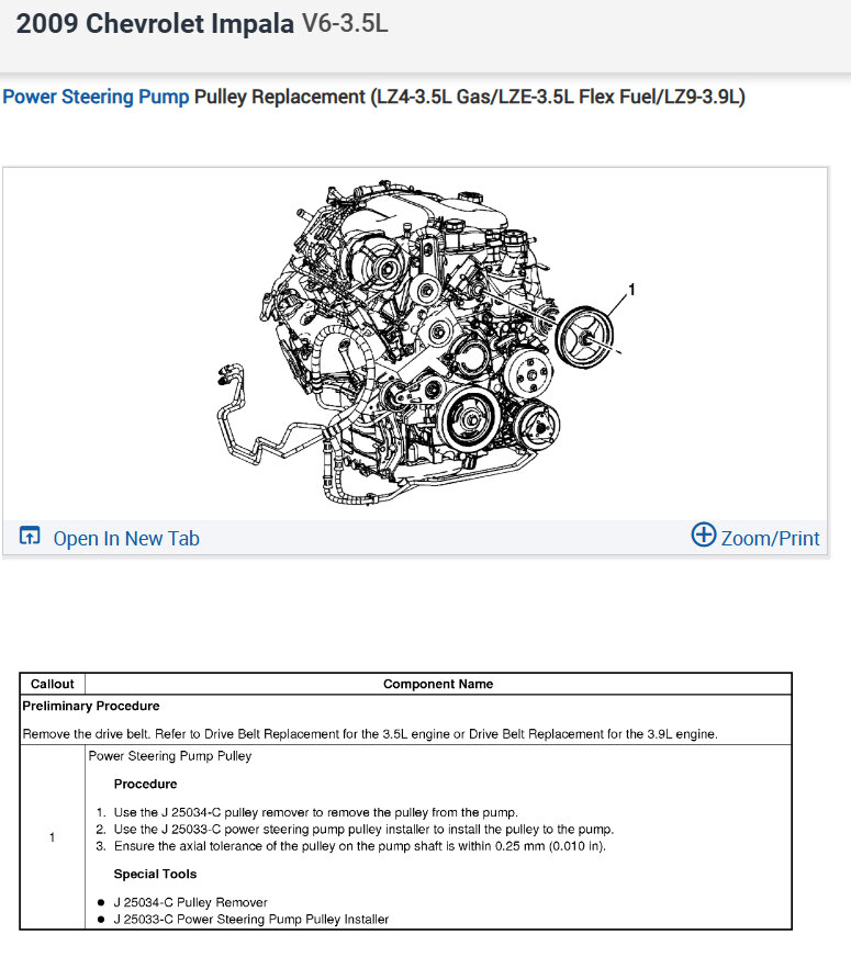

The reason the fluid is taking in air. Is the front pump seal is bad. I would replace the pump with a new or rebuilt unit. here is how to remove the pulley so the pump can be replaced:
https://www.youtube.com/watch?v=MtHG4y_rdMI
Check out the images (below). Let us know if you need anything else.
