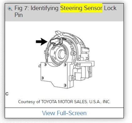

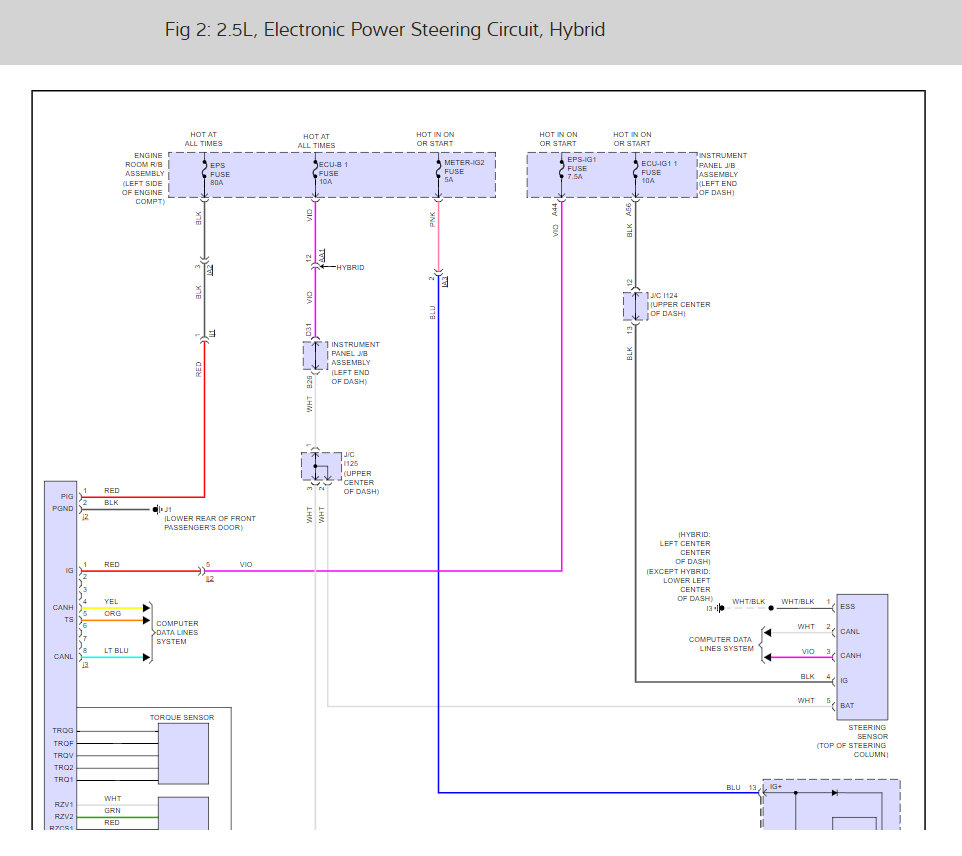

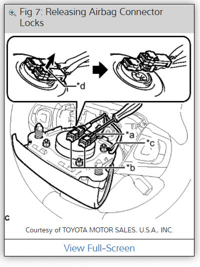

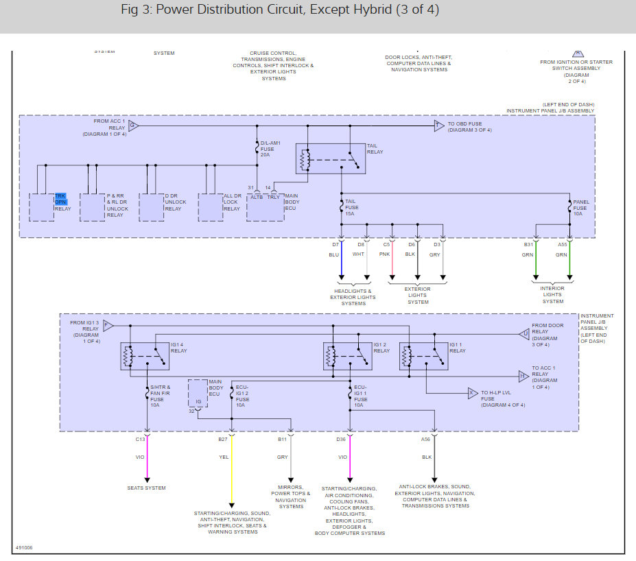

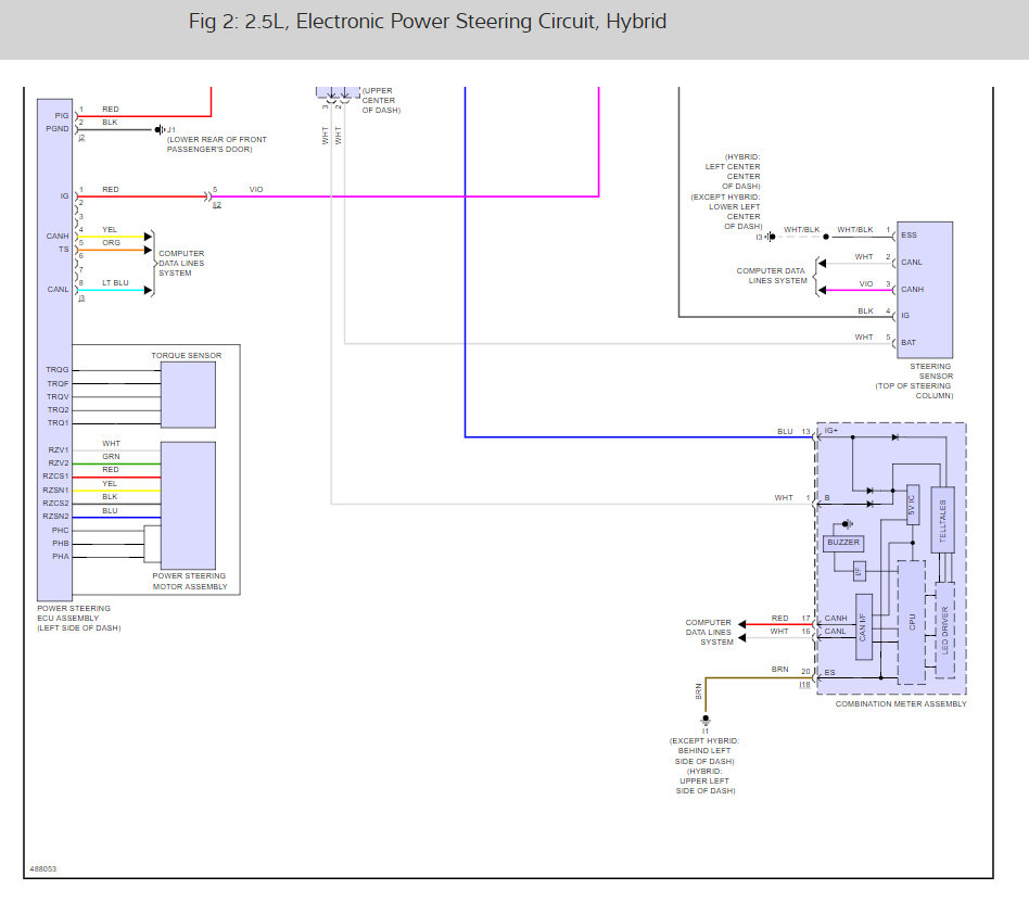

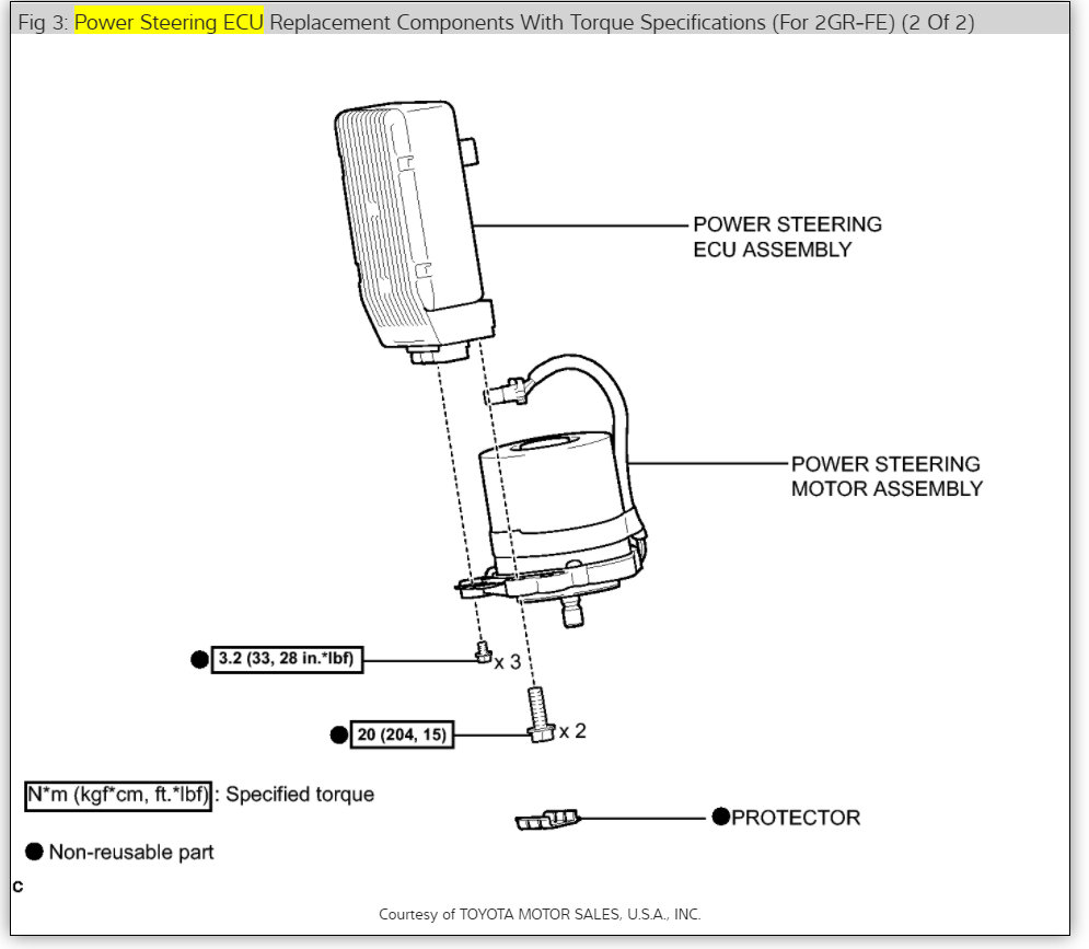

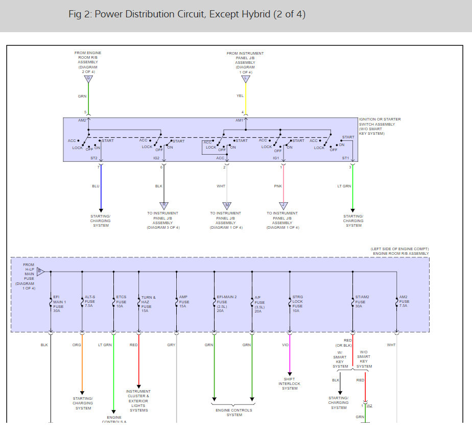

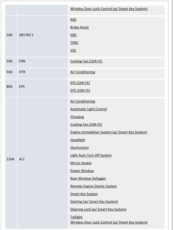

I bought a salvage the car listed above it is the XSE model. It was damaged in front right wheel. When I received it the steering will turn over right side by itself when car was started. When I was driving also steering wheel was turning right side. Then I calibrated it and now power steering is not working. There are written "check electric power steering system" and found out DTC codes C1515 and C1517. Can you help me how to fix it?
Dec 5, 2017 at 11:13 PM
  • 55,433 POSTS

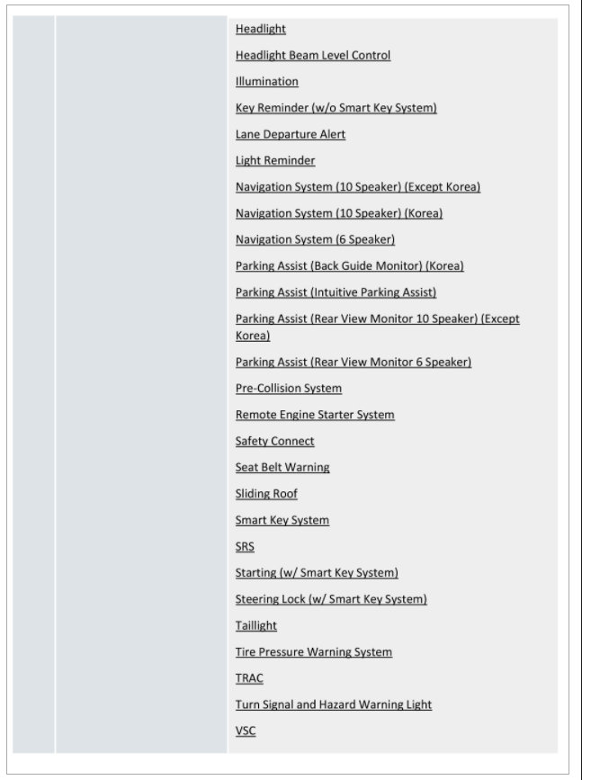

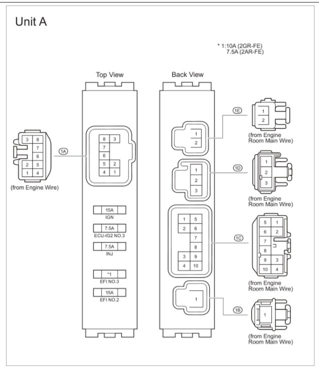

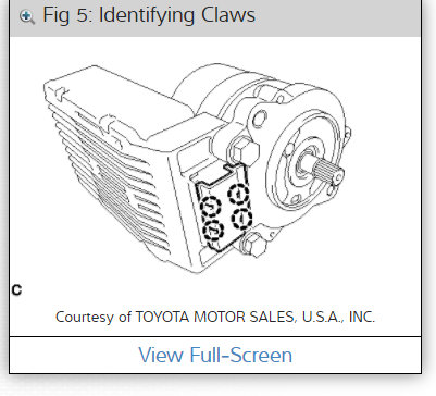

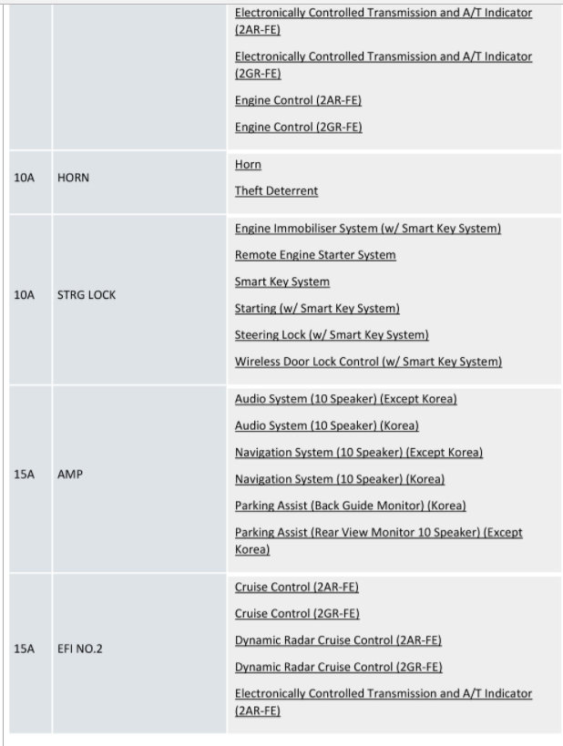

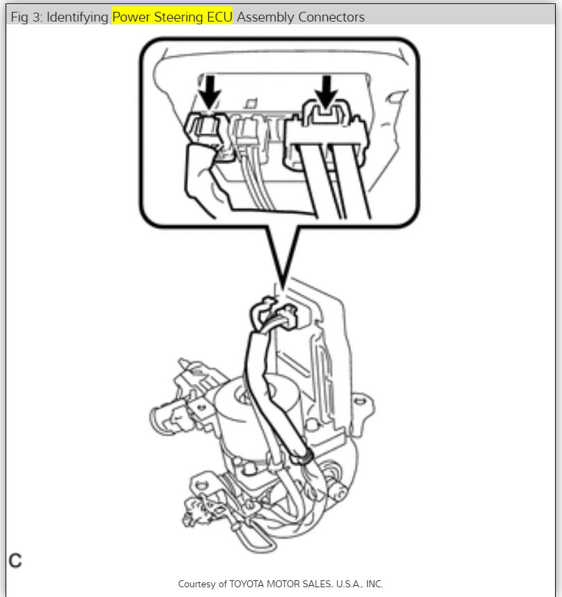

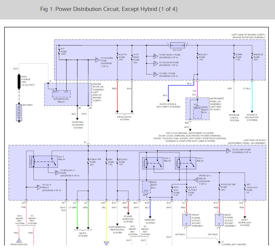

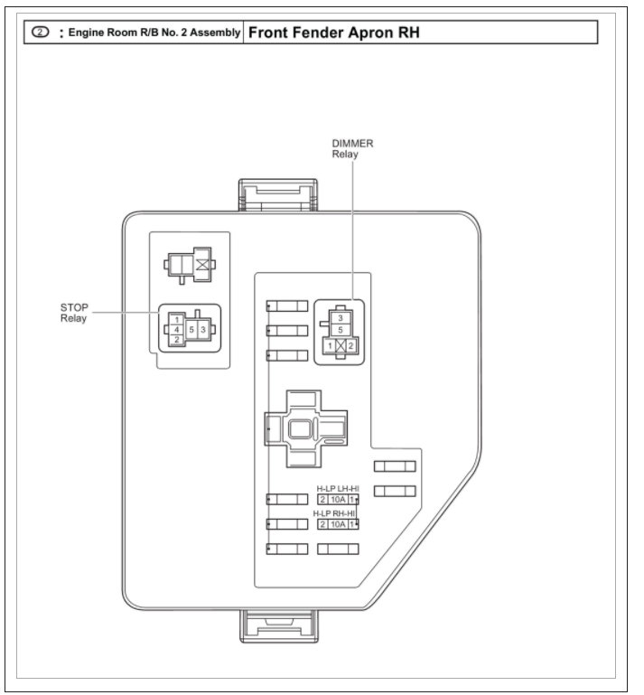

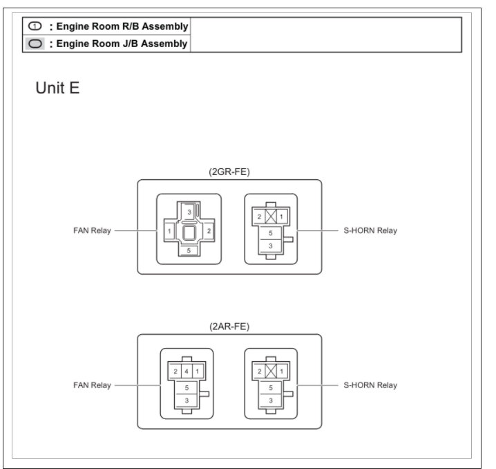

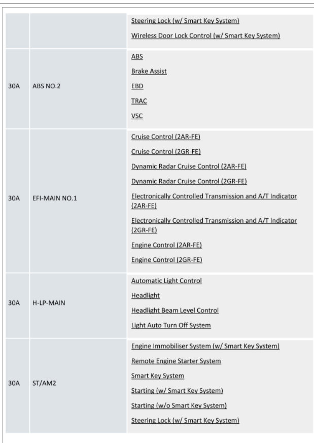

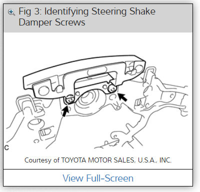

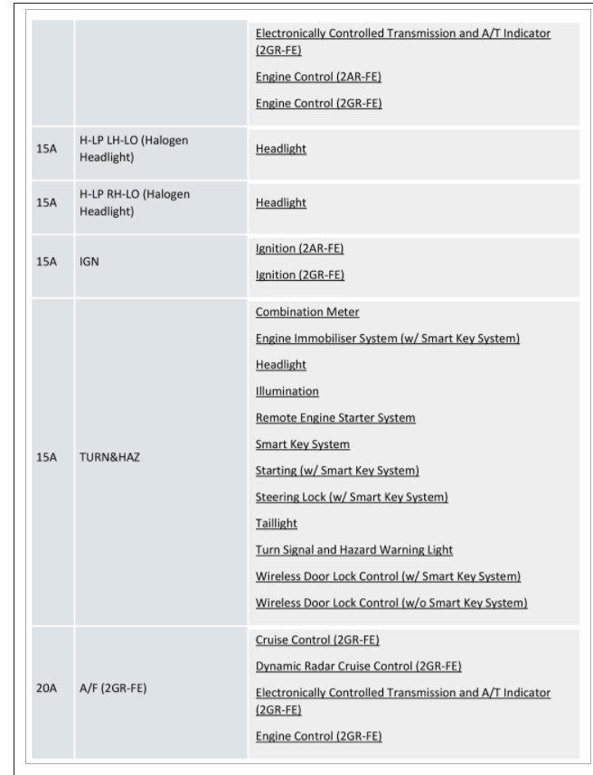

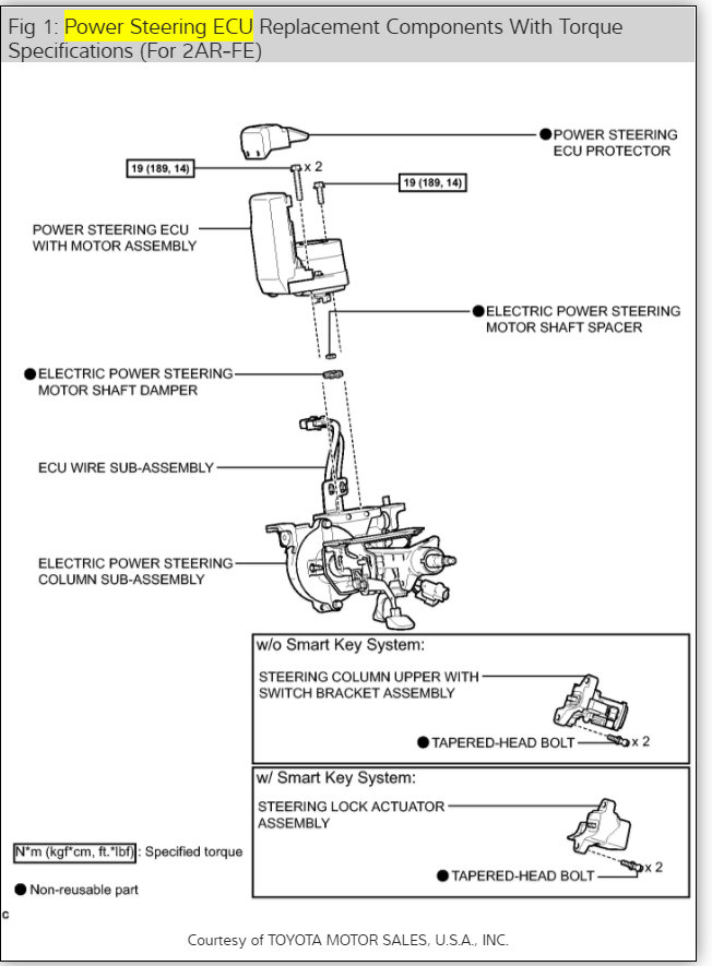

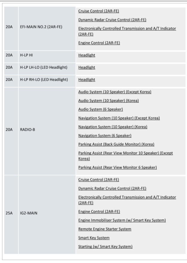

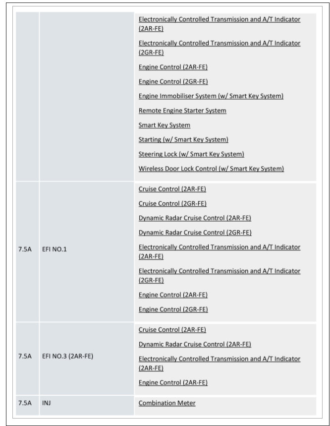

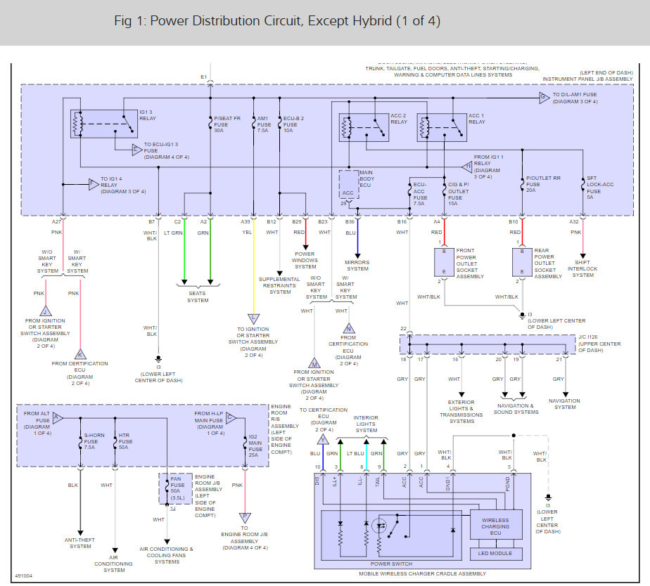

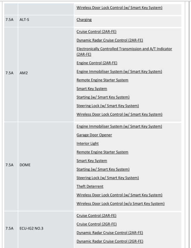

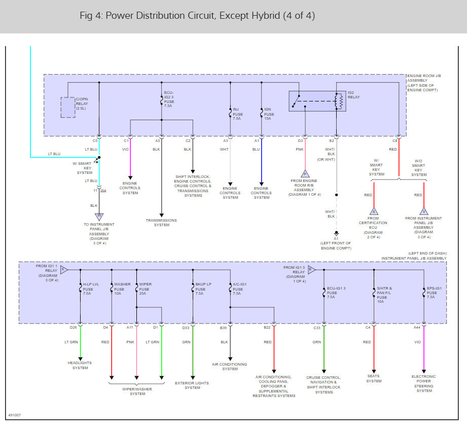

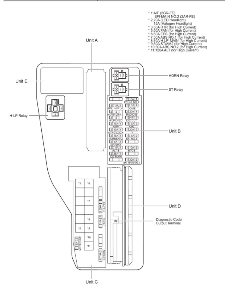

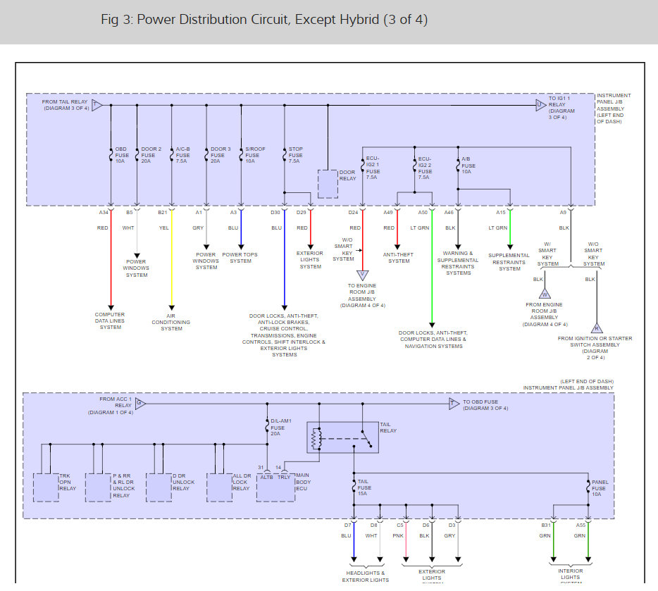

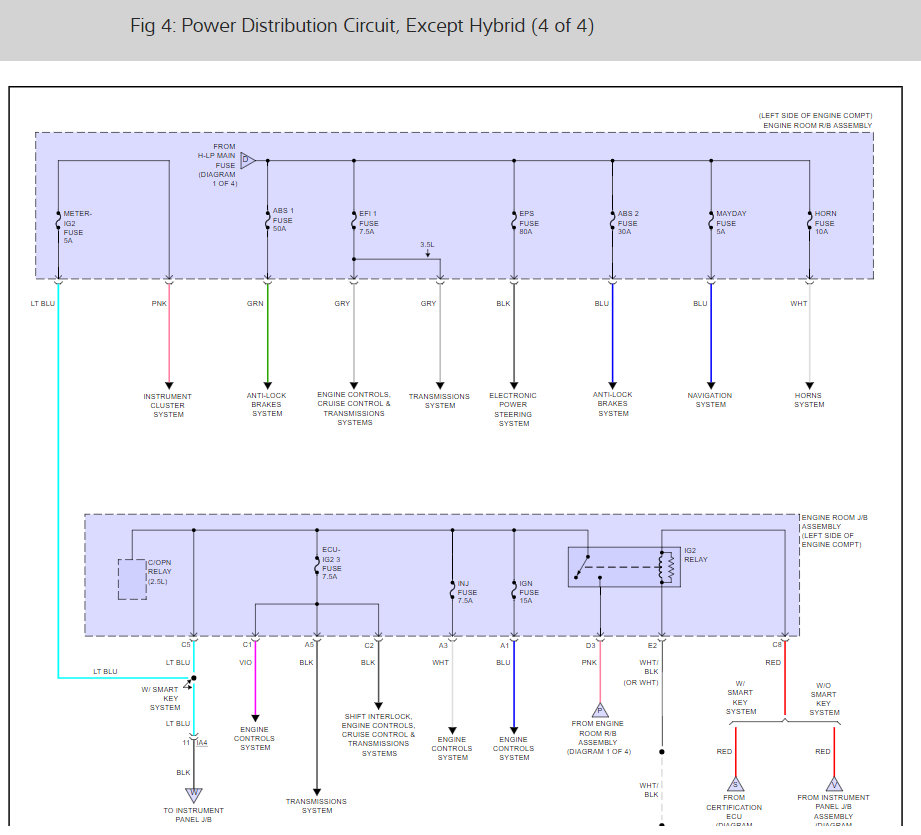

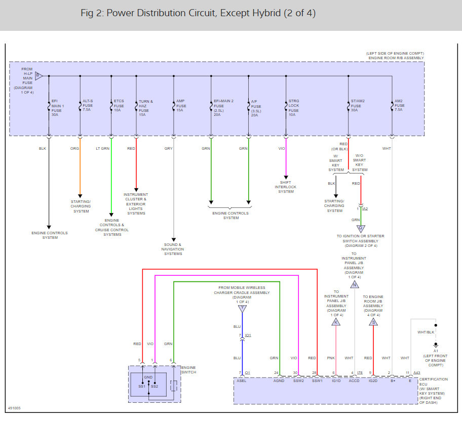

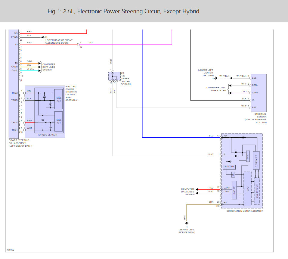

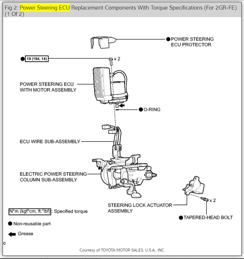

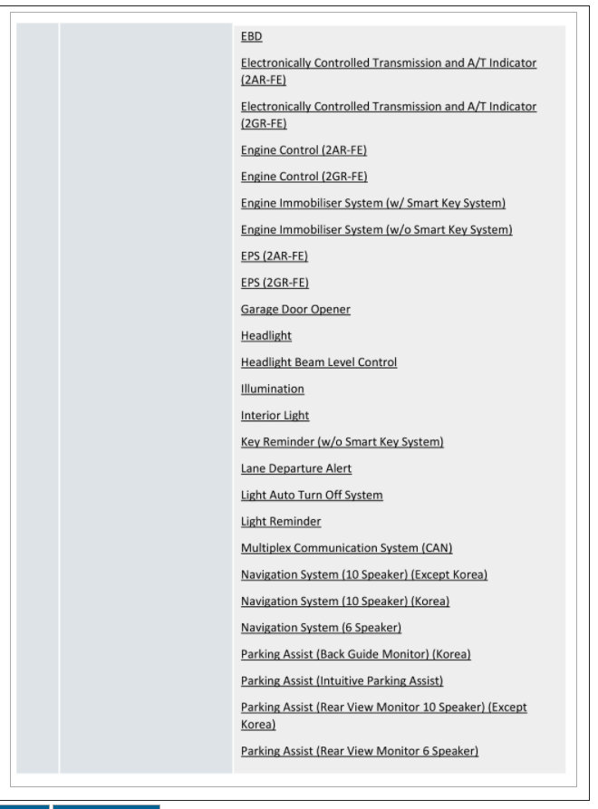

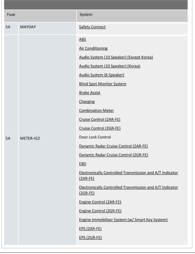

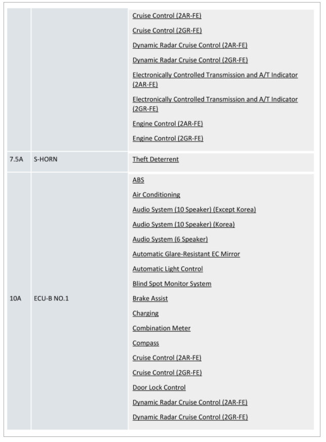

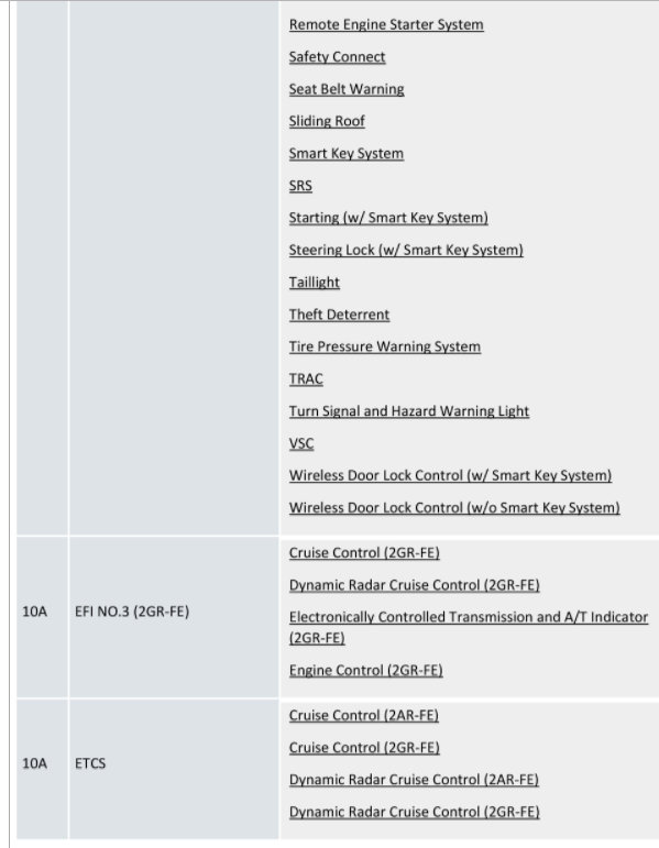

It sounds like one of two things has happened. Either you have a fuse that is out becasue there are 5 that run the system or the steering wheel sensor is not working right. Here are some wiring diagrams for the electric power steering system EPS and a couple guides to help us get started testing (easy).
and

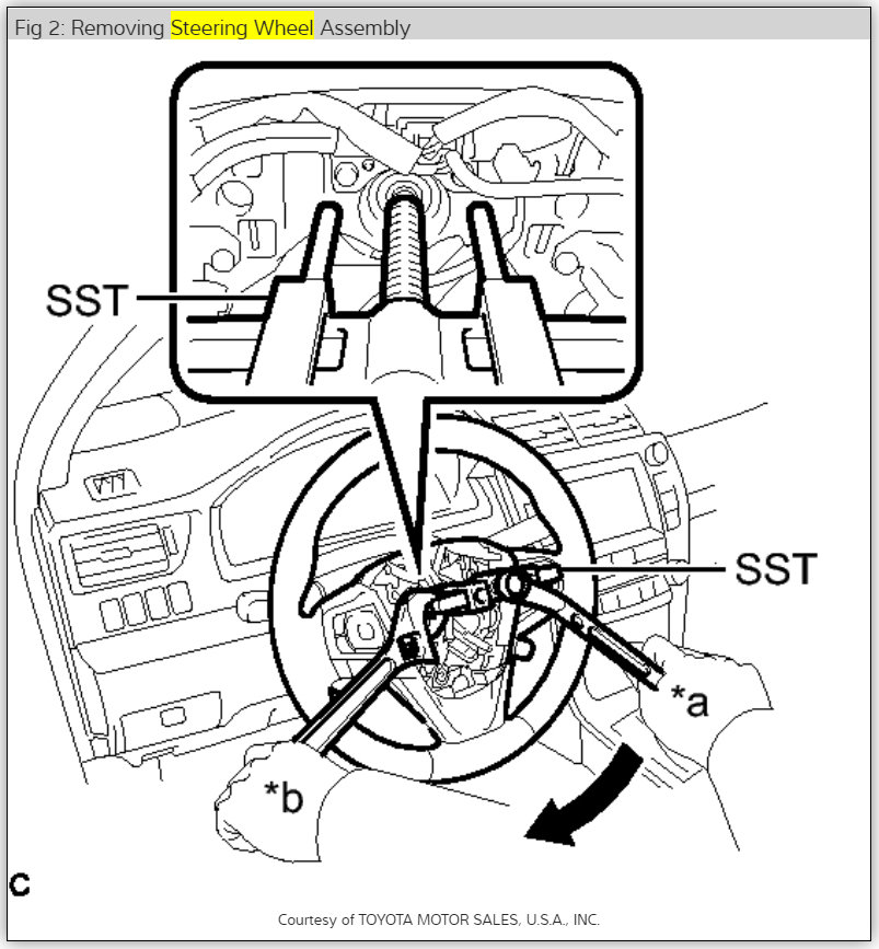

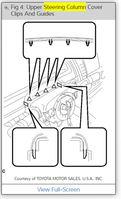

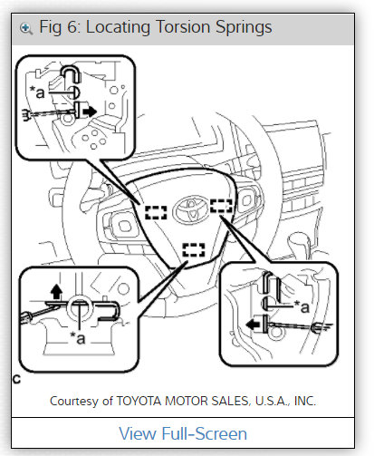

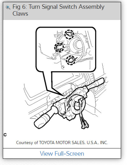

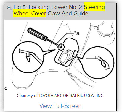

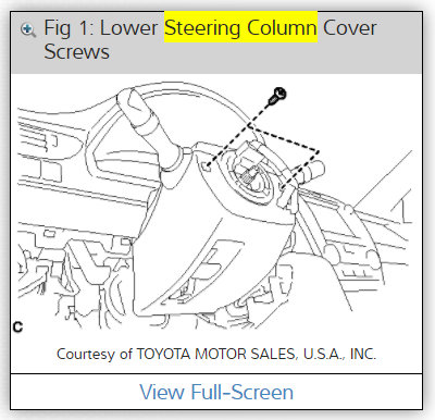

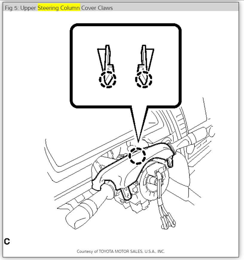

You will need to remove the driver's side airbag this guide will give you a generic version of that with. We have specific diagrams of your car (below)
https://www.2carpros.com/articles/air-bag-removal-steering-wheel

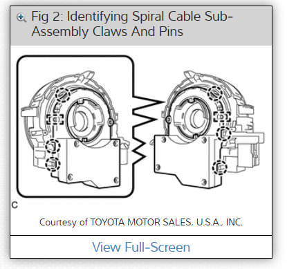

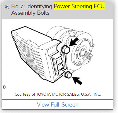

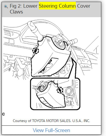

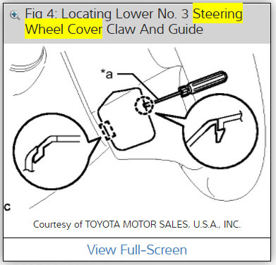

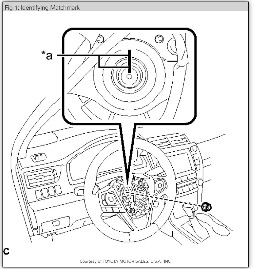

Next would be the turning wheel position sensor. Here is a guide to ehlp you see what you are in for when taking off the steering wheel. (yours will need a puller)
https://www.2carpros.com/articles/steering-wheel-removal

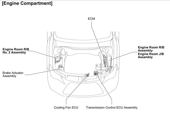

These diagrams below show the entire system so others can see how it works. Also I have fuse panel diagrams at the end.
